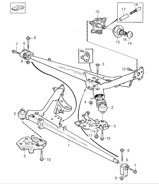

Photo time:
I'm guessing I need that number 6... think that'll do the trick?
I'll be happy as long as you say I don't need the entire arm. Just from a diagram standpoint it doesn't look too terrible to replace. Kinda slides in there.

Yeah...
2 #6's and you might as well do the outer link bushings (#2) as well if you're going to be beating up on this thing like that.
There is a euro supplier that has a mono-ball/spherical bearing replacement set-up for those outer link bushings. Might be a good/more durable option. HERE

The OEM outers are softly-bushed for NVH and allow some manner of passive rear steer.
I wouldn't trust them to hold up for rally-cross usage. (Unless you really like changing them a lot)
The inners (like your broken one) are OK with OEM.
THESE are the replacement outers. (Just under $500 USD)
