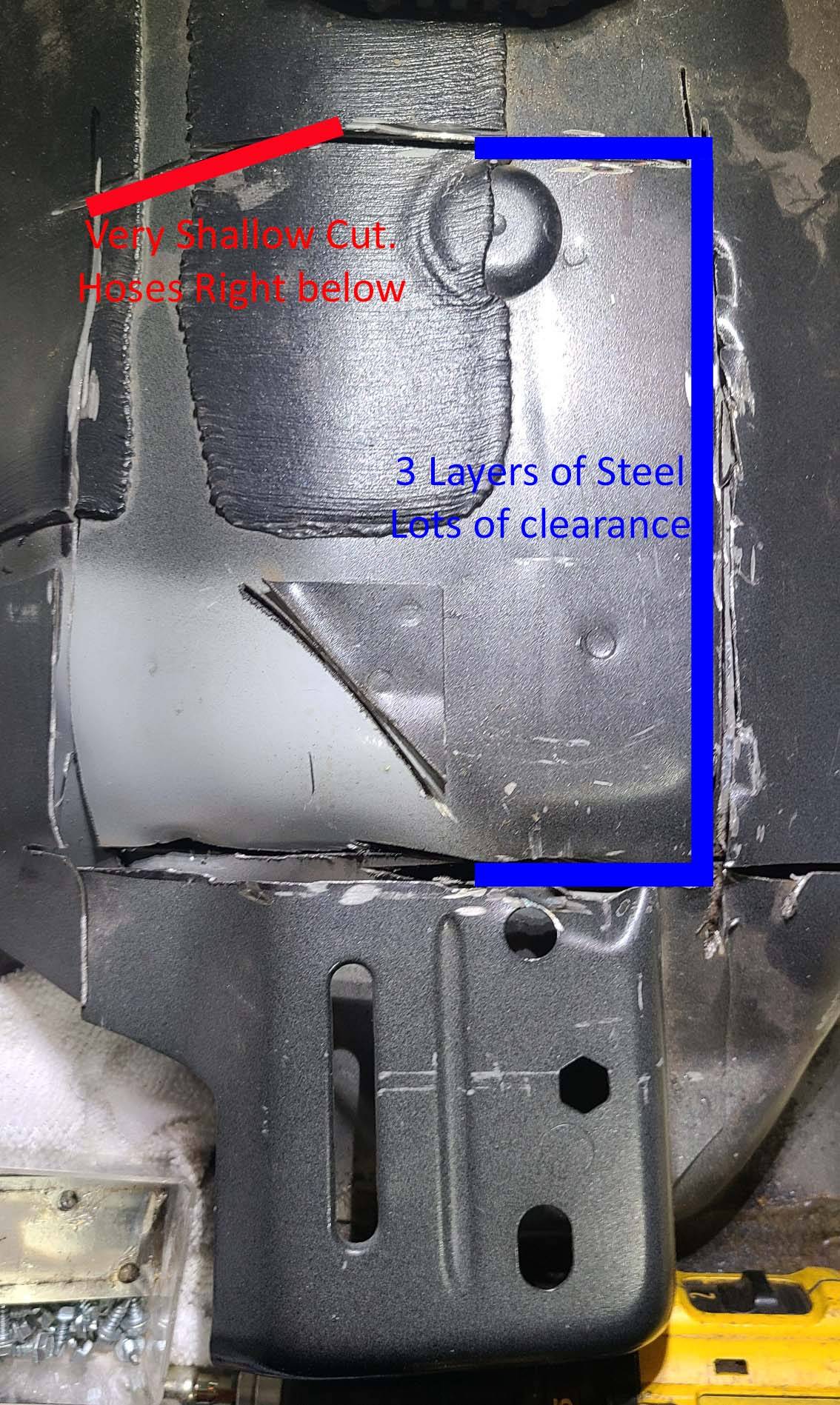

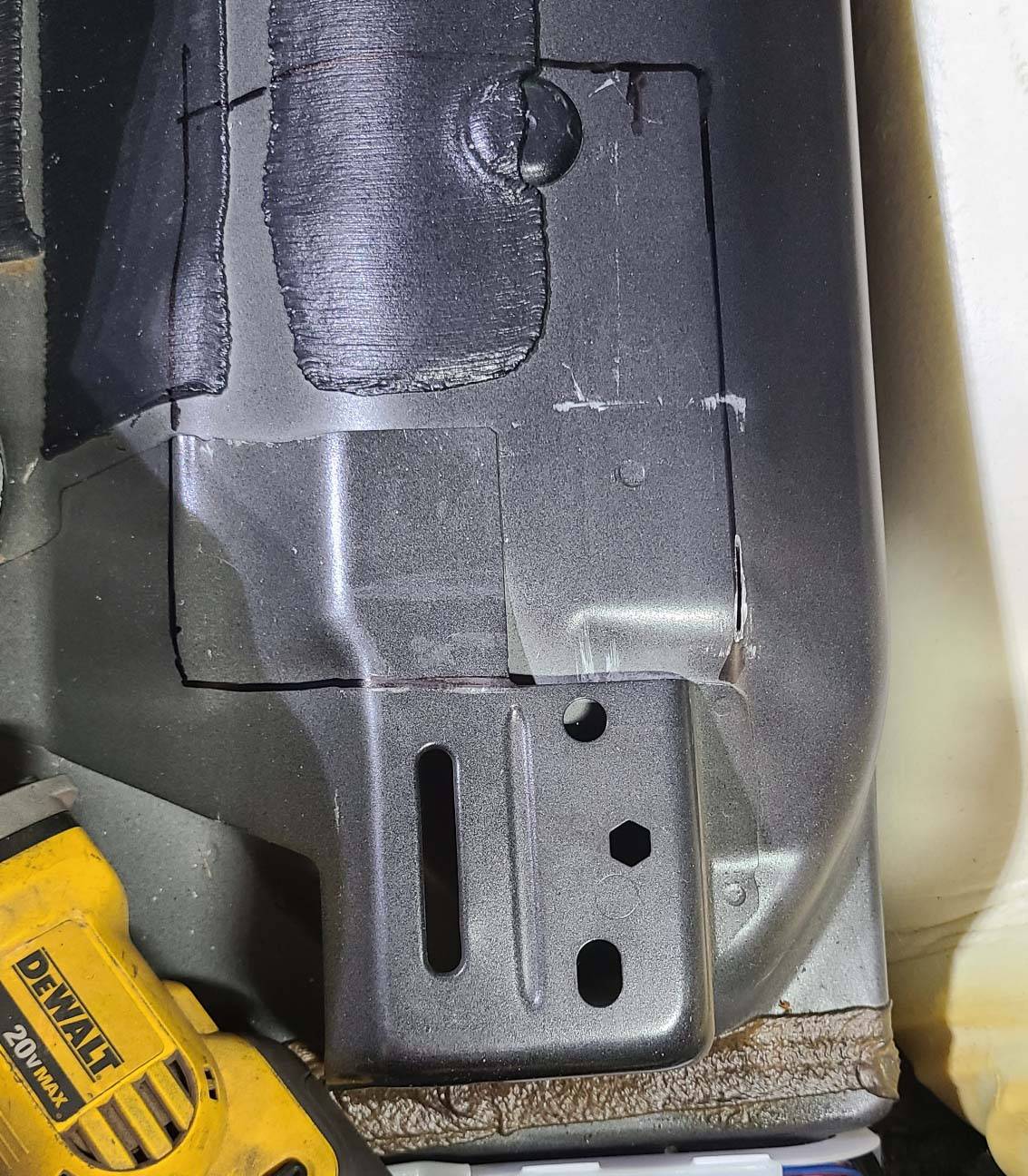

3) Use a sharpie to trace out the approx. lines below. Its not critical, but with this as a guide you should be able to get close.
4) Using a cutoff disk in an angle grinder, cut the lines as marked. Be careful in the Red area as there are lines directly under the floor, make a very shallow cut. In the Blue area, there are 3 layers of metal to cut through and requires a deep cut. However, there is lots of clearance here, so don't worry to much about cutting to deep.

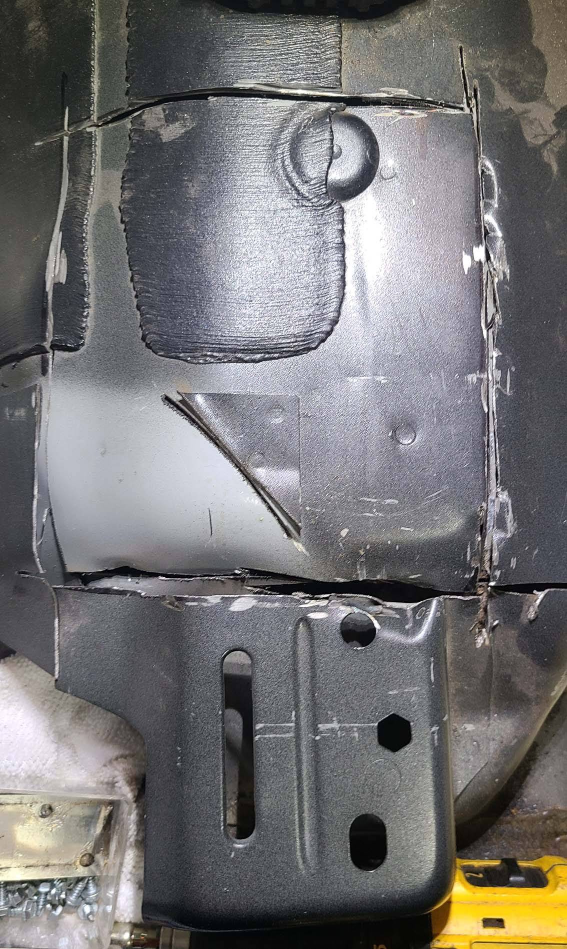

5) Here is what it looks like with the cuts completed.
