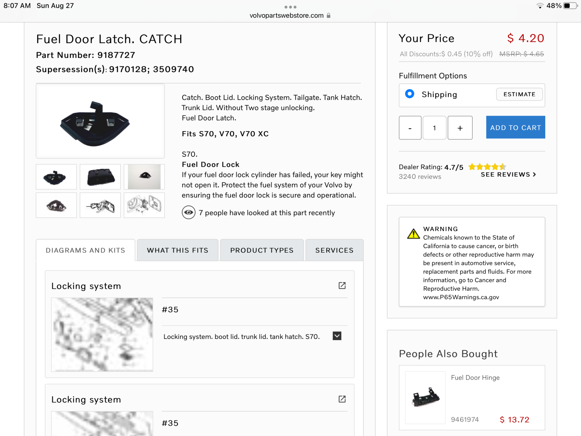

I did have a replacement latch for one of those "just in case" moments! After the next fill-up I'll insert the latch.
