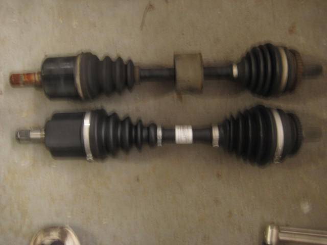

Also, here's a pic of the drivers side. Despite configuration differences, the overall lengths are close, but I think the hub shaft is shorter on the new one.

GKN is what you want and probably the best. I find that length difference alarming and concerning. Do you still have the old ones? I think that length difference to be problematic. Check your order application and make sure you got the right shaft for your car.

That sounds like a reasonable theory. I don't have the old one.
Sourcing this part was a saga. FCP sent it to me, when I pulled the original I was alarmed because it was so much longer than the new one. So I called and they went through a deep dive, and came back and said the part was wrong and they could not locate the correct one. So I returned the part, not knowing what to do, because no one had the part number FCP now told me was correct.
And then I realized that when I pulled the original axle I had sprung the CV joint under its boot. When I placed it back correctly, the part was now several inches shorter than before.
So I was thinking I created a fuss for no good reason. Meanwhile I contacted CarID and they recommended the same part that FCP had sold me. I went with it, and that's what's on there now.
If I had the original I probably would put it back on, at least as a test, but it's gone. I guess I should get under the car and see if the axle is still fully in the tranny.
