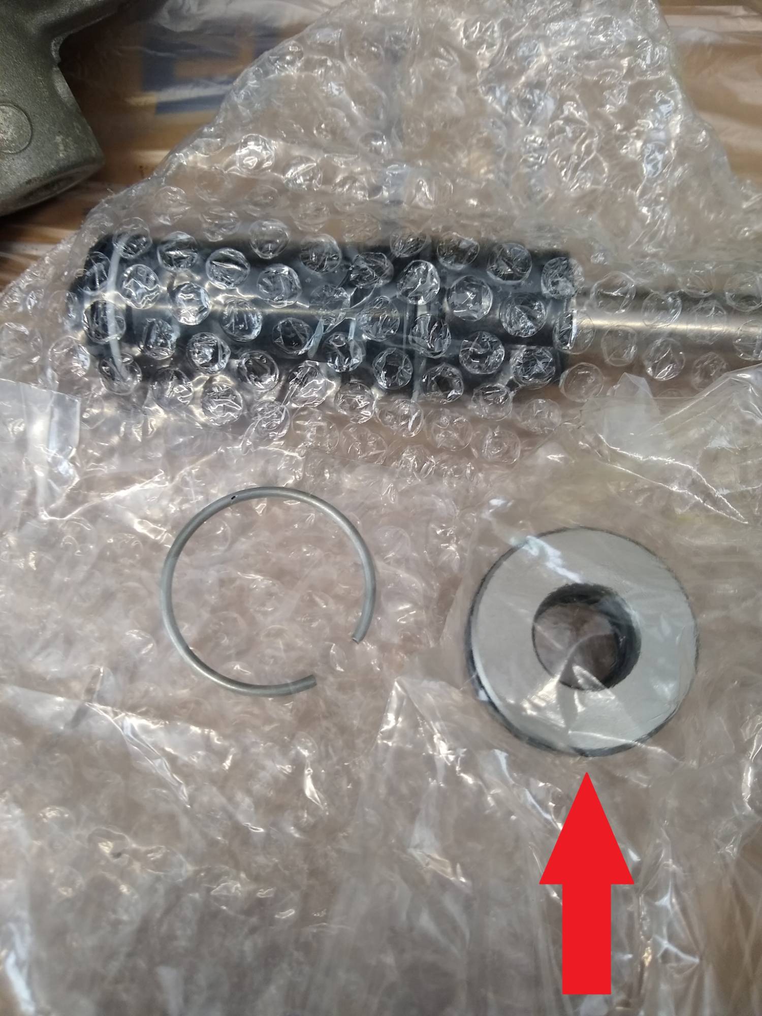

Here's the part in red I reversed in the kit so pay attention to details including your procedures and bench bleeding of the MC. It's a leak, air or seal. Hope it's not the pump even though there are no codes.
The cap has a wedged O-Ring. If installed properly it looking like it will spread when the piston is coming up. In reversed it pushes flatter so fluid was coming out at the bore.

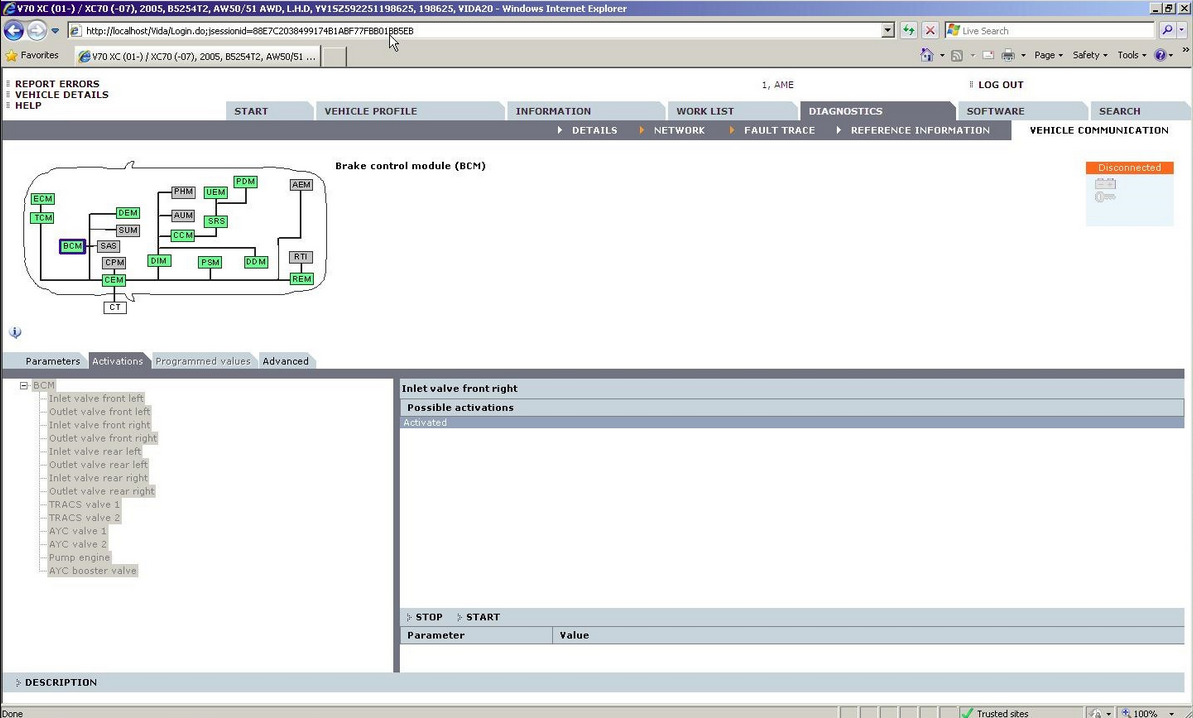

Hook up DiCE/VIDA, start bleeding a caliper (with a vacuum pistol type pump), trigger ABS inlet/outlet valves of that caliper. You'll see a large air bubble escaping eventually.

vtl wrote: 15 Oct 2023, 07:28 Hook up DiCE/VIDA, start bleeding a caliper (with a vacuum pistol type pump), trigger ABS inlet/outlet valves of that caliper. You'll see a large air bubble escaping eventually.
going to have to grab my laptop and look at that feature.
