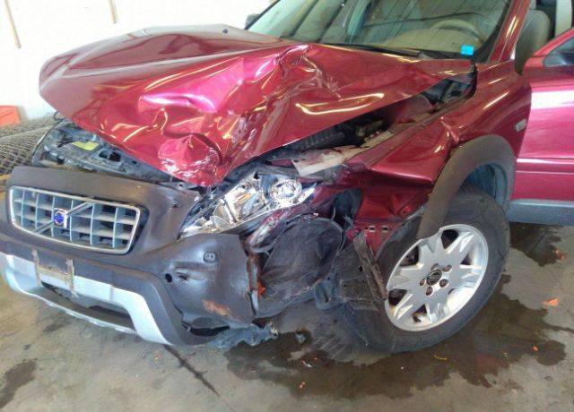

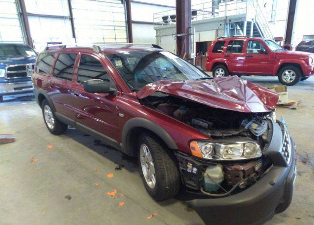

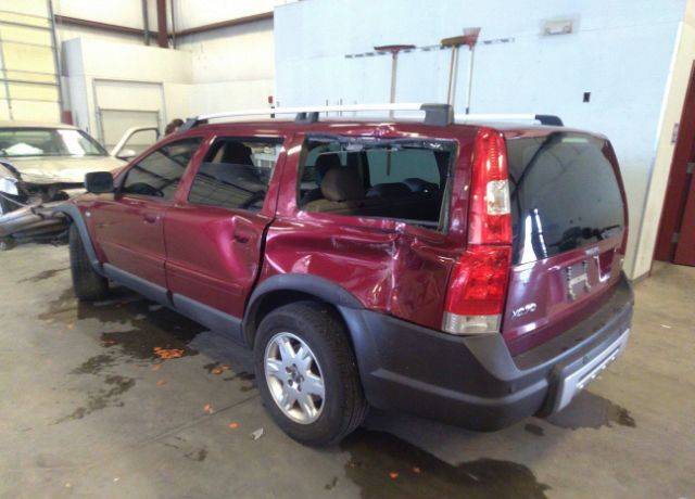

Well...life has gotten in the way of that project and the car has mostly sat for the last 18 months. It still runs, though, and I've now freed up some time to tackle the swap. Also, I have found a likely donor at our local pick-and-pull--a 2005 XC70 that was wrecked last August. Mileage per Carfax four months before the accident as 111,071 miles. It appears to be in very good overall condition aside from the severe body damage. See attached pics.

Any concerns with the front-end damage? The wreck doesn't appear to have damaged the engine, and airbags didn't deploy which makes me think the car may have been parked at time of impact. It also looks like the wheels were not hitso drive shafts appear straight.

That was a nice car! Looks like it got hit hard and spun into something at the LR.
So, is it inside on that nice slab out of the rain while you work? That would be a huge difference from out in the mud in the yard. Is there a time limit on how long you can work on it?
