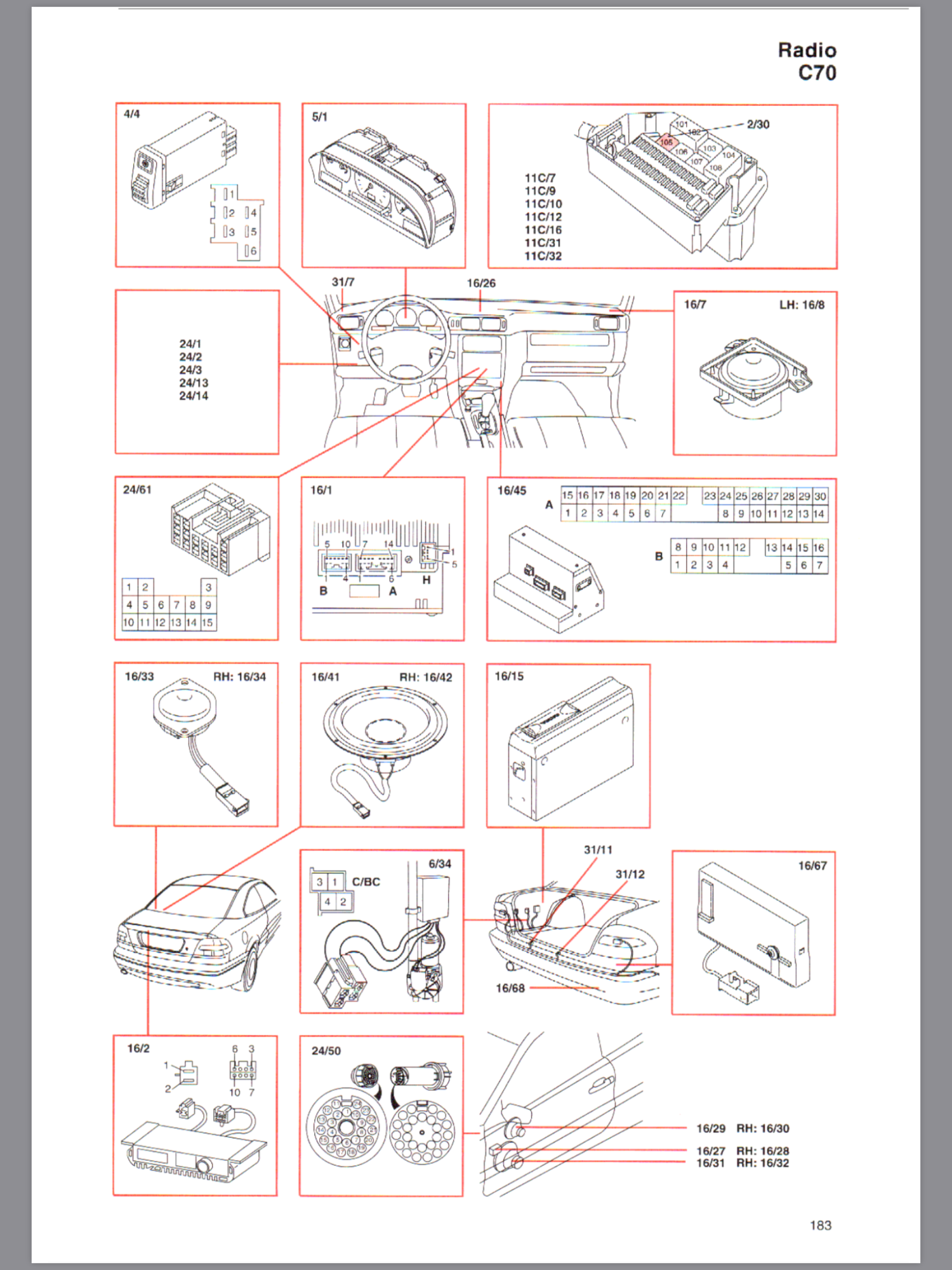

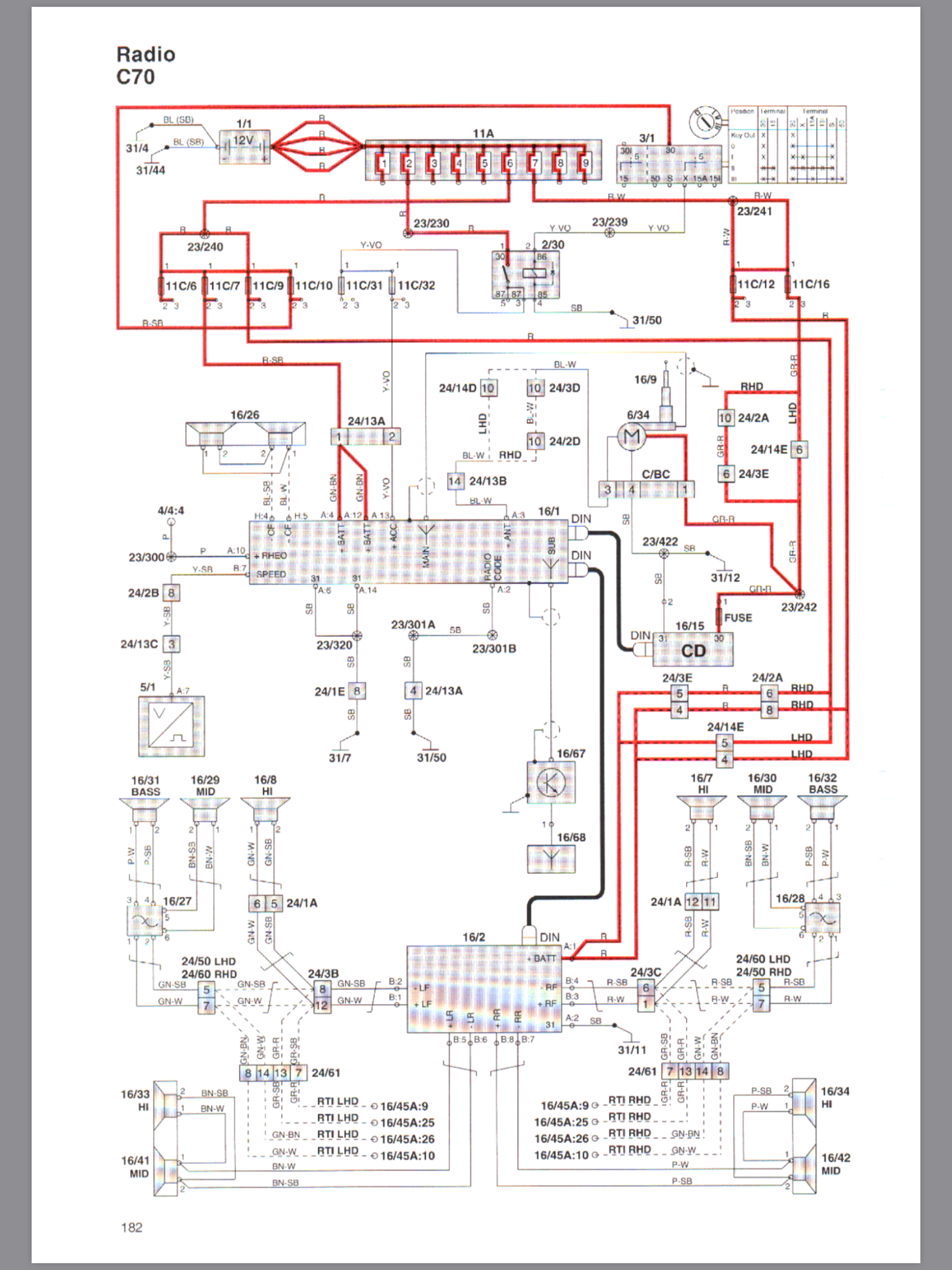

And some pages from the wiring diagrams:
THANKS! I LOVE the diagrams!! This is going to help me lots too! Ok folks...I'm going to have to DIG alot deeper now, flashlight too....see what I got going on here! I was going to go by this post in ebay(but not for the C70) so ??? where they showed some of the wire colors and where they go on the missing sq black plug that was butchered.. thinking I could solder back a correct plug that would go properly in OEM radio...but going to wait till I know exactly what is what here!
