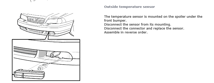

I tested the one at the bumper.

Is this the sensor you checked?
you can delete that VIN now if you want.
Vida's telling me its a 850 with a B5234T5 engine, the 850R has a B5234T4 engine tho.
