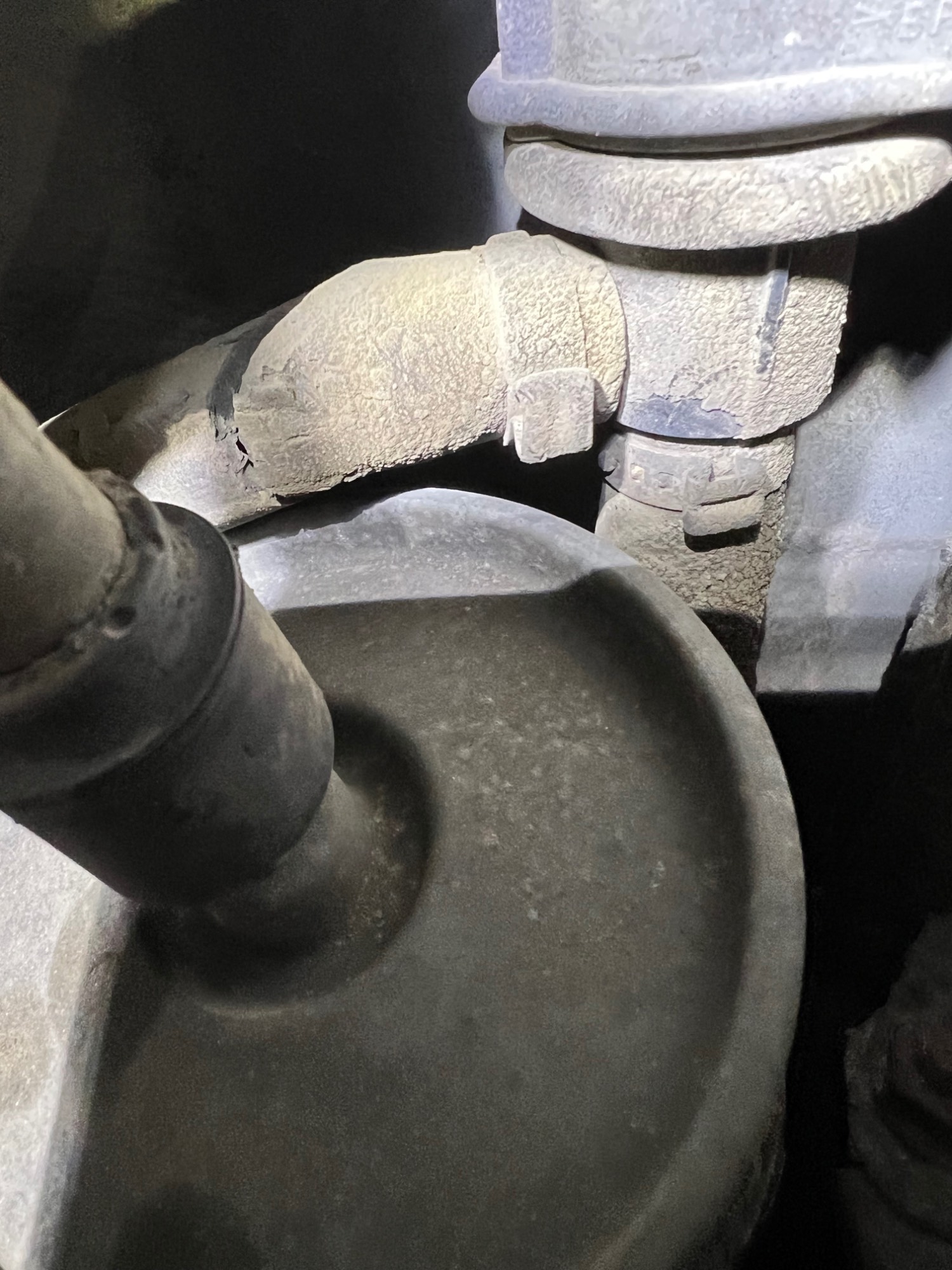

I identified the culprit of P0455...It appears to be a complete tear through a portion of hose that runs alongside the filler neck. I believe it may be this part: Volvo Fuel Tank Vent Hose - Genuine Volvo 3501350

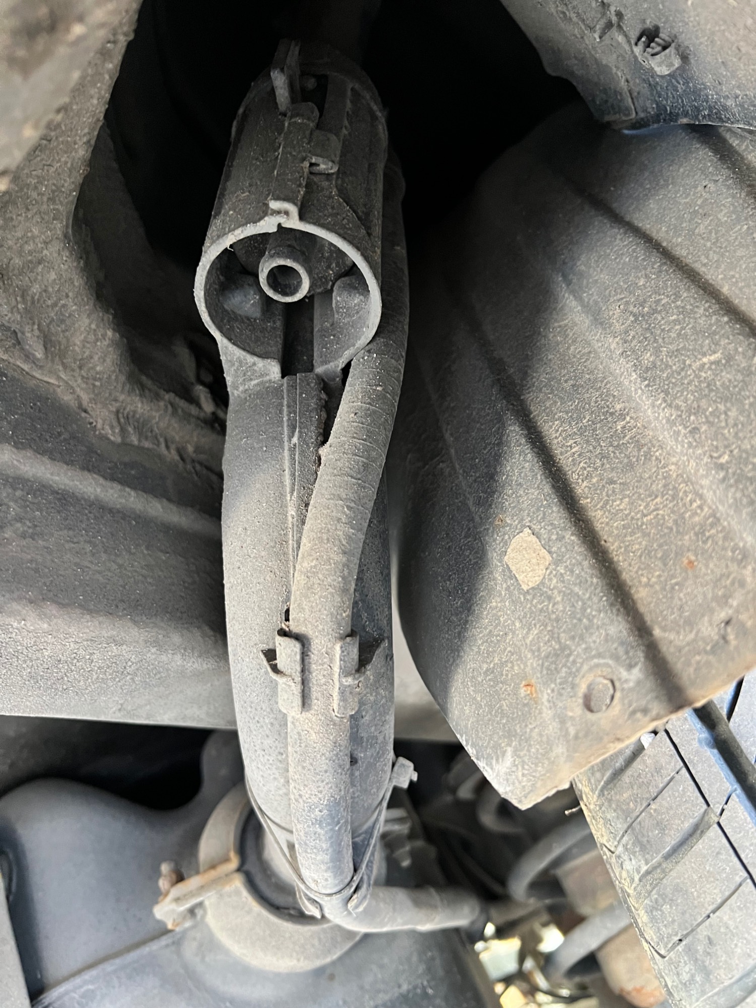

Can anyone confirm that this is the fuel tank vent hose from the pictures below? The tear is in a hose attached with an oetiker clamp. It is near the fuel filter. It then runs to the back of the car along the fuel filler neck. I have included two pictures, one of the hose next to the fuel filter, and one of the hose from the back of the car, where it runs up along the neck.

Not too critical to use OE part there. Any fuel vapour resistant hose if the right size will work
- Posts: 15488
- Has thanked: 2200 times
I'm not sure that is your leak point. That comes off the roll over valve and just runs up to the vent which if I recall is just a filter. I don't think it is a valve in there unless it is a one way valve allowing the system to pull a vacuum. P0455 is a large leak.
Try the hose first then let us know if it fixes the problem please. I may be wrong on this one!

That's a good size crack. However, you could duct tape that first and see if the problem goes away. If it doesn't keep looking. Removal could potentially create another issue along with the original if there is more to it then that.
You have made it even better by affirming duct tape may be a suitable fix.
After more time on my back, and recognizing what a challenge it's going to be to get tape in there, I'm waiting a couple weeks until I get my next parts order in, including a new fuel filter, to address this problem when everything else is loosened up.

Possibly. One thing worth checking is the gas cap and the seal in particular as it does split with age. Also check the top of the fill pipe. I had a friend who had a leak issue and it turned out to be someone must have been rough with a fuel fill and had deformed the top of the fuel filler tube enough to not allow a good seal. We were luck to be able to reshape it sufficiently to fix the issue.

Since your CEL has not returned after the gas cap tightening, if reachable run a bead/gob of silicone on that crack and let it dry a few hours before using the car. If the problem doesn't come back don't tear into system for awhile unless you need to just in case you wind up creating another issue. In my case discovery of 2
