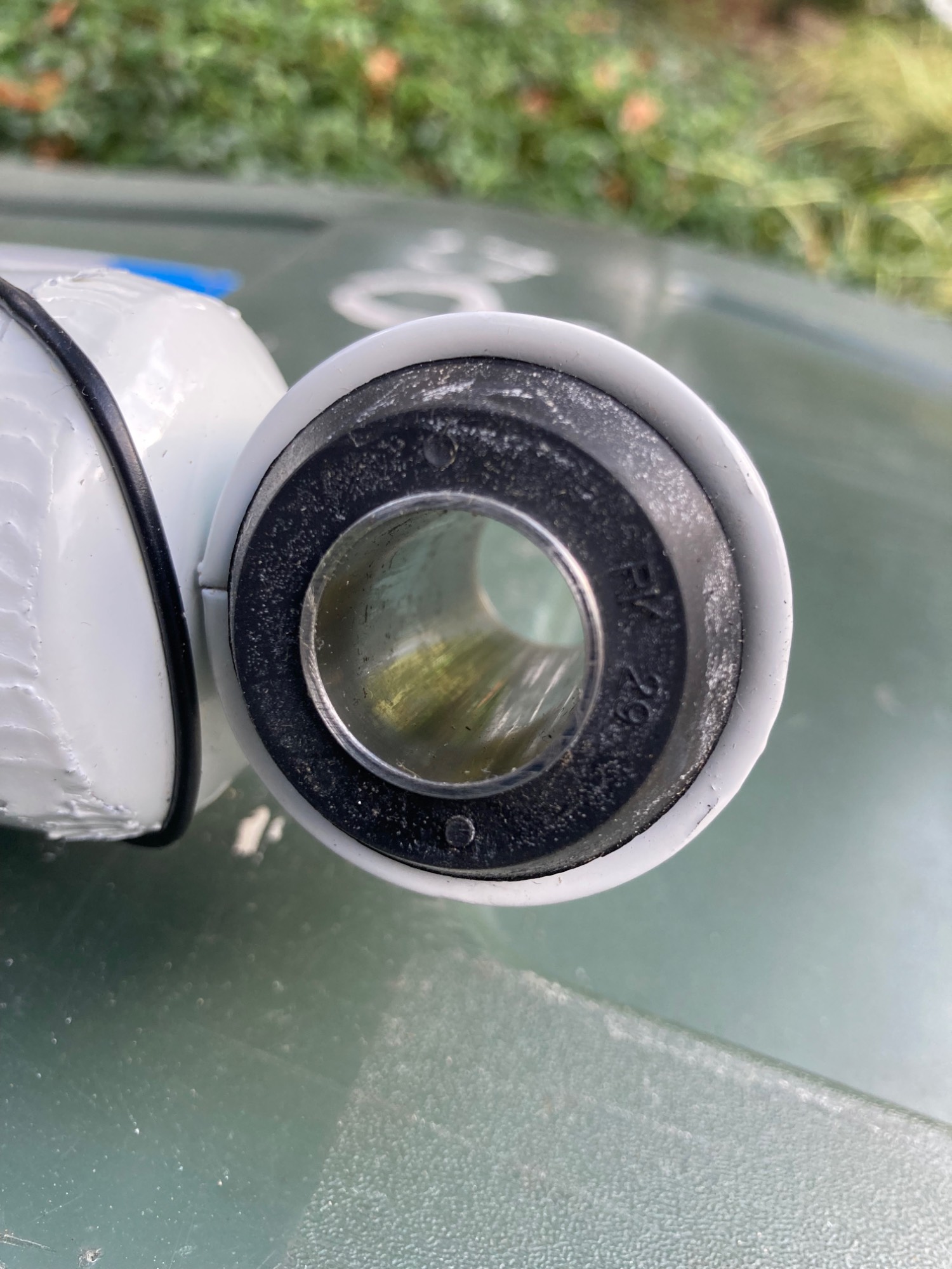

I’ve replaced the shocks twice. Nobody in the world makes a production replacement shock for this car. Nobody. I got custom coilovers from Classic Swede which were great, but then one of the Gaz dampers failed and nobody nearby (Seattle) rebuilds shocks… My interim solution was to get the closest shock I could find in terms of Ext/Comp, end codes, and intended vehicle characteristics and modify to fit. That turned out to be a Gabriel G63708 shock for an Isuzu Trooper, for which I made custom bushing sleeves top and bottom to fit the M12 top bolt and 18mm lower stud on the trailing arm. It works, ish. With any weight in the back, the car sags a bit. (And before you ask: it’s a factory non-Nivo car.)

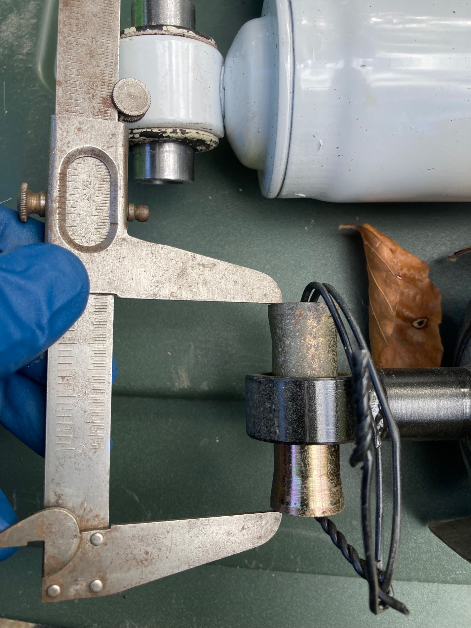

1. The top sleeve (12mm ID, 3/4”(?) OD) needs to be solid all the way across the shock tower at the mounting point so it can get clamped by the bolt and not buckle the tower wall or allow vertical play. Couldn’t find an official length, so I measured this from the Classic Swede coilover bearing spacers as 2 11/64” (or 55.166mm - I only had an old imperial caliper). Use a hydraulic press to replace the stock sleeve with the custom one.

3. For the lower sleeve the length is the uncompressed length of the bushing (1.75”). Use 2x 1/8” thick x 20mm ID fender washers on each side plus an M12 1/8” fender washer to compress bushing to 1.25”. The stud on the trailing arm is just about 1” overall length.

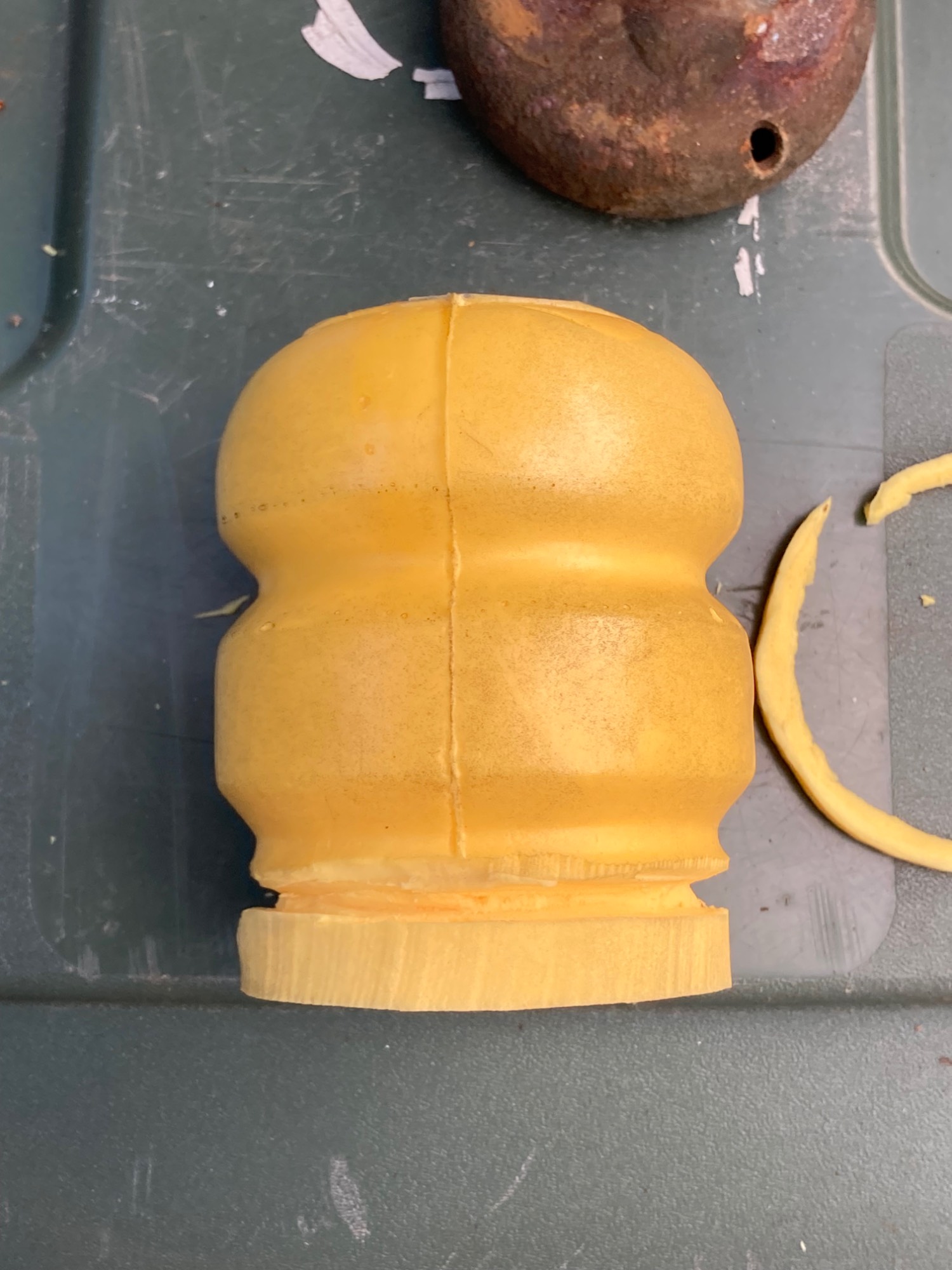

4. The bump stop replacement stock is GM part #15039397 - axle bumper for a Tahoe, etc. It needs shortening, trimming around, and a groove to get locked into the cup. It’s squishy enough to do by hand.

- Custom sleeve: 18mm ID, 20mm OD, 1.75” L
- IMG_9799.jpeg (421.26 KiB) Viewed 920 times
- Source for top sleeve length
- IMG_9855.jpeg (555.17 KiB) Viewed 920 times

- Old bump and new stock for insert
- IMG_9803.jpeg (503.85 KiB) Viewed 920 times
- Cut down, radius trimmed, grooved insert
- IMG_9809.jpeg (384.95 KiB) Viewed 920 times
- Completed new bump stop
- IMG_9811.jpeg (496.96 KiB) Viewed 920 times
