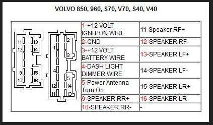

I'm looking for the SC 901 electricial wiring. Would like to plug a bluetooth card to catch my Spotify phone source. I've made a search on the MVS database, but nothing came out. I may have not looked with right terms.
Does it exist on MVS somewhere ? Is this enough what i plan for ?

There are general wiring diagrams for the radio and speaker outputs. Where do you need to plug the wiring into?
Try this thread. BJ added a link for the Dolby unit but it may have what you need:
viewtopic.php?t=102387&hilit=speaker+wiring+diagram

A bluetooth adapter like this is probably the quickest and simplest:
https://www.ebay.com/itm/262888908829
viewtopic.php?t=104443
I haven’t used it myself, and it’s a little clunky,
but if you want to stay stock, it’s certainly an option.
