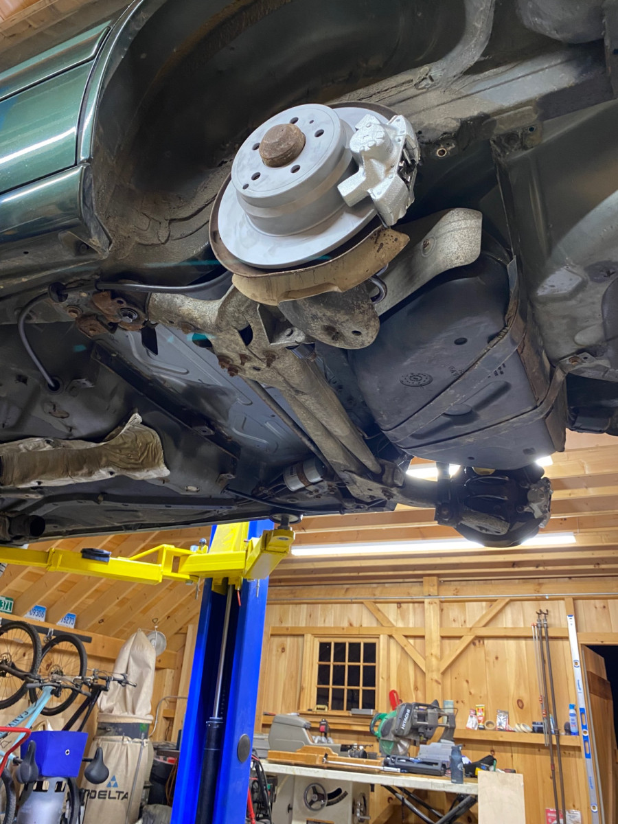

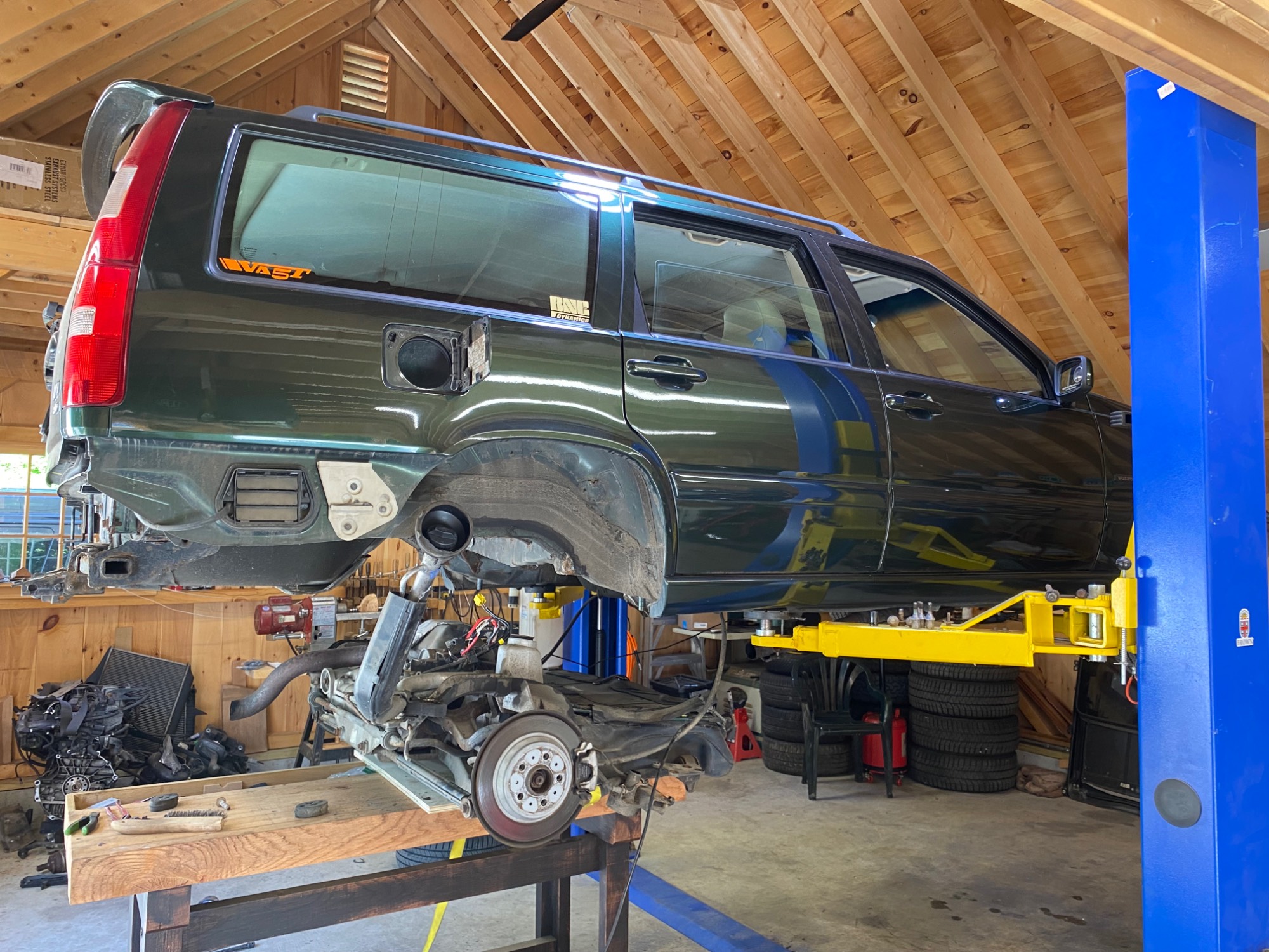

If not, the fuel pump is a common failure point on these. They can and do fail, sometimes without warning. You have two replacement options for this - cut a hole in the floor, or drop the rear subframe. I did the latter on mine… …after which I realized that there are ZERO good quality replacements for the AWD fuel pump. The ProParts unit is reportedly trash, and nothing else will work as a drop in pump. I’ve heard of people retrofitting DW200s into the AWD basket, but I wasn’t able to do it personally.
So, I FWD swapped my ‘98 with the delta link from a base car. The AWD on these cars isn’t worth the headache, difficulty to work on, and expensive or unavailable parts. Note that I’m not the only one that has gone this route after a failed fuel pump on a AWD car.
