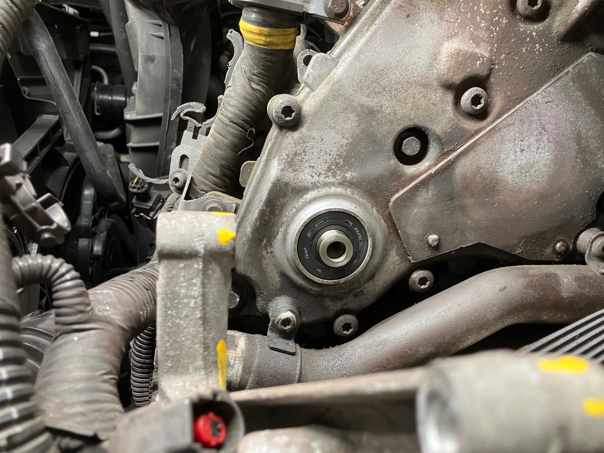

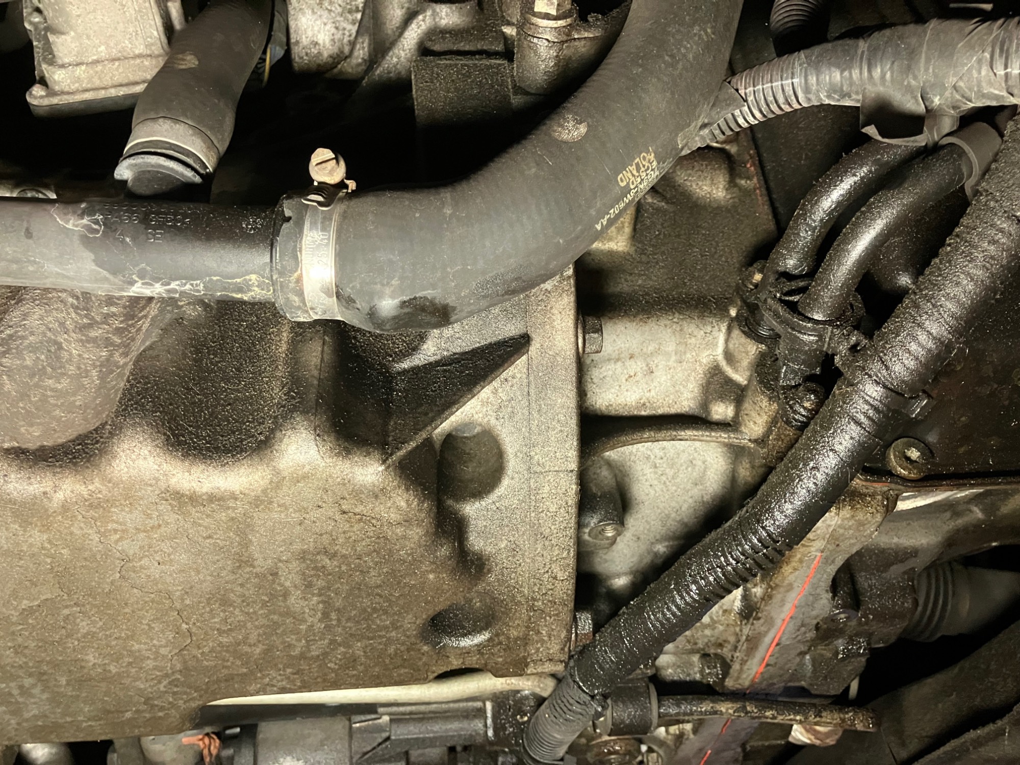

Replaced the seal (new pictured) and hose (old pictured) yesterday. All is well, I think, on to the next task! Thanks Paul for the comments — I used your approach to realigning the AC bracket (paint pen).
Parts:
Elring decoupler seal (came with tool that worked great)
LR005564 Coolant hose (see link in original post)
Gallon or so of antifreeze
About 3.5 hrs including cleanup

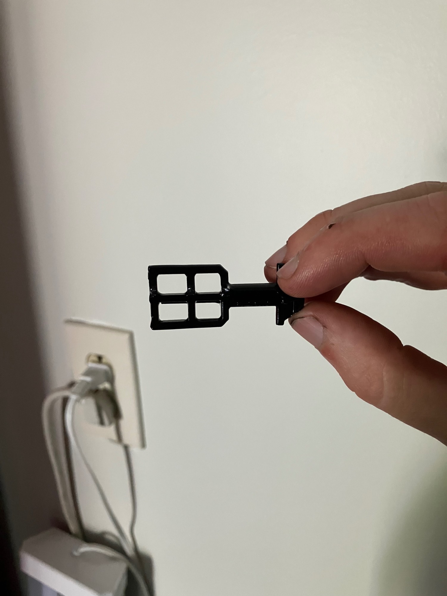

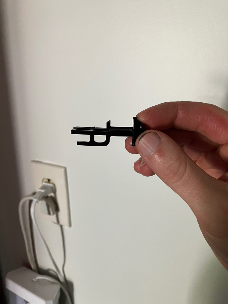

Question: any idea what this is? Found it under where I worked on the car. Hopefully nothing essential!

It isn't something that I've seen before.
