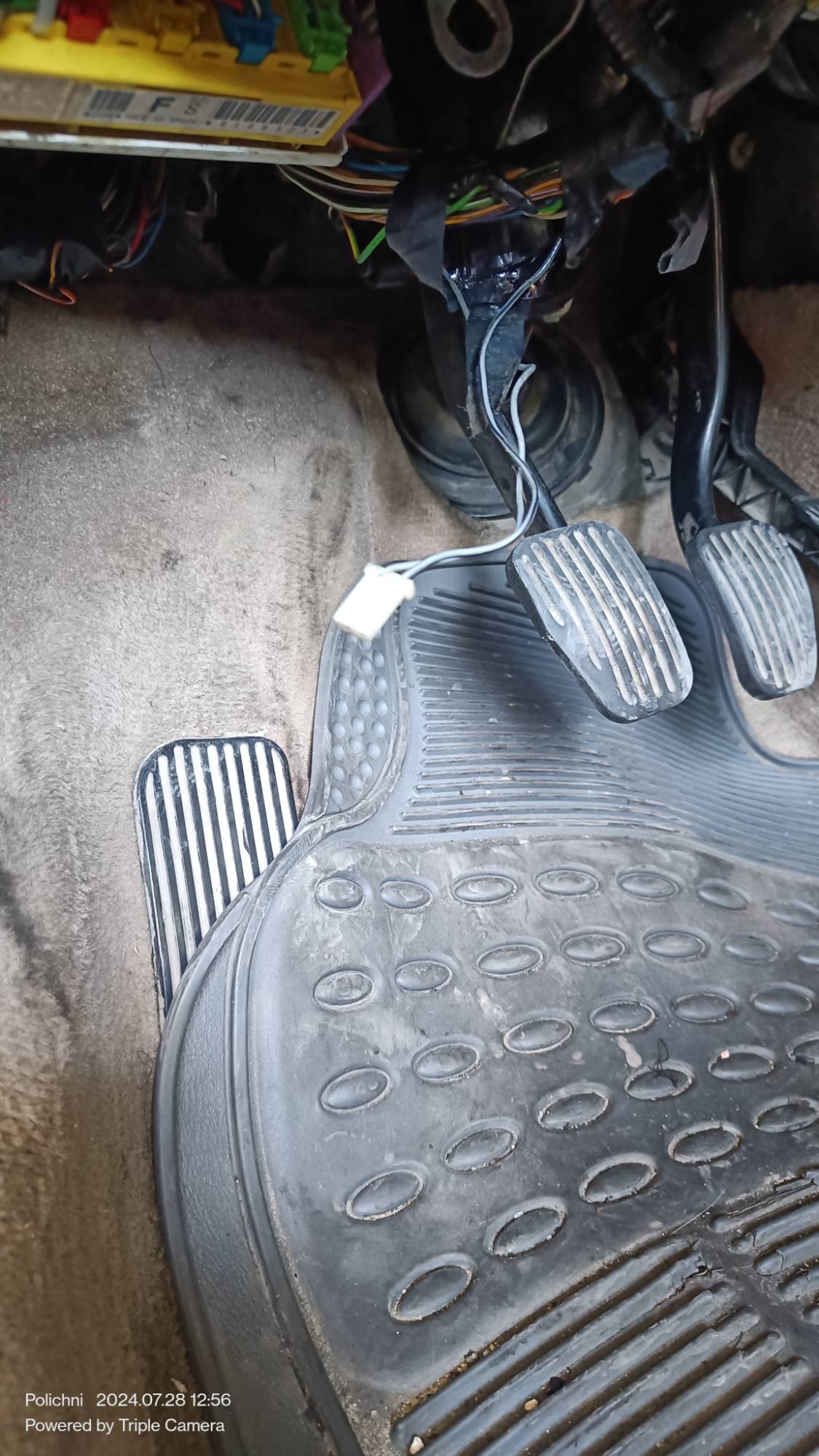

I replaced my dashboard. Pulled the old one out, changed the harness from the old to the new and added the new one back. I have a problem... No speaker works except the two tweeters on the dashboard, I have an aftermarket radio. Any clues or/and any insight on what should I do. I also have a small black connector with 2 wires near the big master connector that I can't seem to find where to put it. Thanks in advance

I replaced my dashboard with a used one I had and I used the old harness because the new one was cut in some places. I will check the diagram maybe I fried my radio if that's possible
