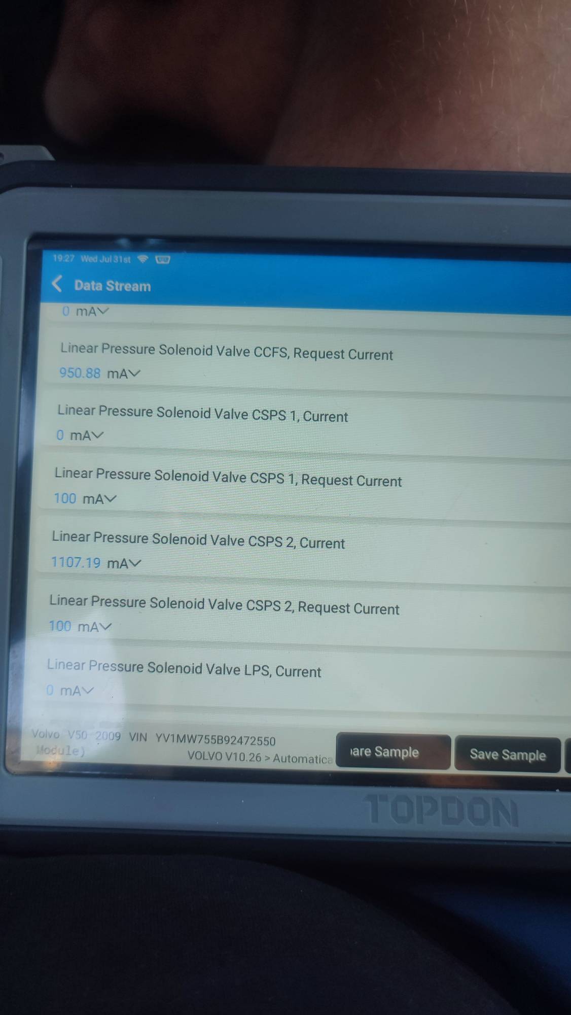

Hello. help is needed. Recently became the owner of the Swedish automobile industry. There is a problem with the automatic transmission, namely when it is cold, there are strong kicks and impacts. Error codes tcm-05b3, tcm-05a3, tcm-05c2. I changed the oil based on vida.But when reading the data stream, I saw that the csps2 solenoid is always under the same voltage, and only the request current changes, and it constantly freezes when the ignition is turned on and the engine is running. As I understand it, it needs to be changed? Please help me if you have information about my problem. Thanks in advance to everyone who read my post and perhaps will give at least some solution to my problem.

The fluid change made no change to shift quality? What type of transmission fluid did you use?
