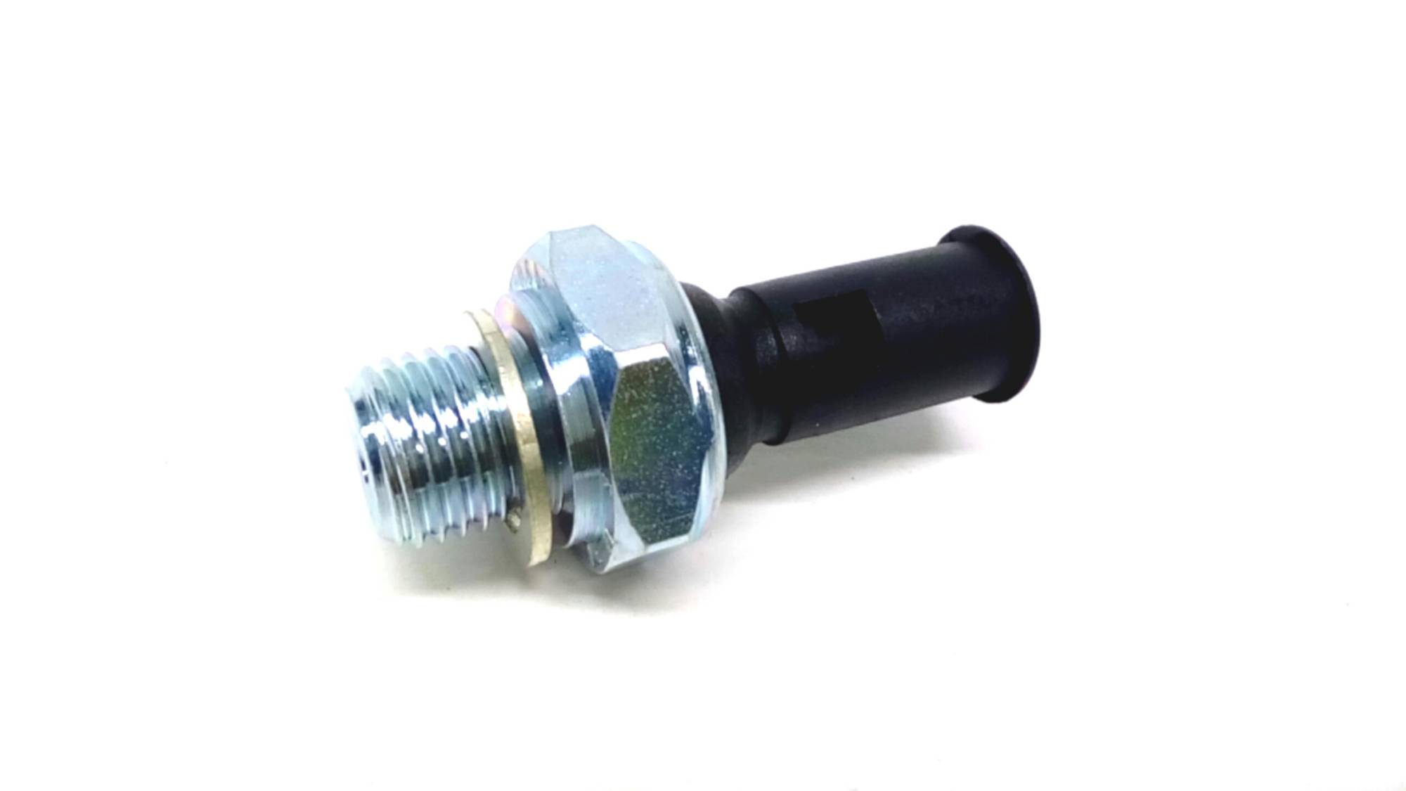

When I was under the car this weekend I discovered an oil leak that appears to be coming down the block on the radiator / left side of the block (forward). A lot of plumbing and hard to see in there, but I think it's this pressure switch low on the block.
https://www.volvopartswebstore.com/prod ... 45696.html
Anyone had trouble with this?
It's either-
It's backed out with vibration.
Someone forgot to put the crush washer in.
The housing cracked.
I'll see if I can get a hand up in there to check.
Oil Leak at Oil Pressure Switch (04 XC70)
Your guess is on the right track and assumptions are also true.

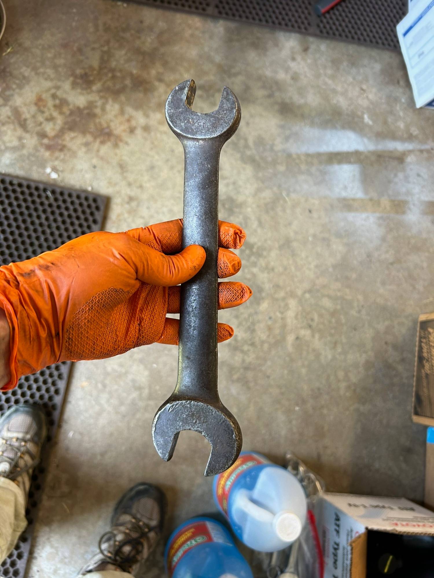

While I was replacing the o-ring on the filter cartridge I wiped everything off and reached up from below. Just enough room for your arm between the subframe and the pan flange. You can reach it with a long open end - I went through 17, 19, 21...nope! That's the biggest open end I have.
So I got this bad boy antique in my drawer out and somehow it fit. Snugged it up, I'll watch it for leaks.
15/16 and 1 1/16, curious what it was for - an old machine shop? By my calc 15/16 is 23.81mm, so do you suppose that's a 24 mm hex on the sender? It worked!

That is funny, I have found that a 15/16" wrench has come in useful over the years on various Volvos. Most of my tools were bought metric, but I have a fair number of imperial dimension tools also. One of which is a combo 15/16" with open end and ring end on the other end.

I think this came from my old neighbor, who was 96 when he died. He would come over when I was tinkering and give me some old tools.
