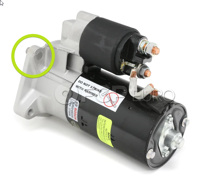

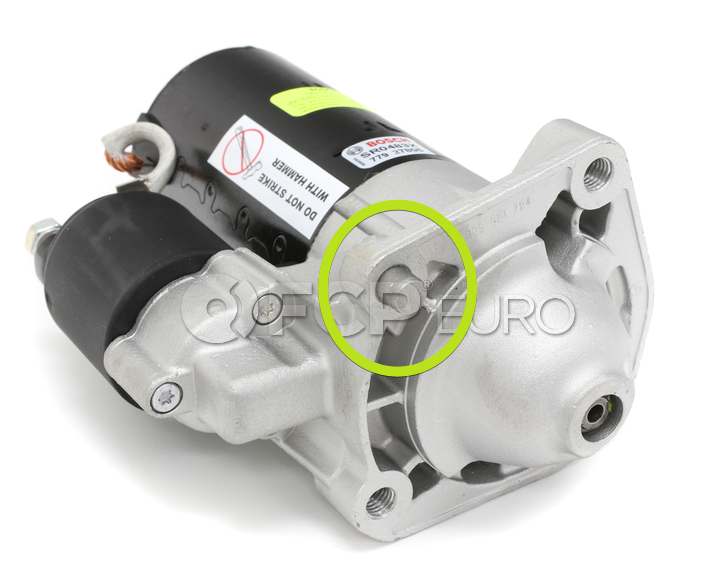

Thanks, I'm trying to do that now. The wires are disconnected, the stud bolts are out, but I have yet to be able to remove it. It seems to be stuck on the pin.
I'd like to avoid hammering it off. It seems best to test it before damaging it. :)

Can't recall, but does the 05 have the rear end of the starter mounted on a bracket like the P80's? I don't think so.
The starter can get hung up on the dowel pin. If you can't just work it back and forward to break it loose, you may have to try a pry bar or a flat blade screw driver gently hammered between the flange and the starter near the dowel.
