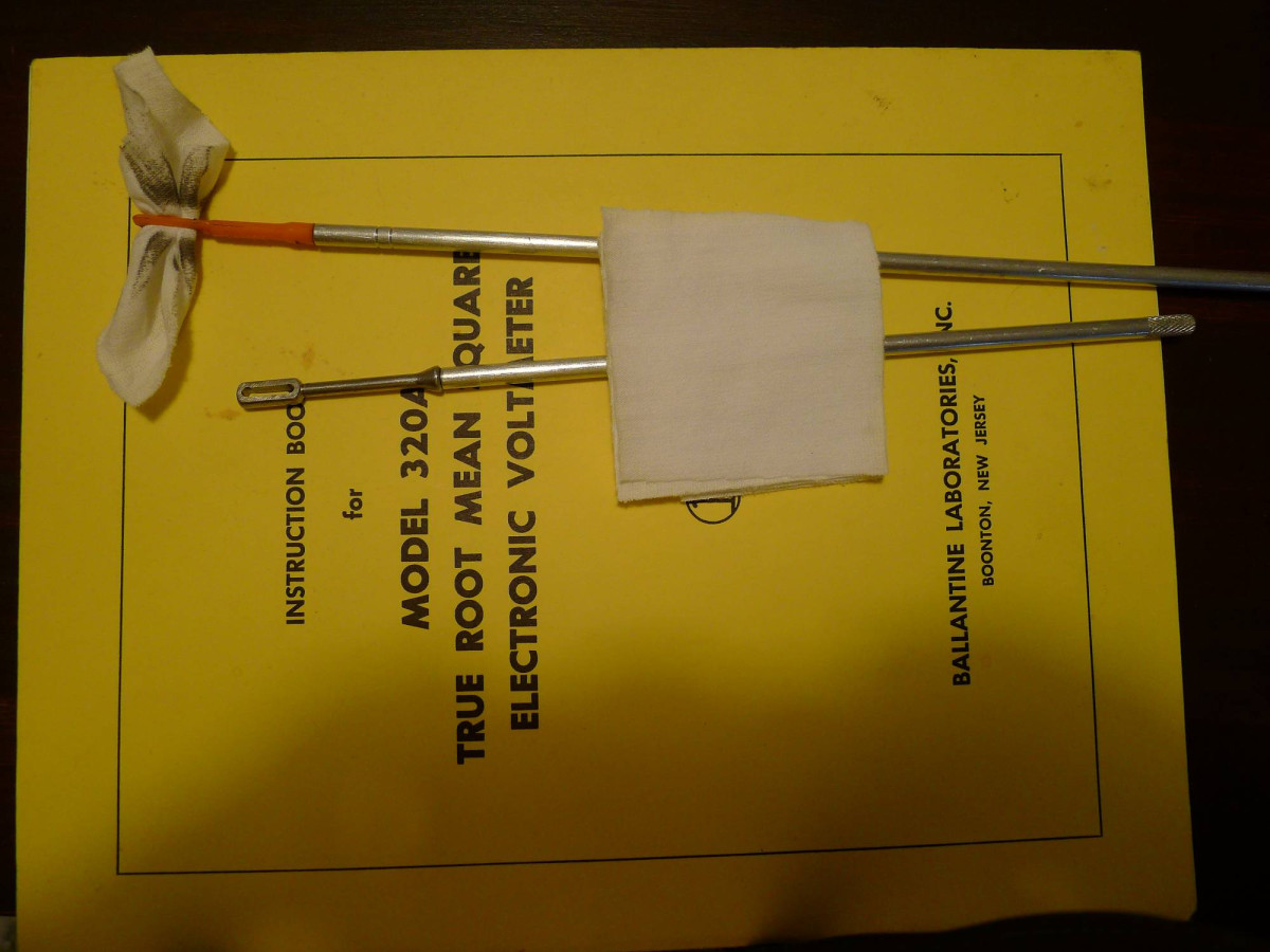

I use a thin strip of cotton clothe wrapped around a flat blade long screwdriver soaked with WD40. If you want it really clean, then do the same with brake cleaner.

Once the plug is out, there might be a bit of PB Blaster in the cylinder, it will be burned anyway. If you are concerned, then use a long piece of cloth (cut it small like a wick) + long screwdriver and push it down to absorb the fluid.
