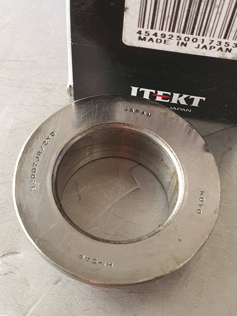

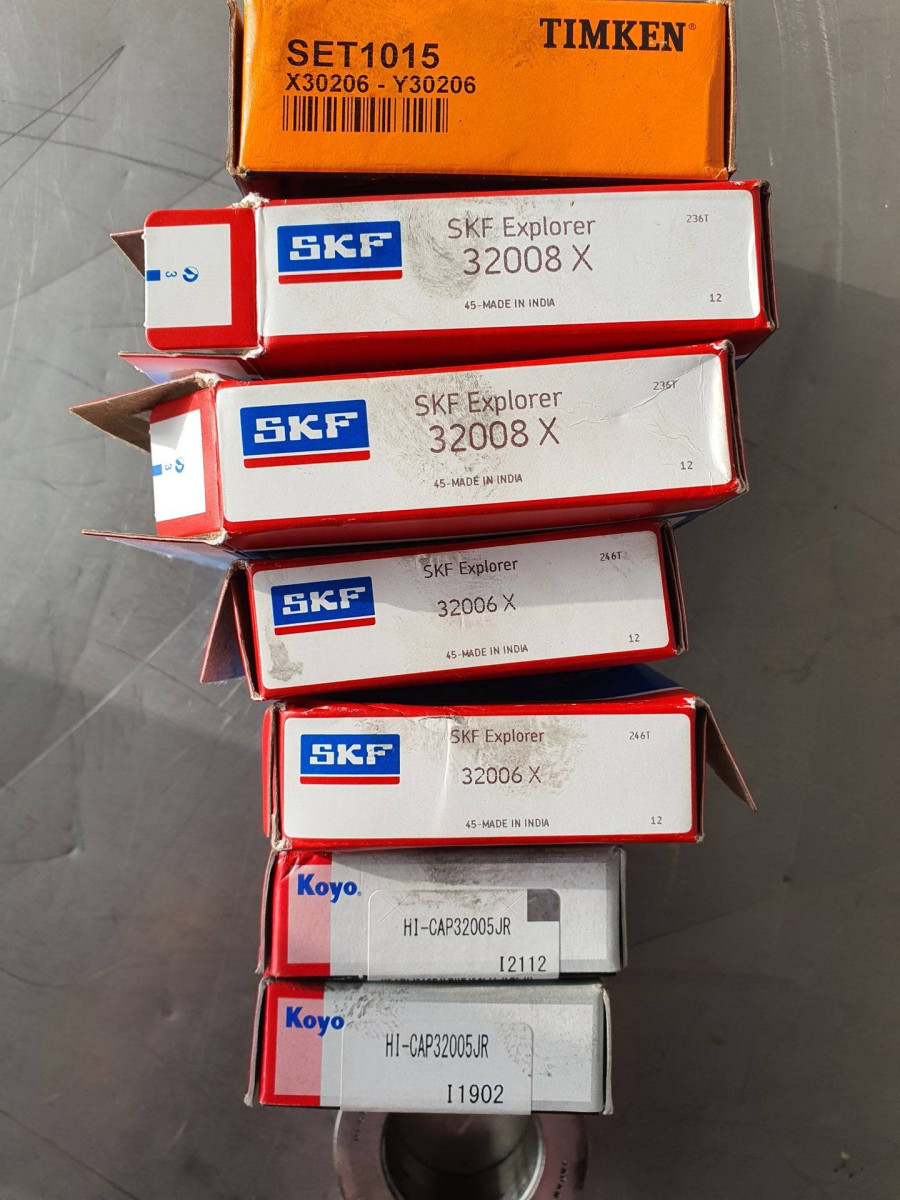

These are the Bearings I used for my 96 R that Inswapped from AT to manual (using a M56 out of a 96 Turbo). They should fit a 20V NA as well.
