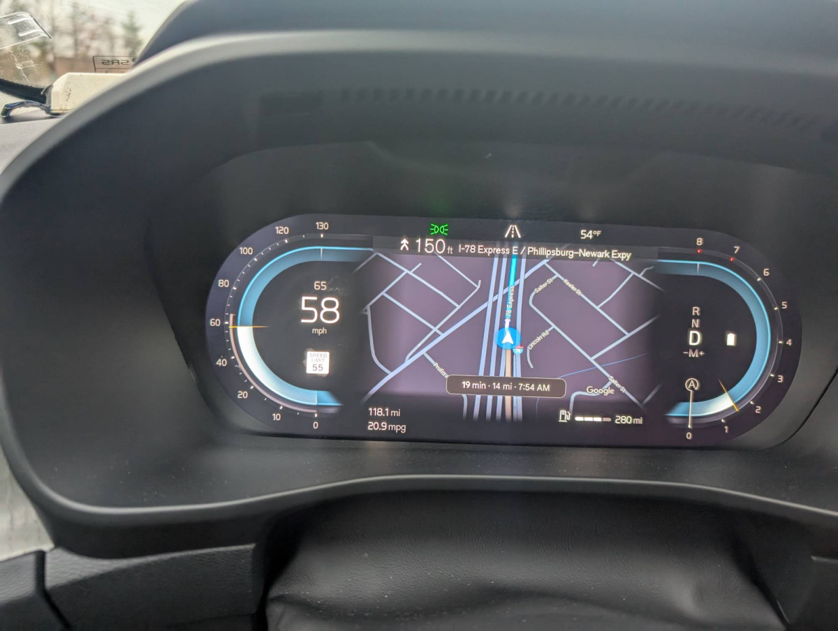

The loaner is a new XC40, and it has an instrument cluster that looks like a video game, complete with Google maps in the middle (a dup of what one can have on the large center console screen) to distract one even MORE:

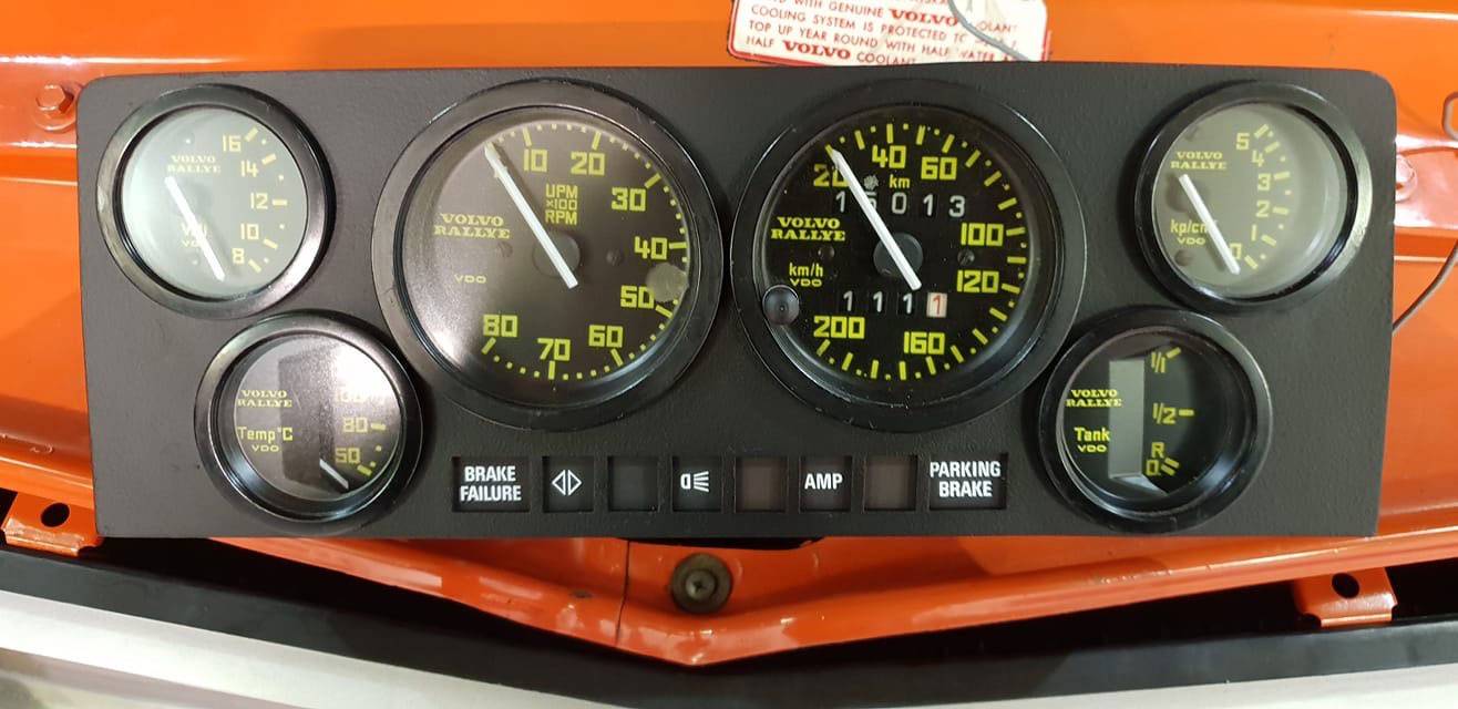

My peripheral vision has been trained over the decades to notice any motion or change on the instrument cluster on the original DeVolvo, a 240 wagon I equipped with a "Rally" VDO cluster, so das v40 bliken-lighten mach mich rubbernecken sichtseeren nacht keepen das eyeballen und da autobhan!
Bonus, when addressing the loose exhaust manifold studs (or gasket, I'm not sure which), the tech either cracked the feed-in pipe to the catalytic converter, or found a crack that may have been the sole source of the problem. Anyway, I get a brand new cat at 100K miles for free, not so shabby, as it is also covered under the PZEV warranty.
