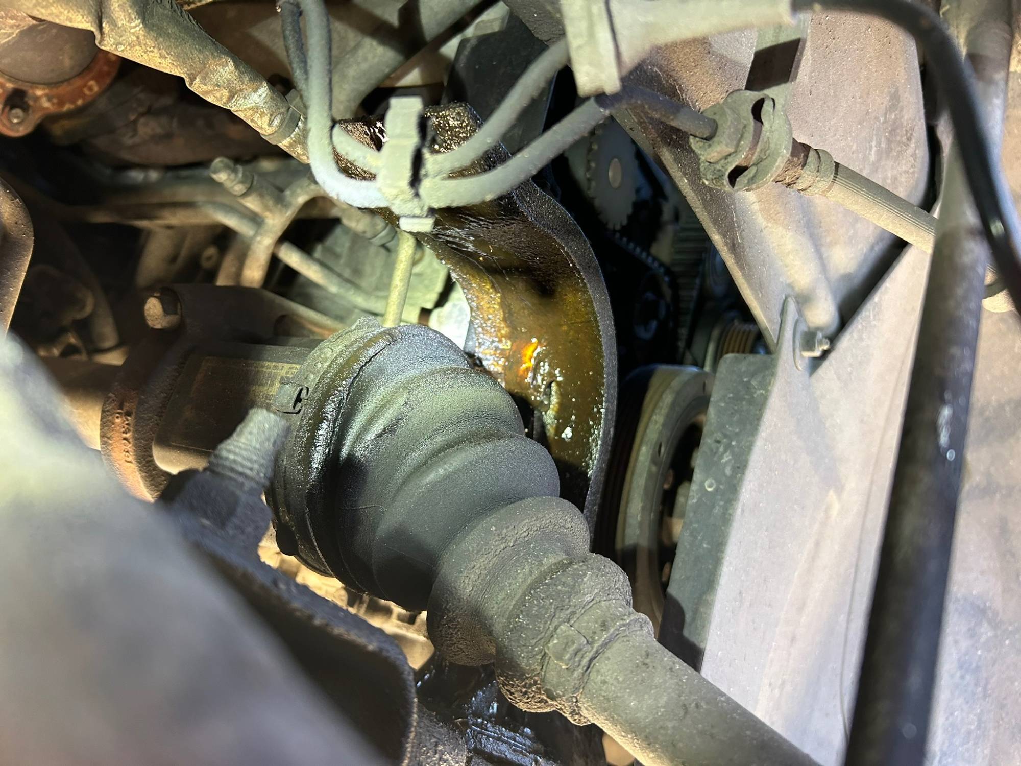

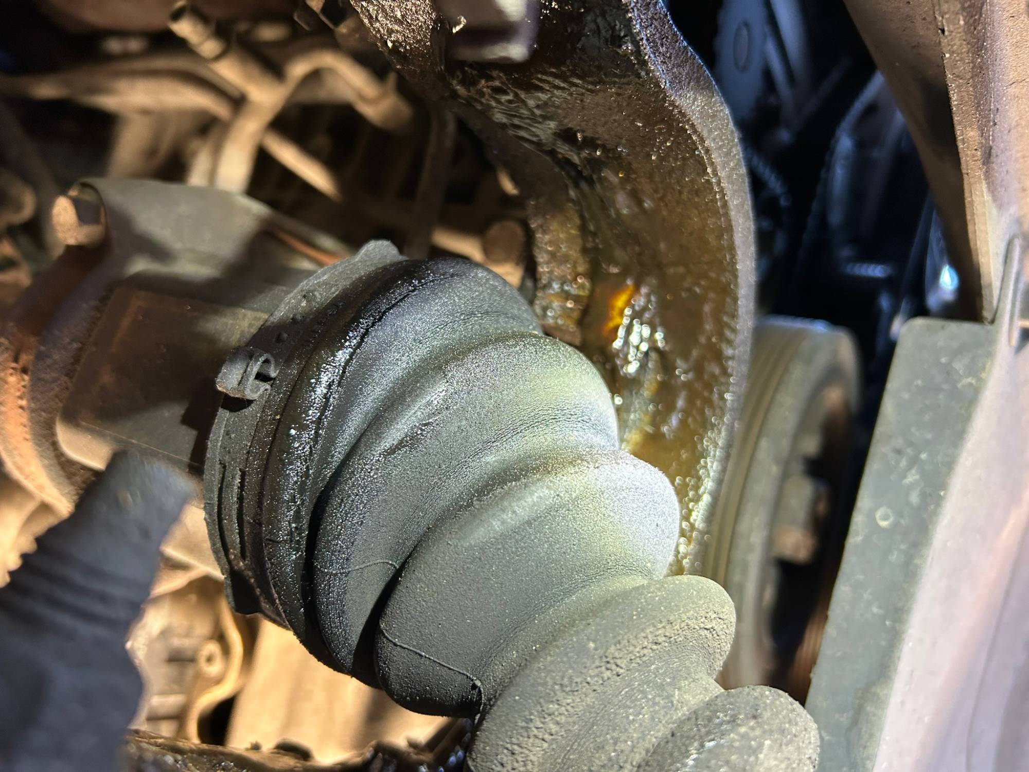

I discovered this whilst under the car this weekend. Right-side CV boot is spraying grease.
Pretty clearly split at the bellows.
I've heard no noises, no problems. 150,000 miles, '04 XC70.

A factory original GKN axle is worth preserving, particularly if it shows no signs of failure. Get yourself a new GKN boot and grease and replace it. New GKN axles are around $400 a side when I replaced mine 3 years ago. Your split boot looks like its still at the stage of spewing grease out but not split open enough where it would allow dirt and road slop in.

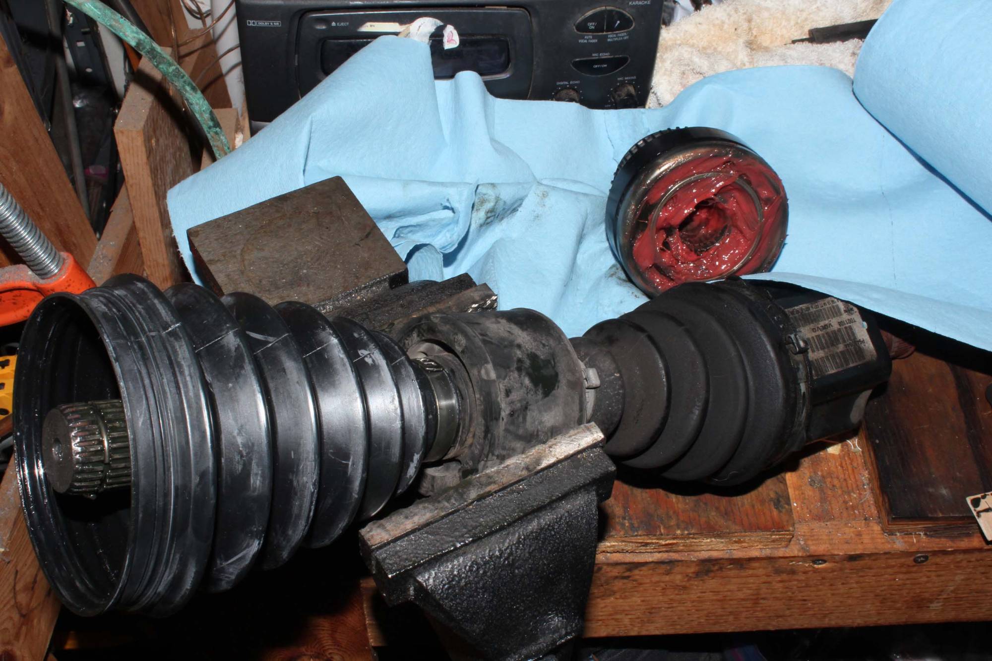

The universal stretch boots won't work for you because the inner cup outer diameter area is not round and they're not a good choice anyway. As Blacklab467 mentioned get a GKN boot kit and replace. It's a messy job but worth it to save a good axle. Would be best to clean, re-grease and replace both the inner and outer boots while the axle is out.BlackBart wrote: 03 Dec 2024, 14:35 I discovered this whilst under the car this weekend. Right-side CV boot is spraying grease.

One thing if you do this is the staked areas of the inner cup need to be ground down or peened down so you can pull out the inner tri-pod. Nice to have a vice to hold the axle while doing the boot replacement.

firstv70volvo - That staked area keeps the inner ball bearing carrier in?
