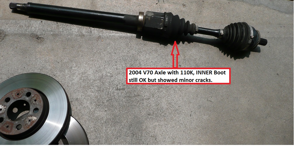

- At 110K, Inner CV boot shows minor cracks but still OK.

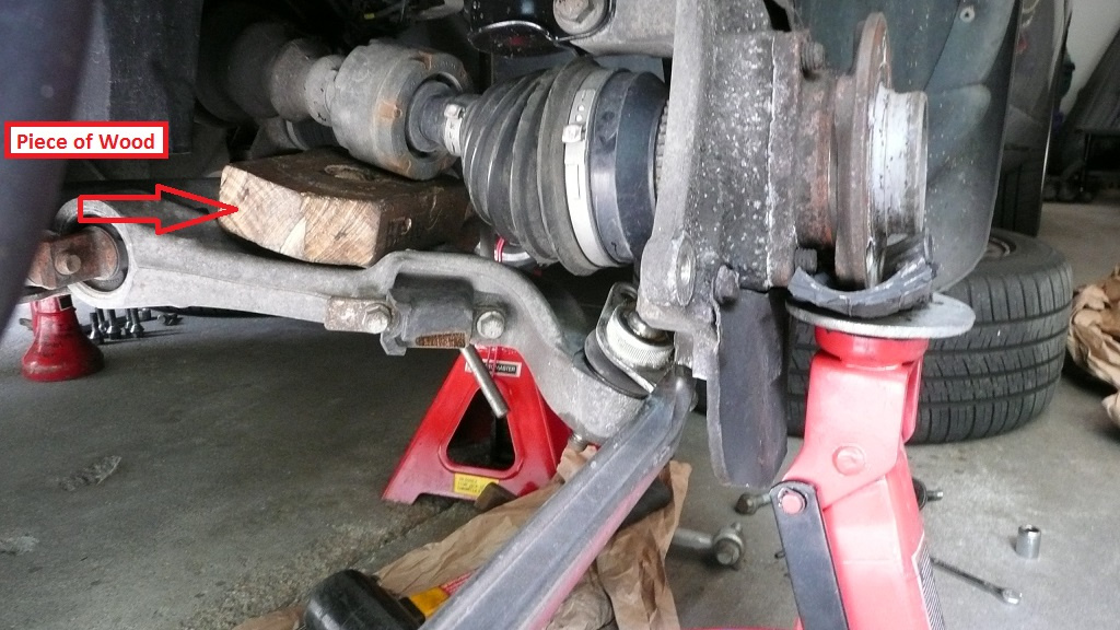

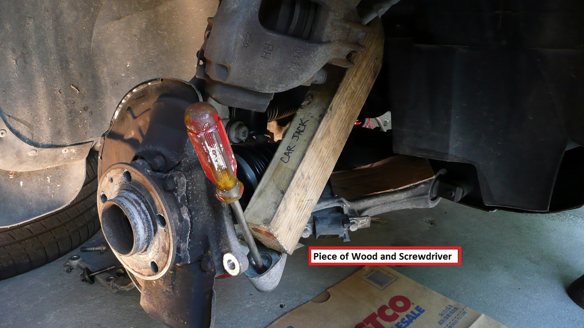

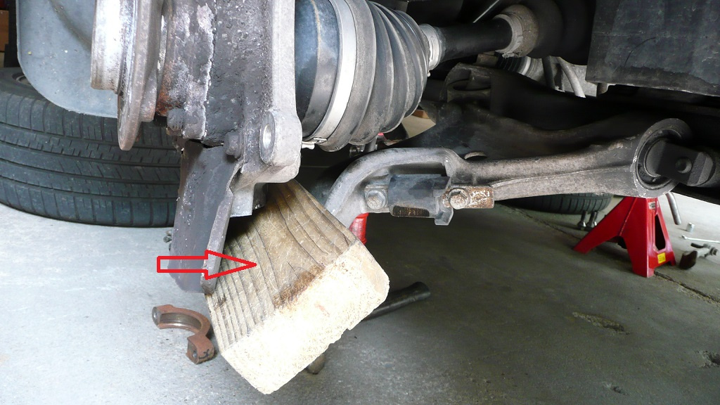

1. You can see I struggle to separate the knuckle from the control arm.
Next time I will loosen the bolts holding the control arm (on the subframe side), as this will allow the control arm to drop down.
2. Minor cracks at INNER CV Boot. NOTE the trick posted by jimmy57 “rotate, tug and pull”.
This trick allows the C-clip open end to point down, allowing the axle to come out.
I also used a cold chisel (wrapped both sides of cold chisel with some cardboard paper) and gently tap the area between Inner CV Joint and Trans Housing, it came right out using jimmy57’s trick.

3. The struggle using wood b/c I did not loosen the control arm!

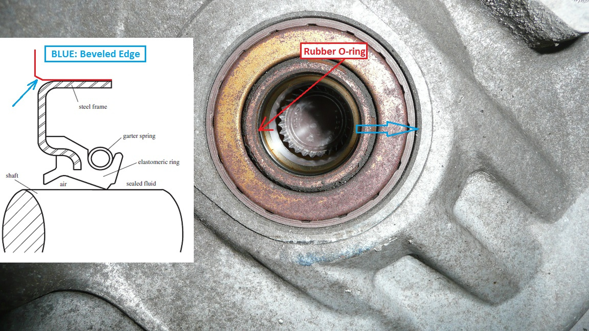

5. NOTE the anatomy of a typical seal. Take photos and use your fingernail to feel the EXACT position of the factory seal location w.r.t. to the bore and install EXACTLY like that. In my 1998 S70, I learned it the hard way, I installed the Corteco seal a bit too far in (2 mm further in than factory): it leaked ATF!
- So, for the 2004 V70 2.5T, I forgot which side (R vs L) but the axle seal is about ___? mm from the edge on one side and ___? mm from the edge on the other side. Make note of this. Use a ruler to measure. Take a PHOTO at 45-degree angle so you can see depth (assuming your seal is the factory one).

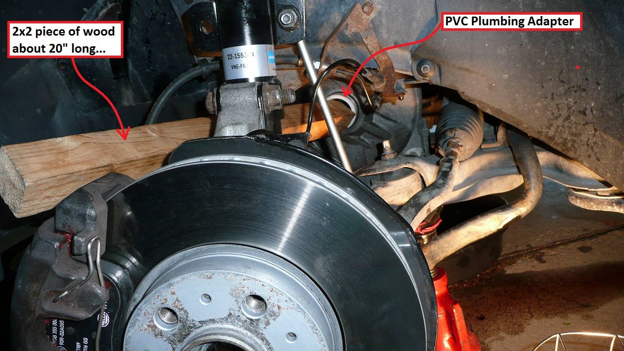

- Installation tips: oil the outer lip (where it meets the bore), and use a piece of wood to install it flush with the bore. Now, in order to seat it let’s say 5 mm further, you need to use the Volvo tool but this tool is expensive. I used a PVC coupler (1.5 inch PVC coupler for home plumbing; info in forum), about $2 at Home depot hardware. GENTLY tap the PCV coupler ALL AROUND the edge of the seal. Space is limited and a mistake means new seal! So go VERY SLOW all around, one tap at a time and use fingernail to feel the depth.
- Note the O-ring inside the cup (the cup accepts the axle splines), oil/grease it before inserting the axle.

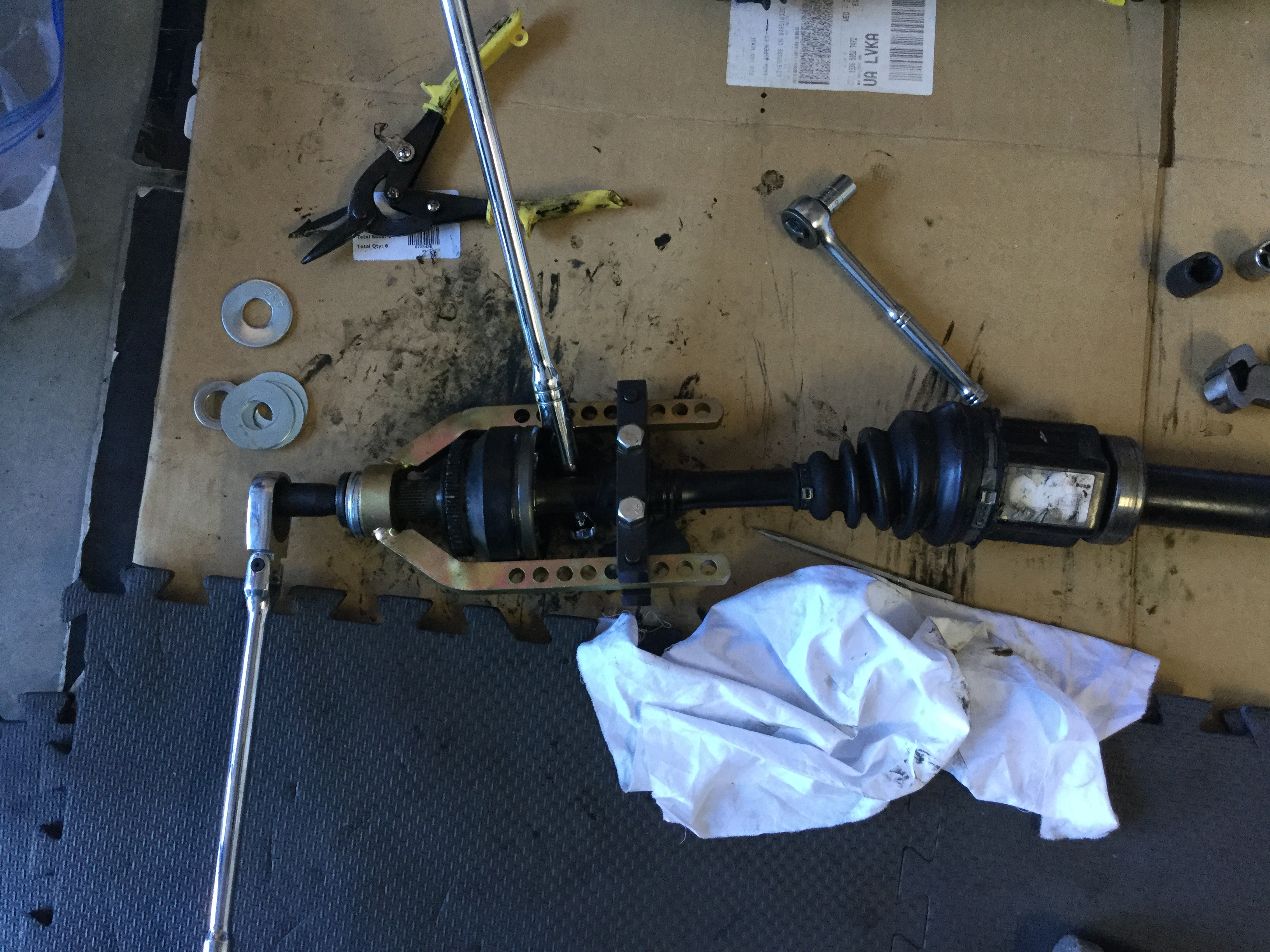

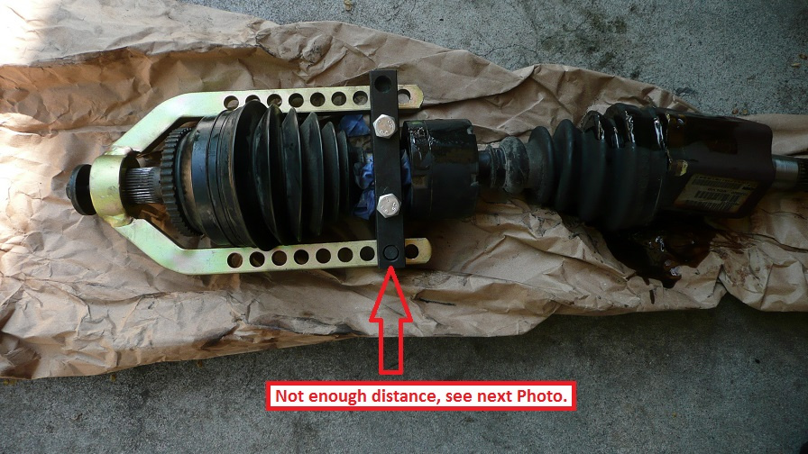

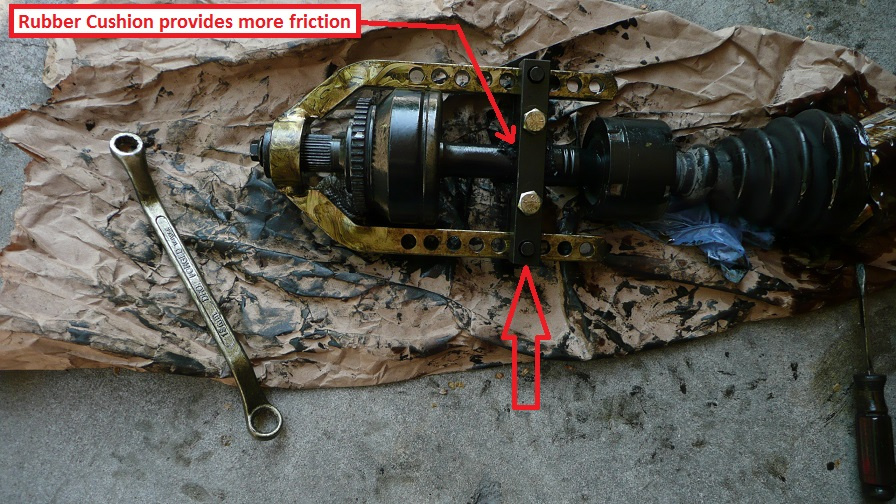

7. The CV Removal Tool ($17 on ebay) is a must. It makes the job so easy:

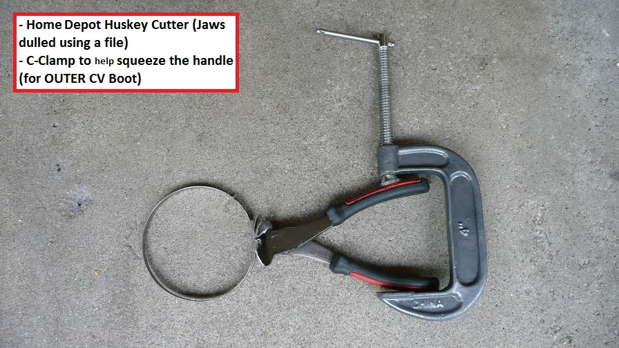

8. The OUTER Oetiker Clamp is very stiff, designed for the PLASTIC type OUTER CV Boot.
Unless you are very strong, hand squeeze is not enough.
- They sell a special tool to squeeze it at a specific torque.
- I used the $10 cutter (Husky brand at Home Depot hardware but filed the edges blunt for this job) + hammer to hit the handle for extra squeeze. Or you can use a C-Clamp to squeeze the handle. Once done, you should not be able to rotate the Oetiker clamp (or you can rotate with some stiff resistance): in other words, the Oetiker clamp should not rotate freely.

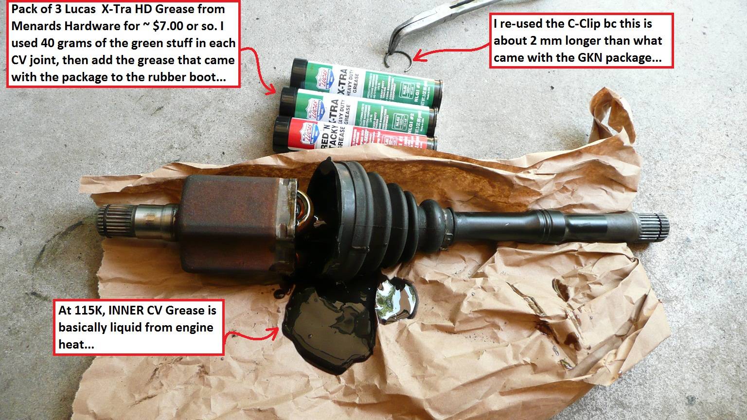

PS: Bonus: the "Axle Ping Noise", IMHO is created by dry grease in CV Joint, is gone after new grease and CV boots.

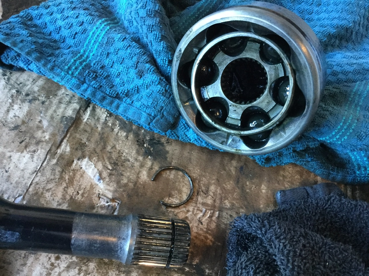

Can anyone confirm if the outer joint has an circlip like the 850 drive shaft? I did see the other post and you can see the cutout for this circlip.This one has not a notch.cn90 wrote: 27 Oct 2019, 11:24 DIY: 2004 V70 2.5T Volvo Axle and Seals (110K miles)

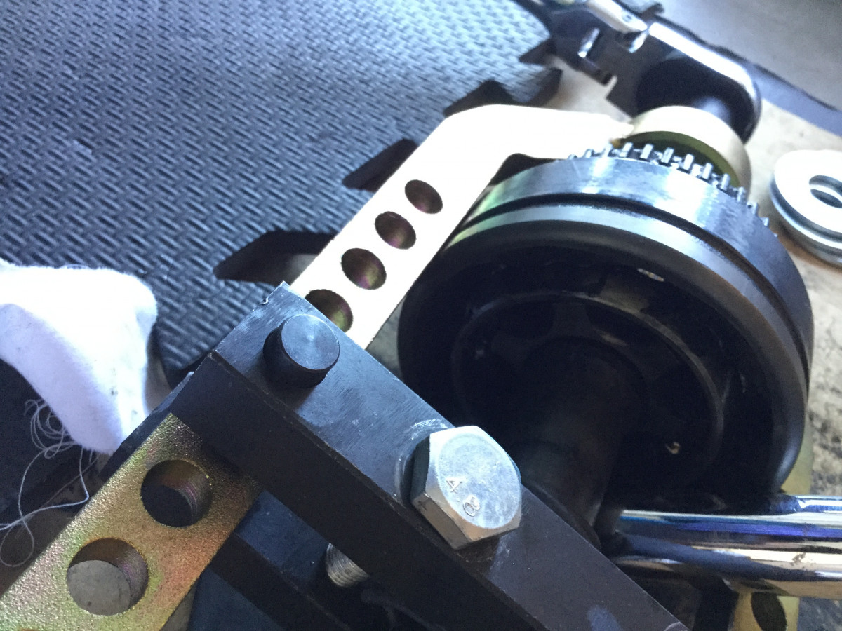

I stopped using the tool , I was using a breaker bar and ratchet with a long handle and couldn’t pull the outer cv joint off. I filed down the notches of the inner joint and separated the cv axle this way. I was able to remove the inner tripod bearing assembly after removing the cir-clip. That took also a large hammer and chisel.
The GKN inner boot from FCPEURO came with clamps to large of a diameter. I could not clamp them enough to stop rotating. The clamps themselves are different then the clamps from the outer boot. They do not look genuine Oetiker clamps. I had to stop and order genuine Volvo boots for the inner joint.
FCPeuro did check there inventory after sending pictures but all the stock is the same.

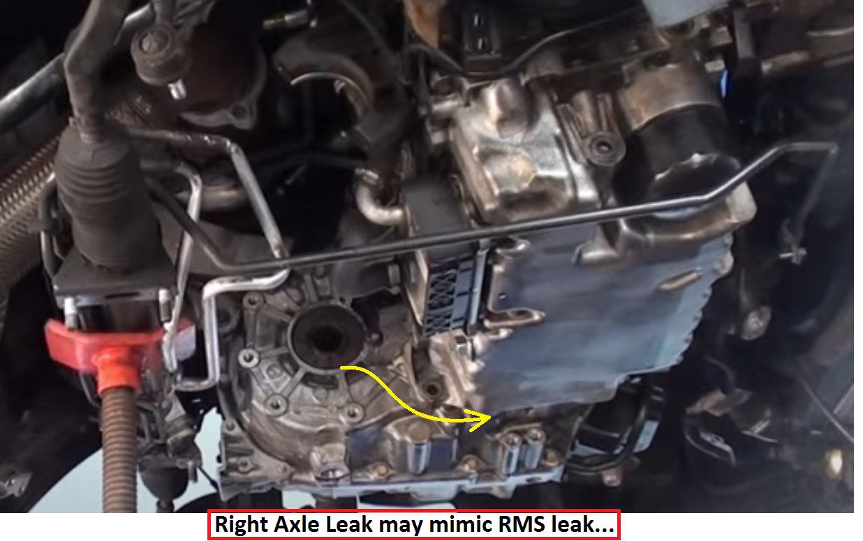

I replaced the axle seals as above last summer 2019...
At the time, I thought I had RMS leak, a job I dreaded...so I cleaned and wiped the RMS area dry and watch.
One year and 7K miles later, the RMS area is bone-dry.
It just occurred to me that a R axle seal leak can mimic a RMS leak.
I took a random photo from the web just to show everyone that the R axle seal sits above and aft of the RMS area...

In can confirm, the outer joint has an internal c clip as shown by CN90 above. I tried this again on my other car. But in addition to pulling with the tool I also hit the internal housing with a punch and after a couple of hits it came loose.

- During installation, the Corteco seal is a nice tight fit, no need for Permatex RTV here. Space is tight, and it
is hard to drive the seal in, so I used the PVC Plumbing Adapter + a piece of wood as shown. Go very very very
slow and tap it slowly and evenly bc you don't want to drive it in too far, you will have a leak if the seal is in too far.
Use a mirror to check for evenness. BEST: is to check the exact factory seal position prior to removal.
Basically, the factory seal sits about 0.5 mm inward of the chamfered edge of the transmission.
That is all, hope this helps you guys...
