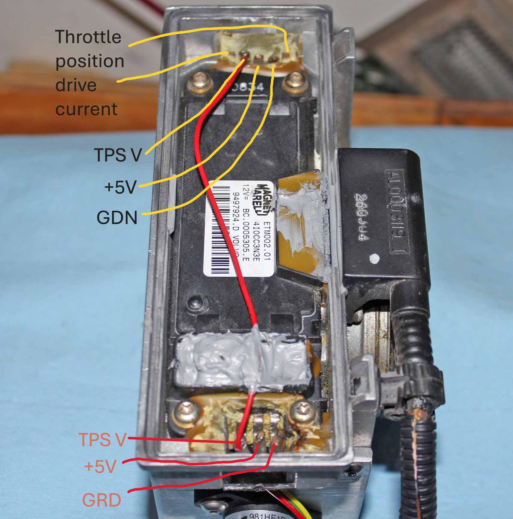

When you did the rebuilt the ETM did you measure the output voltages of the new sensor after install, there's a default resting throttle position sensor voltage ~1.35V to 1.4V after power up and self-test, a fully closed ~0.65V and a fully open throttle position voltage ~4.5V that are expected voltages. In my case, I needed to adjust the sensor position after install to get the expected voltages. When the ETM is powered up it does a self-test mode for a few seconds, buzzing and closing the throttle then releases the throttle to the default position, which is about 20% open. If the voltages are off by too much it fails the self-test and you can hear the difference during the test.

If the codes were cleared and the same codes came back after the new sensor was installed then it may be a problem other than the throttle position sensor(s) with the ETM, like dikidera mentioned. The TP sensors are a common problem but not the only problem with the ETM. I'm not too sure about the software compatibility, such as with an ETM from a T6 car.MagneB wrote: 09 Dec 2024, 11:50I did not have the equipment needed to test and measure after rebuild, but from my memory the ETM codes are the same, but the idling has improved and I don't get any "emission warning/service warning". Possibly because I also cleared the PCV systemfirstv70volvo wrote: 09 Dec 2024, 10:24These are throttle position codes. Are these the codes before or after the rebuild, did the codes change? Are the symptoms, the rough idle, running rich from before or after the rebuild, have the symptoms changed?MagneB wrote: 09 Dec 2024, 07:02

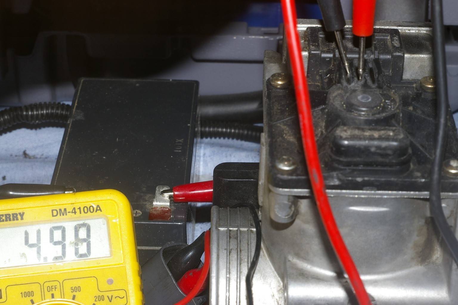

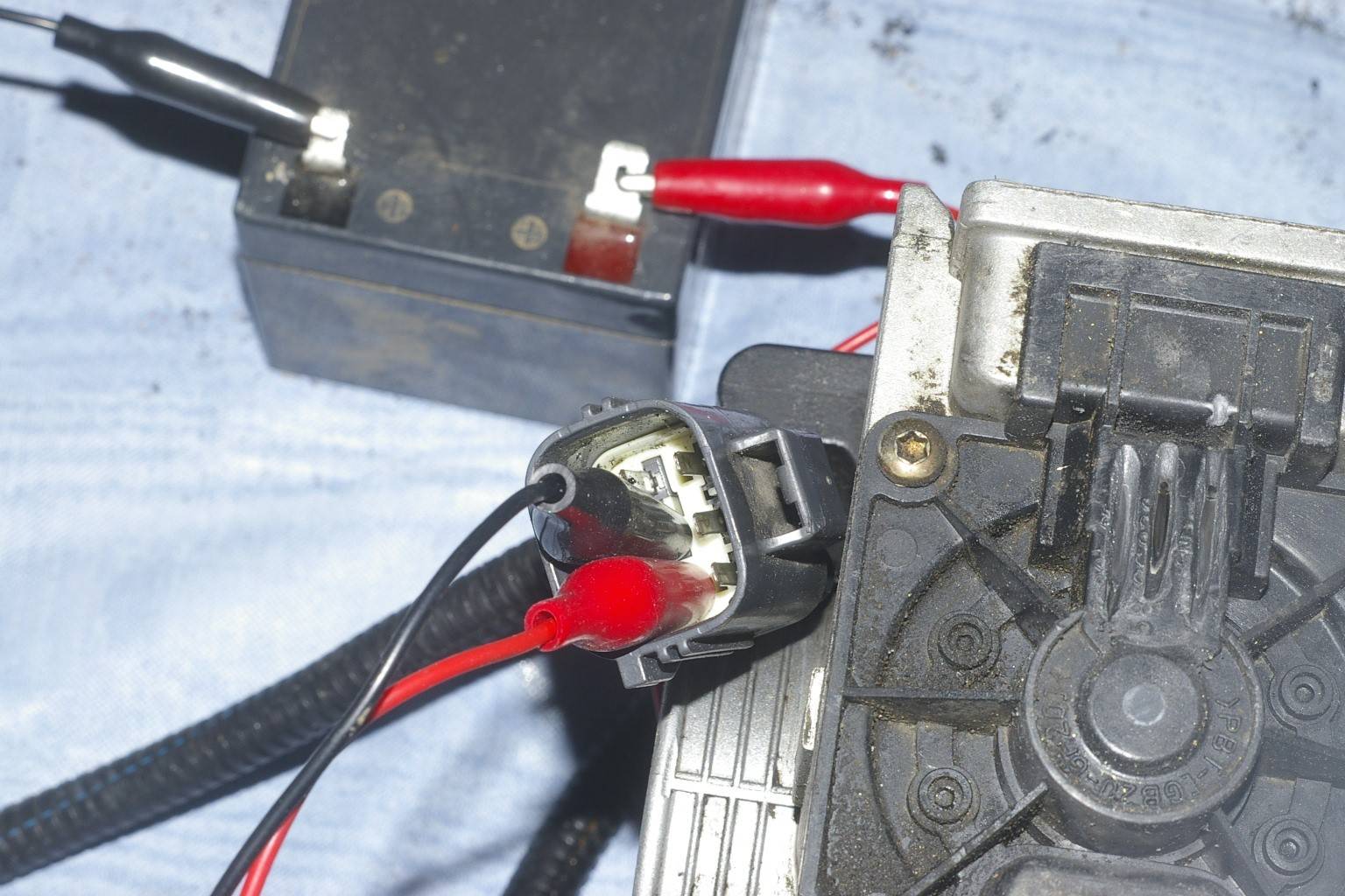

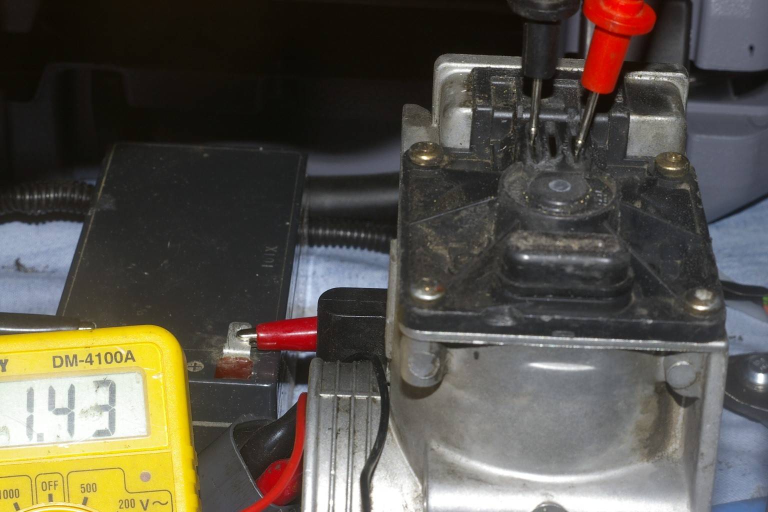

Just some information about checking the TP sensor voltages. You only need a 12V power source and a meter to check the voltages. You connect power to the ETM (see photo), let it do its self-test and then measure the default resting position TP sensor voltage, then manually close the throttle plate and manually open the throttle plate and measure voltages at each position. I have a small 12V lead acid battery for bench power but you can also plug in the ETM into the car connector or use small jumper cables to power it up. You do have to have access to the TP sensor pins by removing the plate. In a couple of the photos I've attached you'll see them I'm measuring the voltages on the outside plates, I ground the plastic to get to the metal contacts since I was experimenting with a retrofit. If you measured the voltages you would do so on the inside once the plate was removed
