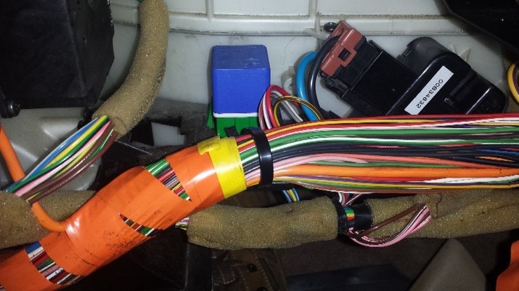

There is a little blue relay next to the power stage... shown near the center of the photo below -- that would be worth checking to make sure it's seated correctly and working OK.
Ac relay volvo 850 ECC.jpg (85.66 KiB) Viewed 77 times
