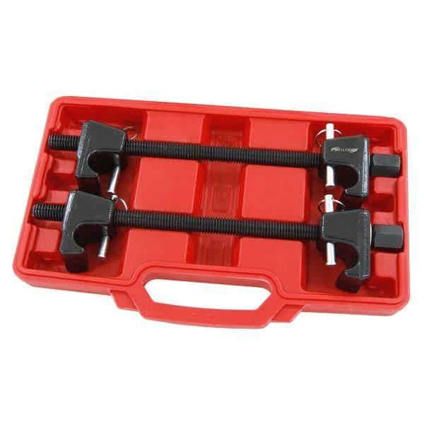

Only thing i wish from next time on mine is to have locking pins (like in picture) as when i did change front springs.. the newish XC90 springs i put in mine were so stiff for one set of compressor i put two stick spring compressors (one were slims and other were more bulky ones). Not hurry is best tip for these. Its scary but when you dont feel anything is when accidents happens with these and just try to do it then it slips and spring gonna spring.

I think those ABNs in the orange box with the safeties are the way to go.
Wear heavy leather gloves and compress slowly , an inch on each side at a time. I chain them to the bench so they can’t fly off

xanthefin wrote: 28 Dec 2024, 12:21 ….spring gonna spring.
That's the type I have. I like them, they’ve been reliable.

I have the same ones. Compress evenly and they work like a charm.

I like both those styles, but could not for the life of me find the safety version with the pins when I needed a set. So now have 2 sets of the not too inspiring versions with the hooks. I use both sets together to try to get the spring to compress evenly.

I have an older version of the ABN type. I've used them a few times with no issues. The only thing I did was changed the washer under the nut to a bronze one. Thought it might rotate more smoothly. Totally unnecessary but what the hell....

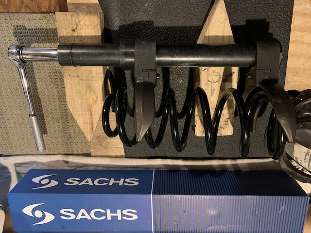

I know this is about six months after you asked the question, but it popped up on the front page and I wanted to add my own option. I rented the Powerbuilt spring compressor from an Autozone, and decided it was worth the price of admission, so to speak. It is two interlocking brackets that have cables to lock the sping into place. There is a nice lip on them to prevent sliding. a wrench opens and closes the unit fairly quickly. Been happy as a clam with this device.https://www.powerbuilt.com/products/str ... eq=uniform
