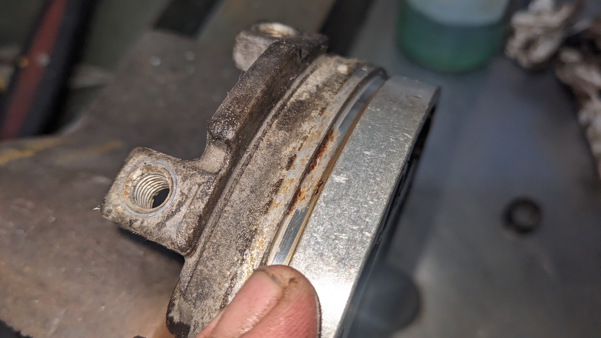

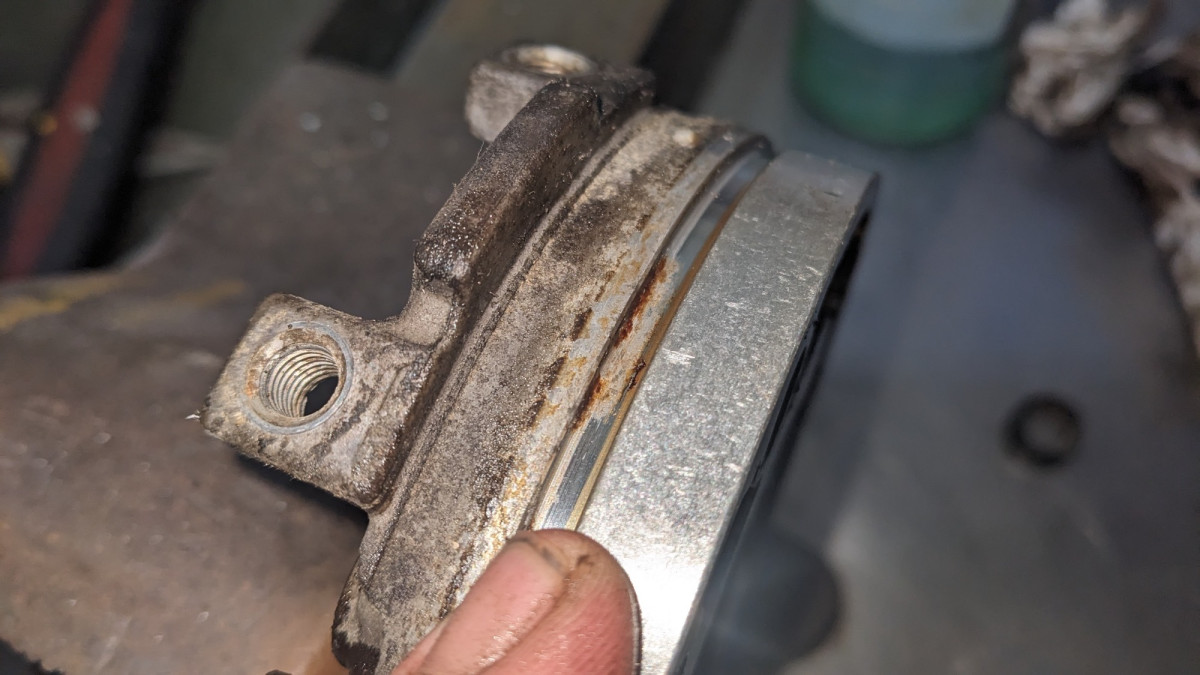

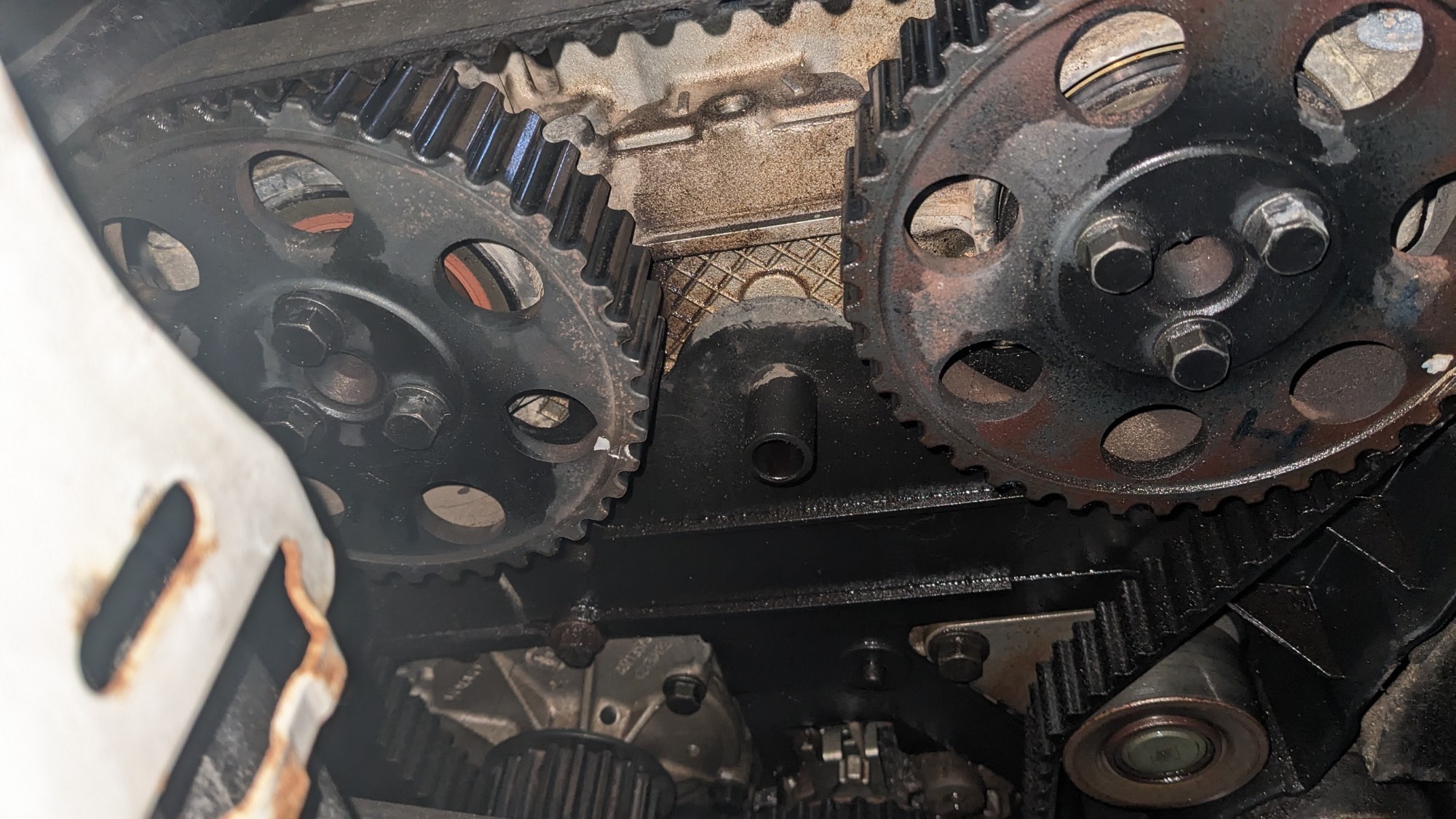

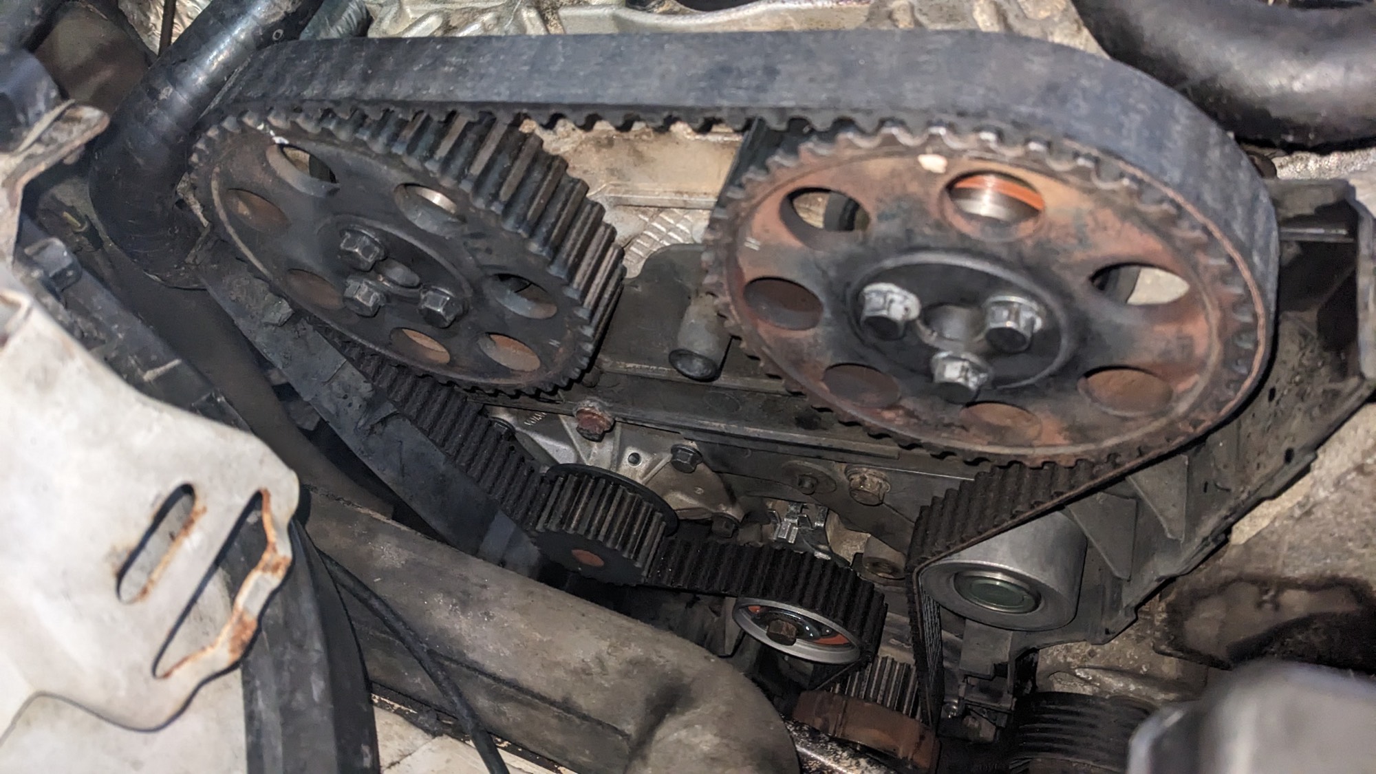

Intake seal was out. Exhaust looked to be moved a bit.

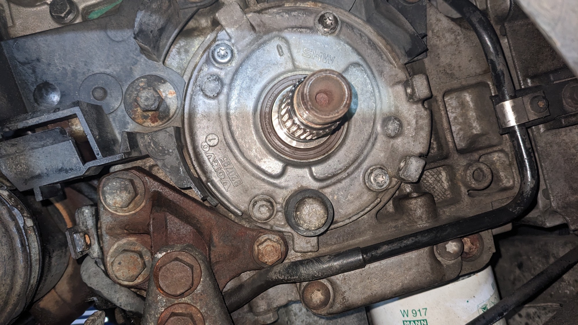

Oil pump was ready to start leaking very soon.
Lotta cleaning done first.
Back together. Did the tensioner and idler for good measure. Sitting for 11 yrs under tension running or not. No worries for 100k or 7, 8, 10 yrs? Cheap enough insurance. Oil pumps seals and FM seal off the worry list for a bit as well. I had the seals so $305 for parts.
