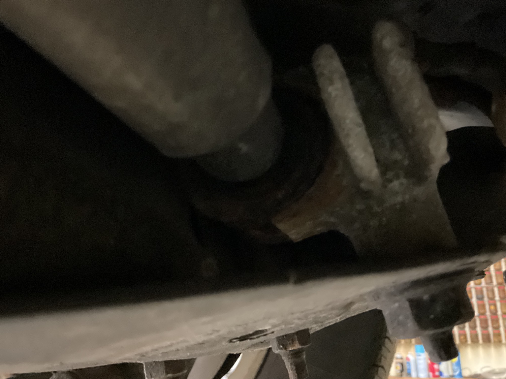

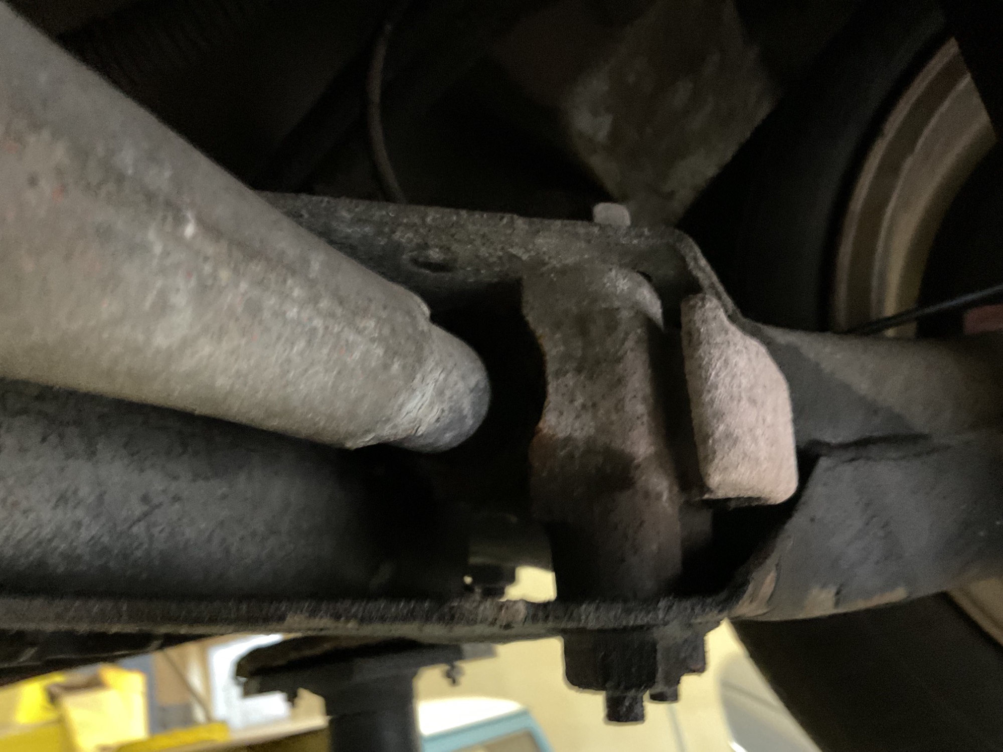

Thanks Matthew for fixing my subject line..more significant info is a plus I suppose. And thank you Neil. I went to Pelican and put one of those in my cart and signed up for my 10% discount on my first order but will need to wait until 10:00 EST to call them and confirm it is for real. As to the “chiralousness(?)” of the part, I am mentally referring back to a thread from the early 20-teens where Ozark Lee and madeinjapan were having the discussion and IIRC finally stated they were indeed different.
These are the two lousy photos I took yesterday while on the lift but perhaps we could come to some consensus on the “chirality(better?) of these parts. I’m thinking on quick examination they may be, but why would they be listed so often as different parts. And to add to the vagueness, FCP only has the 9181013 available and Pelican only offers the genuine Volvo 9181027, and only the Meyle or ProParts version of the 9181013.
It would be nice if the were actually the same part. Pelican has them listed for $84 and gave me a 10% coupon. If they have them it’s a nice savings but if they’ve different I can at least get the other at FCP. Lotsa hoping going on here. I will let y’all know what I find out. Let’s here thoughts on the photos. Sorry I didn’t provide better lighting.., stupid.

I have no idea what chirel? means. However, left and right are physically different. As to why many different part numbers I have no idea. There is a company in the UK that lists a bunch of different parts manufacturers for this part, many of which I have never heard of.

They're definitely different parts on each side. I just did this replacement on the 855.
