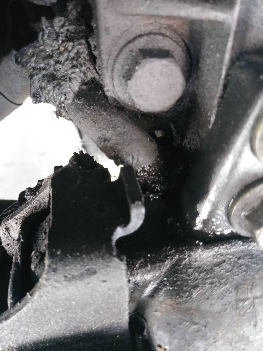

Did a little bit more looking around the fuel lines and yes, there were some plastic fuel lines. Lucky me, the leak was on a steel line, which had connectors at the ends and can be removed in one piece. Also found a RobertDIY video where he showed how to remove the line.
The leak is where the fuel line is sandwiched between the motor mount and the engine. I hit a deep pothole several months ago and pretty sure that's what caused this leak. The engine must've bounced and crushed the fuel line tucked under. Really strange way to route a fuel line but there must be some auto regulation that says fuel lines must be "shielded".
Here's the leak.

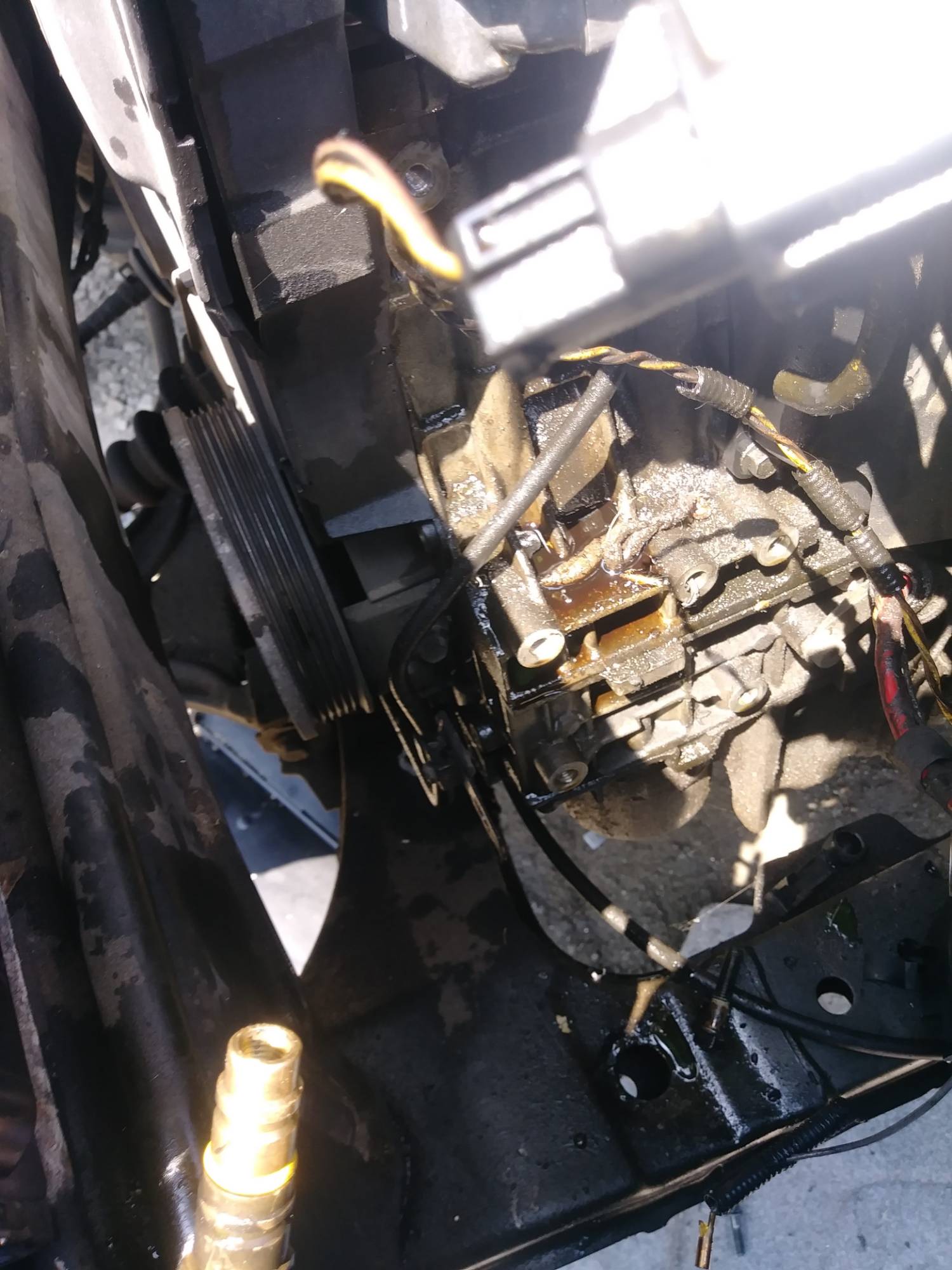

Went to the junkyard and was able to get one. Here's a photo from the junk yard where you can see all the stuff that needed to be removed to access the fuel line.
