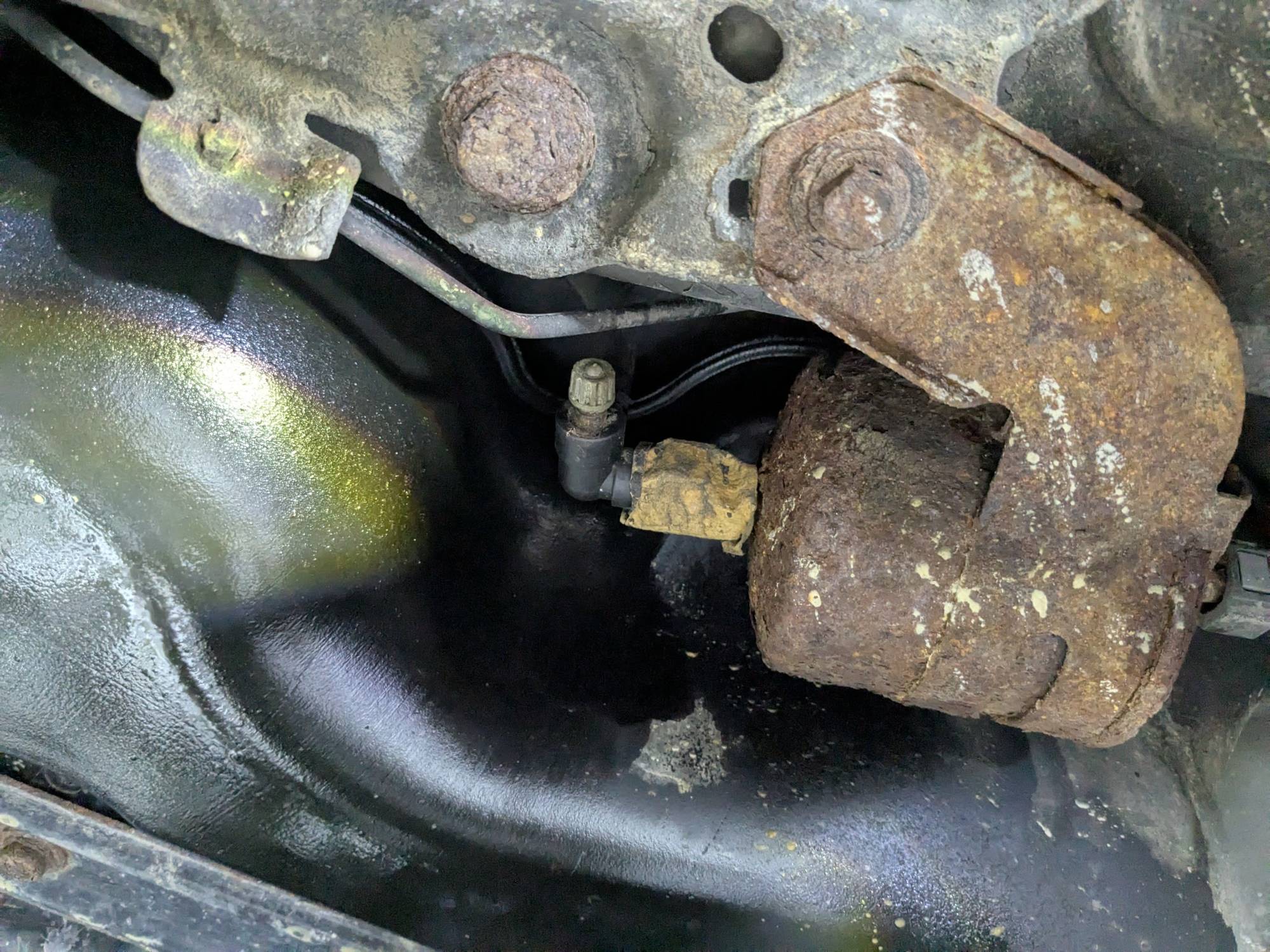

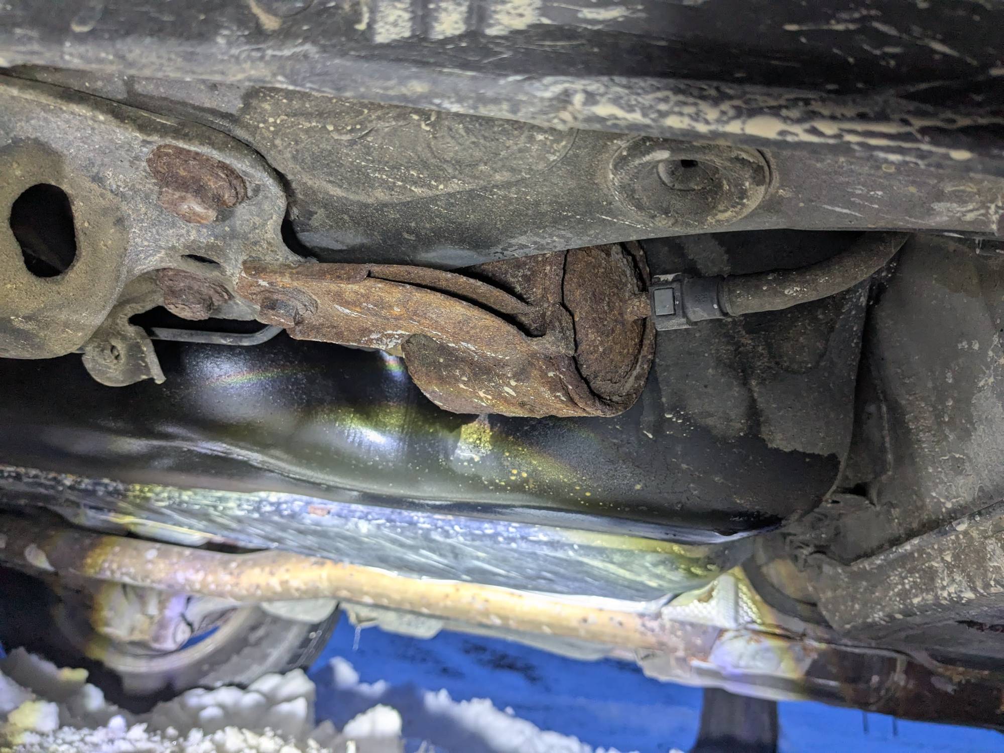

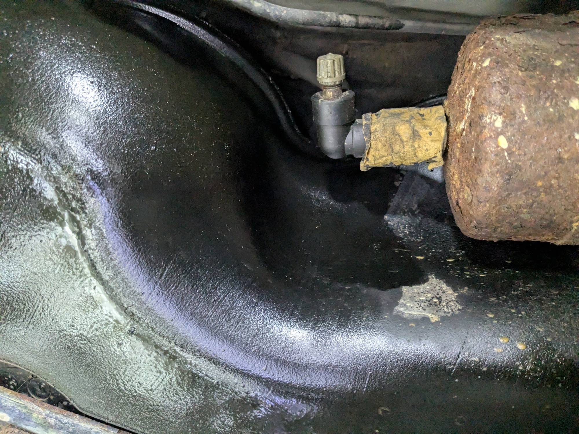

Per pictures below, my xc70 has a very rusty fuel filter under the rear passenger door. The yellow spot in the snow this afternoon (while shoveling the driveway) looks to be gasoline, I'm hoping from a pinhole leak in the rusty original fuel filter.

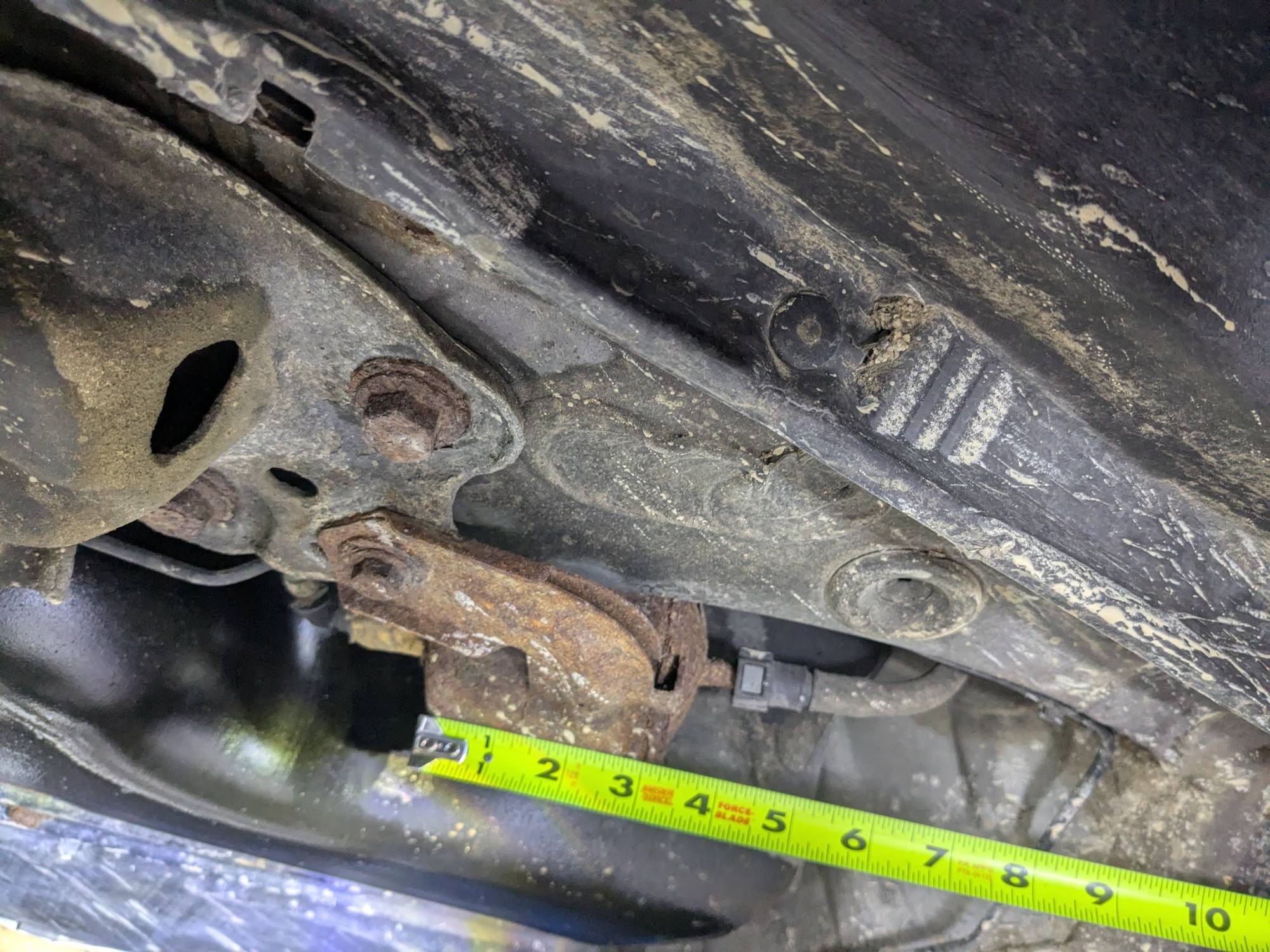

Filter body is about 3" long, so the 6" unit is probably standard.
This seems to match the smaller fuel filter that FCP carries https://www.fcpeuro.com/products/volvo- ... -8649630kt

It's good you have a bleed valve there to enable you to remove the line pressure. Start spraying those 2 connectors where the filter goes into them. My mechanic friend had a nightmare getting a similarly or possible worse filter off my friends 02 XC70. The connectors are a dumb design. You have to push the 2 buttons on at the same time. Problem was the lower clip gets all the debris from the rust into it which prevents it being compressed to release the connector. In the end he took a large pair of side cutters and cut the 2 pipes off the filter leaving enough to be able to grab with vice grips. Constant cycling of the clip and spraying with penetrant eventually, with use of a small pick, to move the lower clip got it to release. A lot of strong engineering words of persuasion were used in the process!
I would be more concerned why there is tape over that connector. It may have been previously damaged.
As good a reason as any to replace the filter more often in salty places before the filter gets crusty!
I wish you a lot of luck!

They come wrapped with tape to stop crud getting in! If it has a pinhole, you won’t need to relieve pressure, it’s self-relieved
