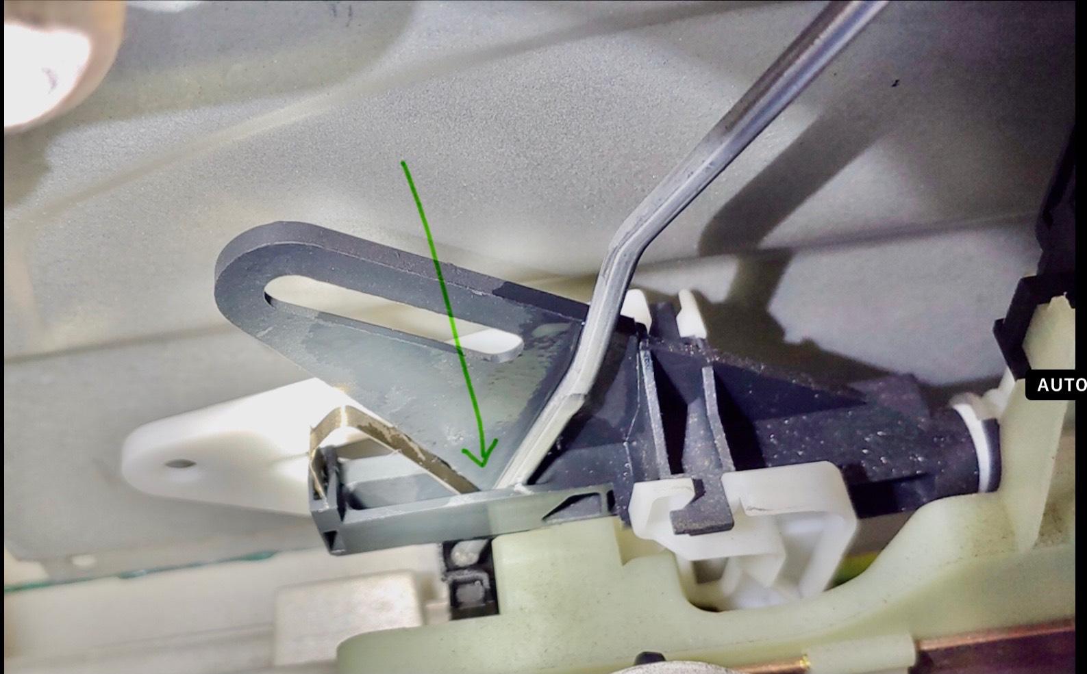

Hello,years ago I had the same problem,hard to open, I spayed wd40 to the latch and hand lever but the problem still there,so I removed the back door cover ,look inside and squeezed the hand lever to see which part is moving, and saw the flat spring had a friction contact with the rod unlock linkage,I greased Q-tip and smear it at the contact location between rod and flat spring ( the arrow ) and the problem solve still works til now , hope it helps..
