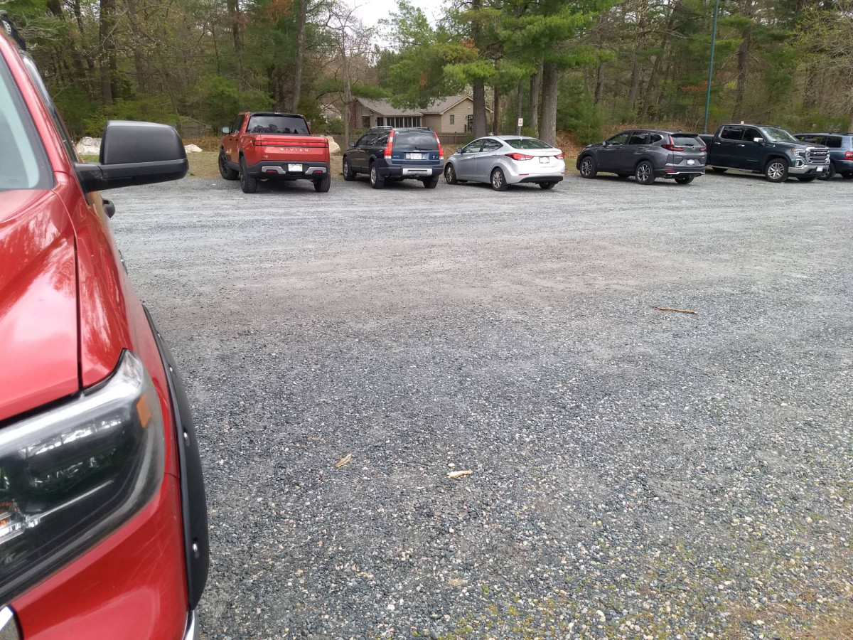

Was on a kid's soccer game yesterday, looked around and saw my 05 to be the only wagon in the parking lot and the only car that is actually older than ~10 years. It still looks sexy (and pulls like a rocket, but shhhh!)br0dy519 wrote: 28 Apr 2025, 09:46 Unfortunately the wagon is a dead/dying body type. Love living in a world where every single mfg has the exact same SUV.. boring.
I looked at the Audi Allroad a couple months back but the carbon buildup requiring walnut blasting scared me away.
