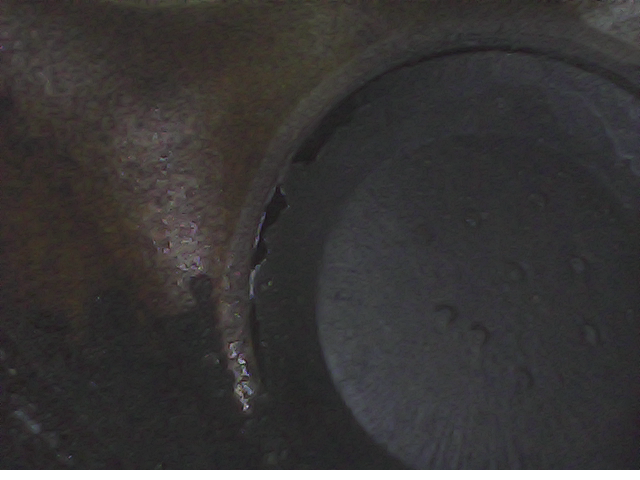

Update as of now:
got myself a cheap boroscopic camera, put it into all the cylinders, and lo and behold, a chipped valve, pic below.
Now i'm going to take off the head and order the parts. Also, all of the lifter except for one, which is collapsing a bit, but not enough to f a valve up.
