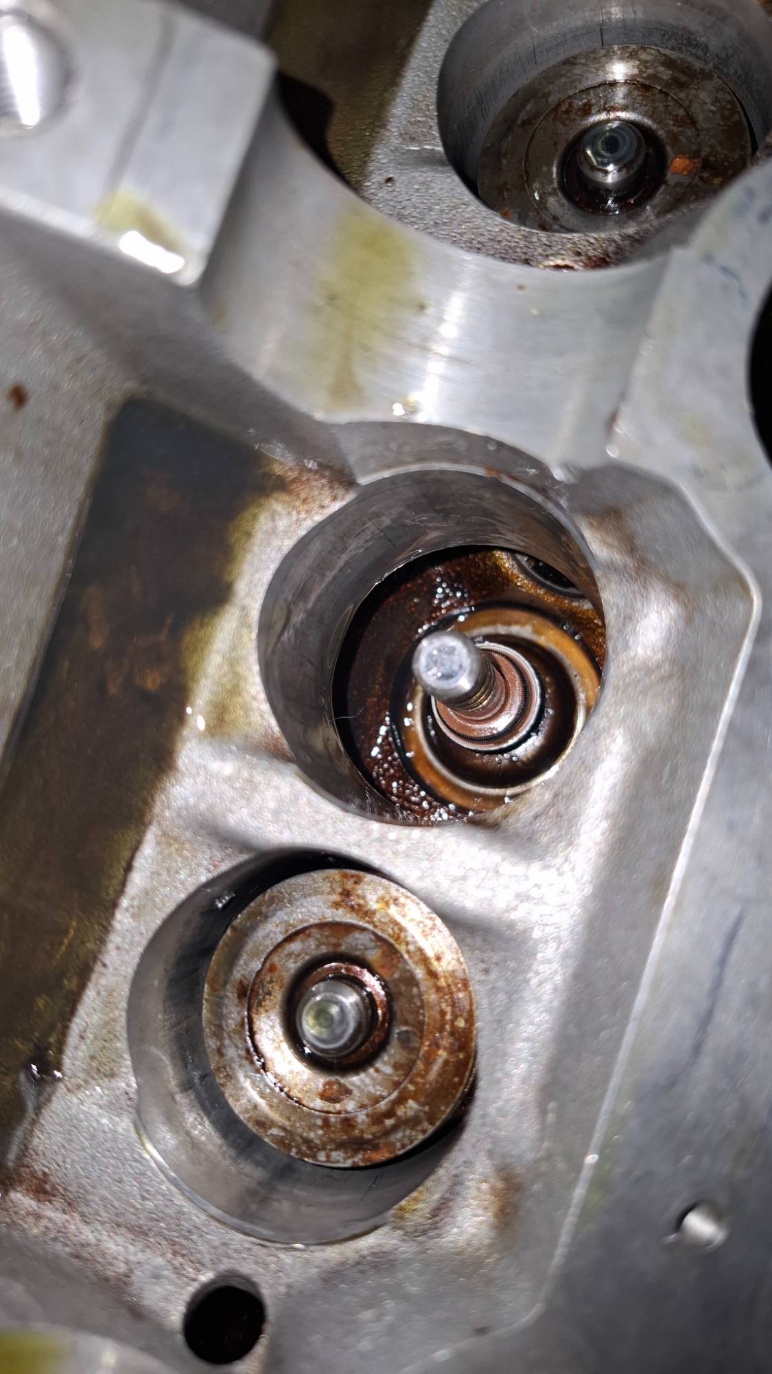

So, after putting everything together, cars starts normally, but all of a sudden a cloud of smoke started to come out of the exhaust.
After a little digging, i stuck a bore cam inside the cylinders and found some oil resting on top of the cylinders and on the cylinder head and valves, and when i put the camera inside the fuel injector ports, voila, a literal PUDDLE of oil resting on top of a closed valve.
Since theyre the only thing left untouched, i'm quite sure is the stem seals.
Now, i've already taken the cam cover, cams, lifters and stuffed #1 with rope, as per tutorial.
My question is, could it be something else that i royally screwed up doing rebuild? piston rings were all clocked at 120º
And yes, my back and i definetly know that i should've done that when the head was off, gettin' Mike Tyson'd would hurt less

How much over spec did you hone the cylinders? Did you order oversized rings as a result? Rings should be staggered during installation.
Did you have the head rebuilt because it sounds like crap valve to seat mating and thus leaking. The valve stem seal is likely just showing you the result of that when we're talking this much oil. Were the rings installed in the correct order? Specifically the oil control ring?
If it were valve stem seals most of the time you'll only notice a puff of smoke at startup.

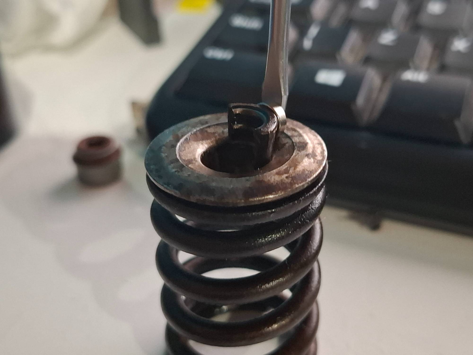

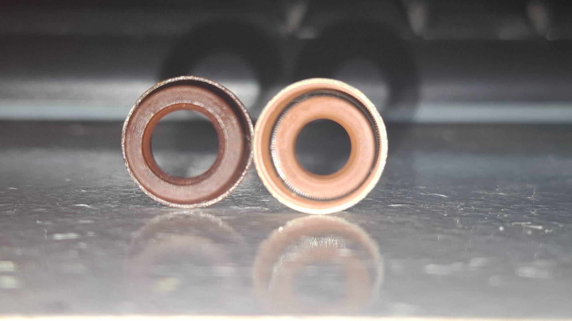

After removing the lifters, disassembling 3 valve heads with the rope method, i took the seals off and all of them look very worn down, with the hole about ~1mm wider than the new ones, having no proper seal with the valve stem, here are some pics of the old one vs new and new stem seal installed.
Old one/New one

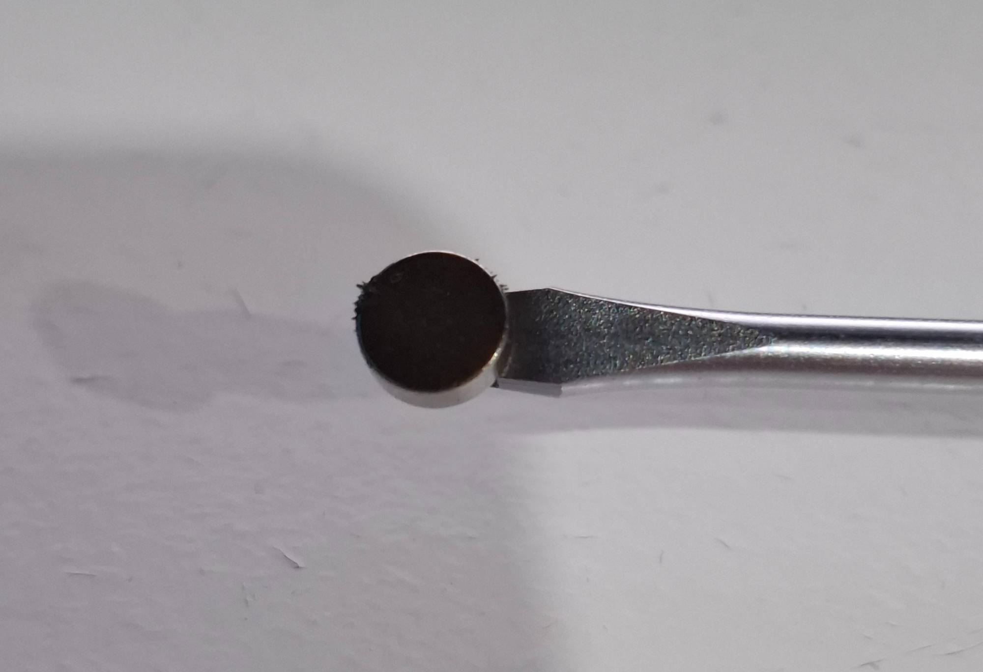

Also, to make the keeper job easier, i bought a pack of 10 2x6mm neodymium magnets, which i had one on the tip of a flat screwdriver, pic below
i then used this screwdriver/magnet to hold the keeper while i maneuvered it around the valve head without the risk of it falling somewhere.
with the keeper on place, with the magnet still attached, i slowly released pressure on the spring, letting it rest on the keeper, then did the same thing on the other side
still gonna come back with updates after i change them all
