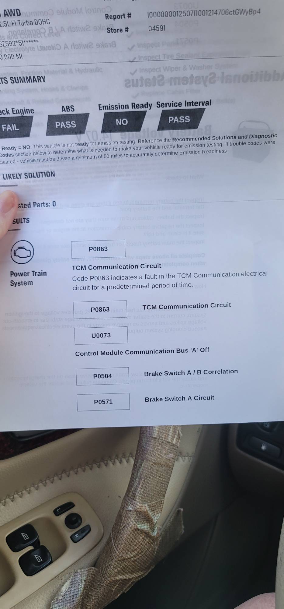

ImageI've had this car as a daily driver for a while with no issues. But in the last couples weeks I've had several instances where after I've been driving for a while, like running errands, I'll go to start it and I will have no dash guages or turbo. Car runs fine other than that. If I unhook the battery, reset it, back to normal. I haven't figured out why it's happening either. Like, every time it rains or if I run the ac, there's no thing I can pinpoint.
It happened the other day while I was driving, which has never happened before. It's always after it's been turned off and I go to restart again. But anyways, I keep driving, no big deal. All of a sudden it kicked, almost like I hit something, and everything turned back on.

No codes set? Welcome to MVS, Amy.

Idk??? The first time it did it, my mechanic met me and did the battery thing, so that's what I've been doing. I didn't even think to have them run codes when I was at autozone last week getting ac stuffs. I feel like if I make them go outside in this heat I'm going to have to take them cookies so I don't feel bad.

Codes are going to point you in the direction, readers are relatively cheap today. Less than $200.
