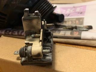

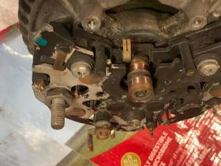

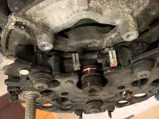

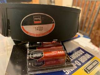

Remy rebuilt alternator:
Volvo alternator/regulator/brushes
Remy alternator label and regulator part number(s)
The Volvo alternator/regulator has much more wear than the rebuilt unit.
