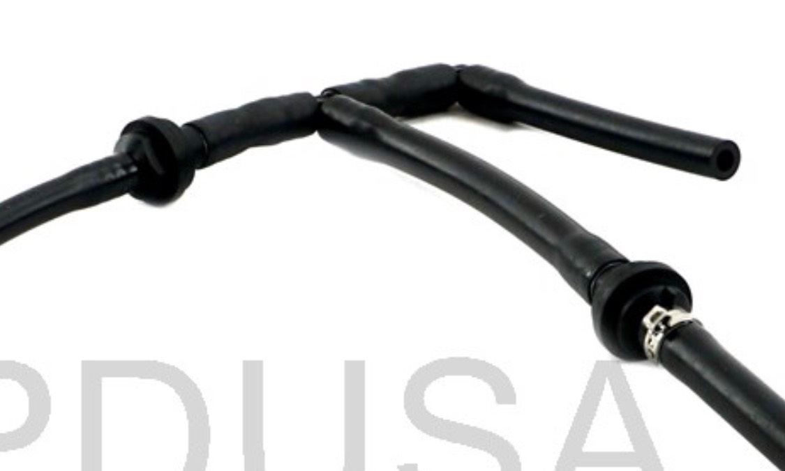

Hey all, a bit stumped trying to find a part number. Did an oil change on the kids 2002 S60 FWD 2.4t this week and found one last vacuum line that the rubber was pretty terrible.
Replaced this line that goes back to the intake tube nipple with a piece of standard fuel hose from my local farm supply store. At startup it idles terrible. New symptom since replacing the line. Runs fine once off idle. Disconnecting the hose to intake makes idle stay the same so I suspect this little fitting/valve is bad. I’ve looked on FCP and the Volvo parts fiche with no luck. Idiot part guy at Volvo dealer said to get number off it which Google is not finding - pa66gf30 and 01T2. Anyone replaced this guy and have a part number? I’d be super thankful.

I sprayed it out withbrake cleaner, run compressed air from either direction to free up the one way valve.
That check valve comes as part of a hose assembly, $80.
Its becomes sticky, just clean it.....or pay up.
https://www.ipdusa.com/products/57054/3 ... t-30757307
another option $30
https://parts.prestigevolvo.com/p/Volvo ... wyuvFOTab8

Excellent, yes this looks to be it. I saw this assembly but was not 100% sure.
After some searching on Amazon I came across a Motorcraft YG-360 that looks to have the same fitting sizes. For $7 worth a shot if the one-way is in the right direction.
