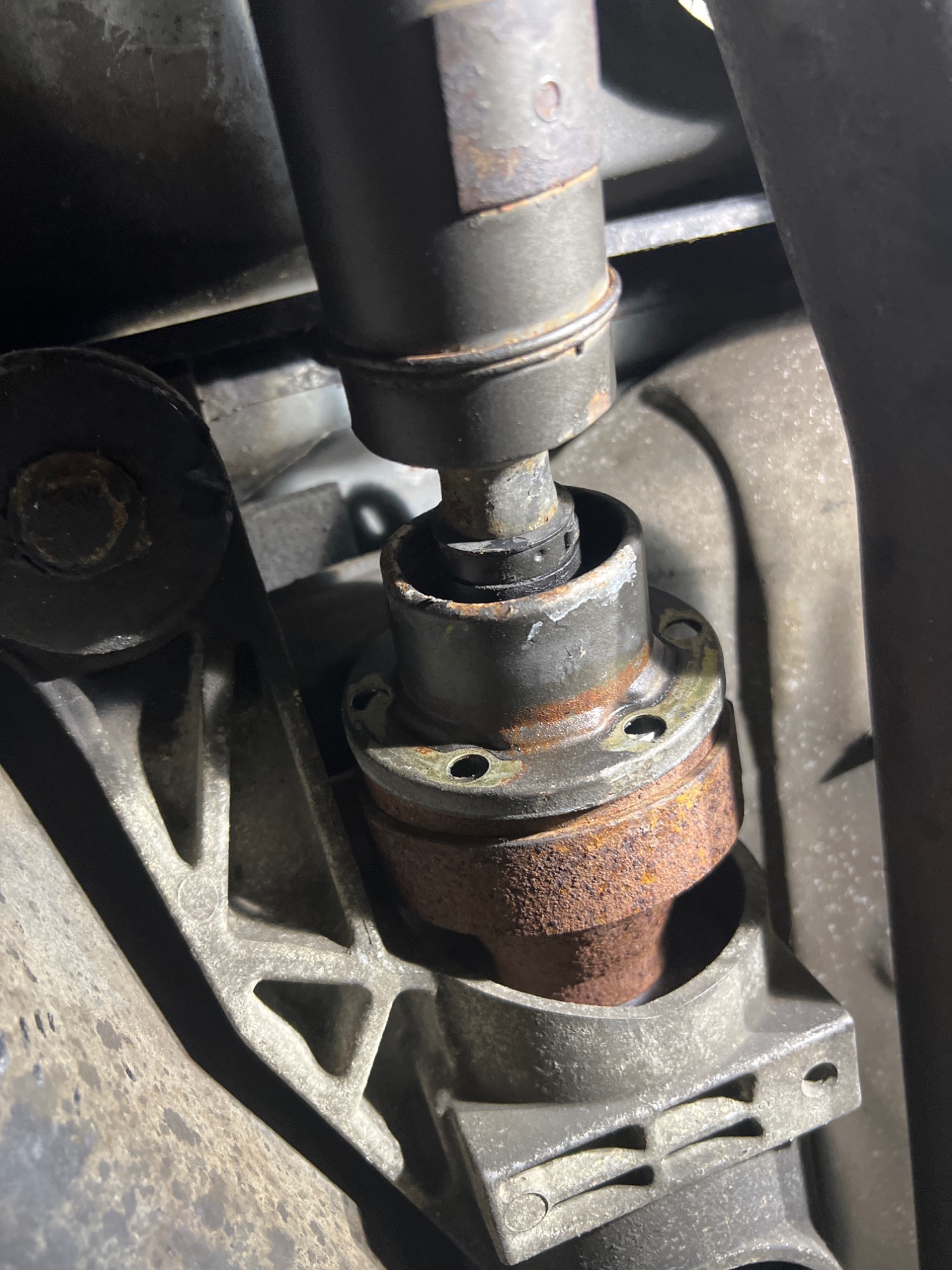

I’m in the process of removing the rear propshaft and viscous coupler to gain the access needed for a variation of the dank drop method for replacing the fuel pump, and have gotten half the propshaft out, but the end in the VC is stuck fast…
Any ideas?

Update: eureka! After an hour of spraying with free-all and using a hammer and chisel at an angle towards the front of the car, it came free!
Will be adding this to a write-up about the fuel pump replacement procedure

Those can be tough. It might be seeing daylight for the first time since Goteborg!

Given the rust, the stubbornness, and the state of the half-disconnected carrier bearing, I believe you are correctabscate wrote: 24 May 2026, 04:30 Those can be tough. It might be seeing daylight for the first time since Goteborg!
