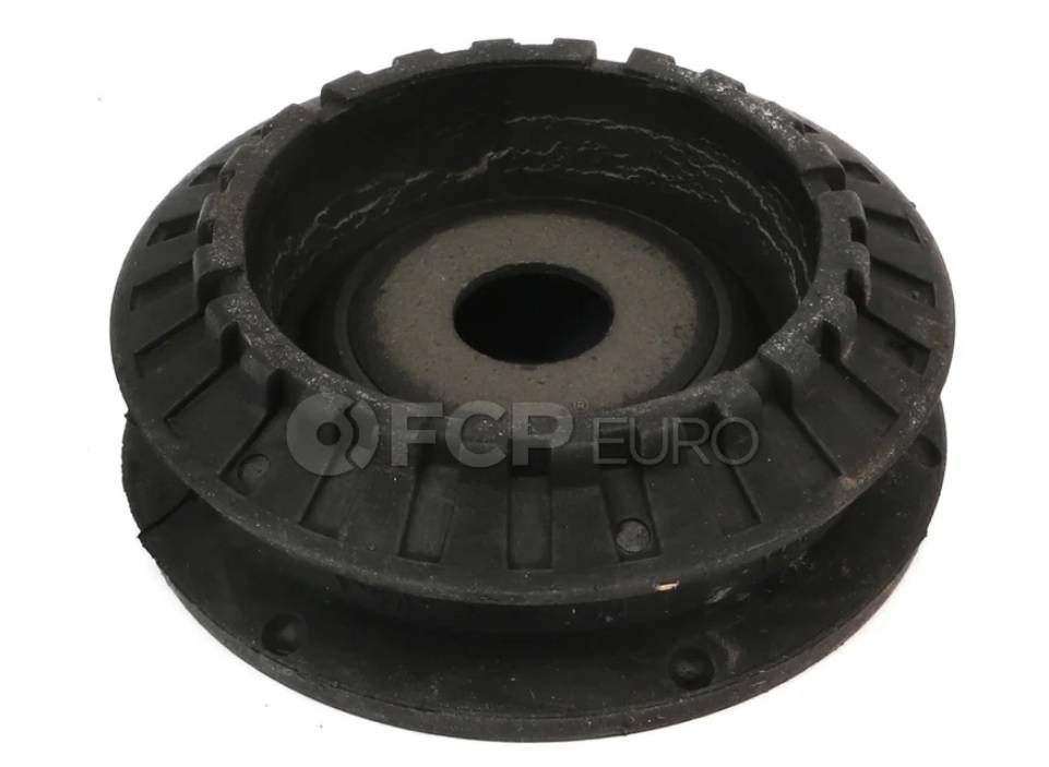

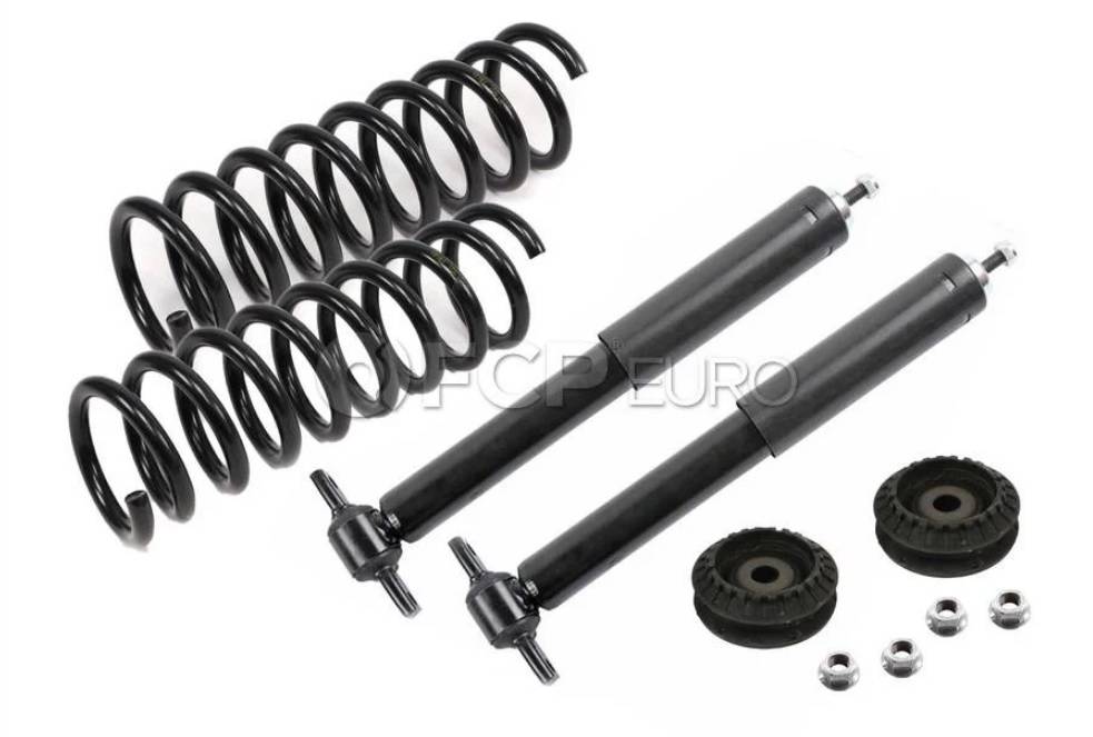

- Volvo kit
- FCP-NivomatConversion.jpg (50.16 KiB) Viewed 541 times
- Volvo shock mount
- Volvo-ShockMount.jpg (36.2 KiB) Viewed 541 times

I used both pieces of the shock mount that came with the car. one goes on top of the shock. the other with metal on top of the subframe. my video in previous post shows both on the IPD shock with the lock nut on.
Not sure exactly which spring it is (attached a picture of springs side by side). It is thicker coil. same length, but seems a lot stiffer.
IPD conversion shock doesn't have much of stiff ness, I can extend it and retract it with a little force. It doesn't move fast. Just slow.
