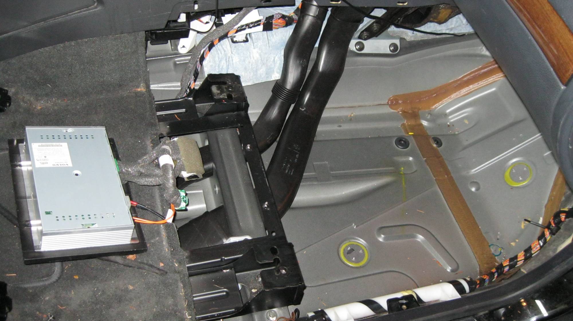

Has someone removed the carpet floors under the front footwells and validated that the smell is not coming from the structural foam floor or below it? Not to be confused with carpets being wet, this is the residual smell and the foam itself will need cleaned and treated.
See photo (from my old 5 cylinder), this is the area you want to expose and it's the part that you'll remove that is the focus (you'll see something on the floor maybe to validate but it's the foam you'll want to check). Driver side piece is more or less the same (less the amplifier). Pull both sides to be sure.

Cabin Filter - NOT a stupid question. It was pretty new, but I did remove it as I wanted to treat the vents. I've put them in recirc while the chlorine dioxide was in the vehicle, and I've got some spray I'm going to put in this weekend. I've got a new FCP hepa filter I'll put in at some point after I diagnose what's going on.
Carpets - Have not lifted them yet. What I've read is that the sound deadening asphalt adhesive is the main culprit of the "crayon" smell. However, I read that the foam underlayment that sits above it will absorb that and continue to off gas even after the sound deadening material is removed. Yikes. Anyway, it's worth peeling them up and taking a look for moisture. The blacklight idea mathew1 had was good, and I need to do that also.
