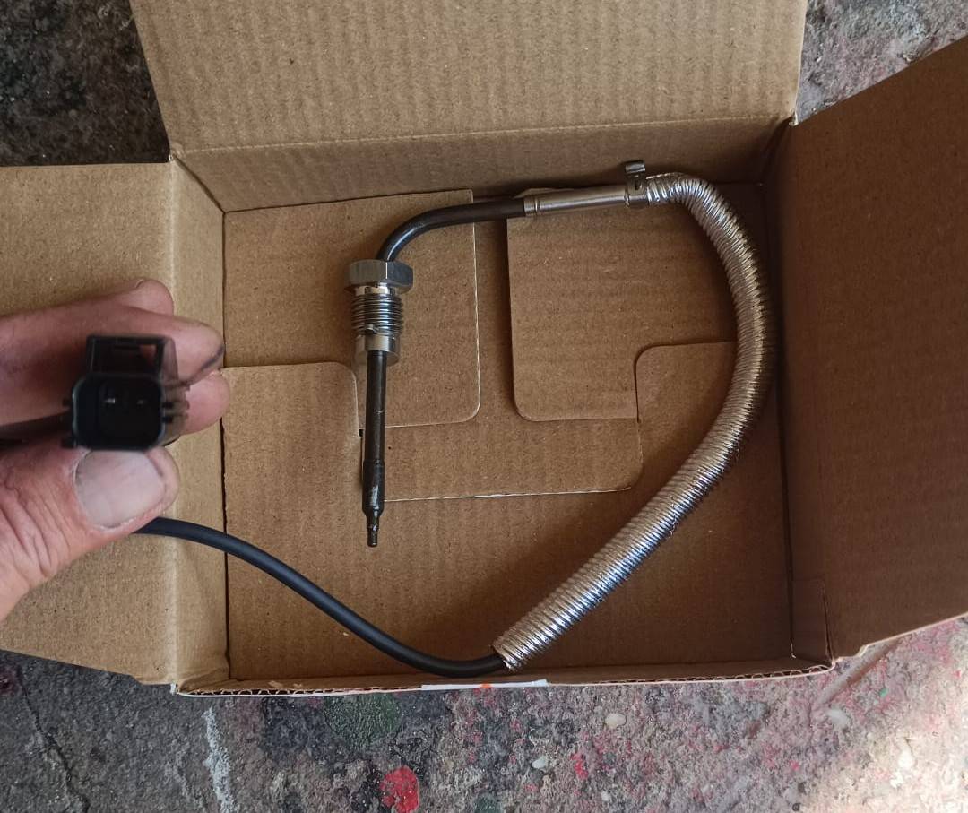

Let me share why I got so mixed up with this. When the P0427 code first appeared, my cheap Aliexpress OBD2 reader did actually tell me it was the catalytic converter temperature sensor (the one accessible from the top). However, while I was under the car in a pit one day, I noticed the temperature sensor going into the DPF. It had soldered wires, and based on the part number, it was a cobbled-together Fiat/Alfa Romeo part!
When I unplugged this bottom sensor, the code immediately flipped from "low input" to "high input". Because of that reaction, I was convinced this bottom sensor was the culprit, so I went ahead and replaced it with a new NRF 707206 sensor. Obviously, since it was the wrong sensor for this specific code, it didn't solve the problem. Visually, the wiring for the top sensor looks completely fine too, and there are no leaks around it. What would you advise my next step should be? Should I take it to an auto electrician to properly test the harness, or should I just go ahead and replace the top sensor? If I should replace it, do you recommend a specific brand or part number?

At first, I replaced the lower sensor (the one accessible from a pit that had the soldered wires). Because the P0427 code flipped from "low input" to "high input" the moment I disconnected it, I focused all my attention on that bottom one. I see now that I was misled and shouldn't have focused on it.
So, turning my attention to the correct upper sensor near the firewall: what replacement do you recommend? Do you happen to have a part number or a specific brand you trust for this top one?

I actually just got some help on a Swedish forum where someone looked up my specific VIN. It turns out my early build needs part number 31370469, so I'm going to go ahead and order that one.
