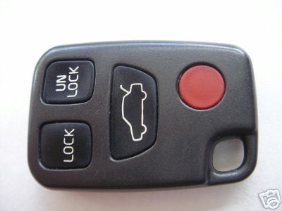

What are these "Numbers" that you and JRL keep bringing up?MadeInJapan wrote:Mine is the same one with the same number. There were only a few of these (looks identical) but with different numbers, so make sure yours matches (one off) the receiver like I said before.
I've talked to several dealers over the years about the"98-"00
keyless entry remotes and the answer is always 9166200.
The only other number is the FCC part#.
If THAT varied and made some significant difference,
why wouldn't Volvo use a different P/N ?.

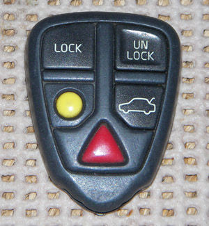

Thank you everyone for your responses. This is a photo of the remote I was given when I bought the car, and I am sure it is not the correct one, as the dealer has said, and also by the fact that the #s on the back are not even close to the #s posted. I have found a couple of remotes on ebay that look like the one in the photo posted by BEJinFbk. I think I am going to take my chances and get one of the ebay remotes. Keeping my fingers crossed.

Yes, that's not the one....you're doing exactly what I did when I bought my S70, but the one I got was a second one (I already had one) so I had the numbers to go by....but for your '98 Volvo, it appears that the remotes all have the same FCC number so I'd say it's a good gamble. Keep us posted how it goes.
