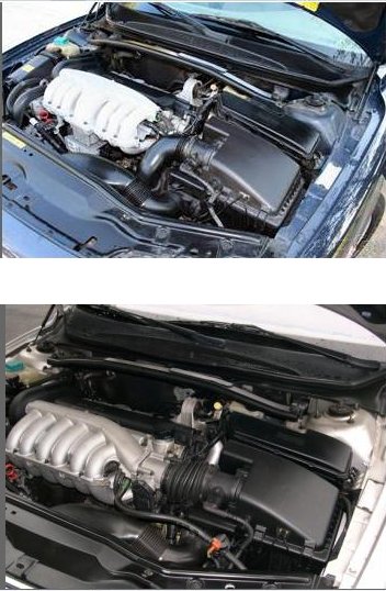

2002+ 2.9L i6 has the ETM right next to MAF. It's even easier to clean.
- 2001 2.9L non-turbo vs. 2003 2.9L non-turbo, intake design changes.
- s80_intakes.jpg (55.4 KiB) Viewed 12142 times

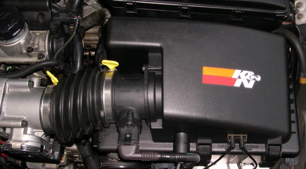

Here's a better (and more recent) pic of my 2003 2.9L non-turbo. I'm also using some quick release hose clamps they sell at Pep Boys -- I hate that place but they got the cool clamps.
I'm so glad I don't have to mess with all those hoses like you turbo guys.

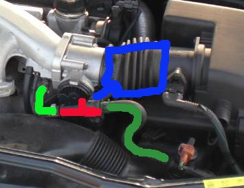

As a side note, the problem I'm having with my 2003 that inspired me to use quick release hose clamps was apparently addressed in the 2004 model year, see pic below. The oil/fume separator/trap occasionally burps up oil that builds up in the flexible rubber tubing between MAF and ETM. Then under hard acceleration it sometimes takes a big gulp of it, fouling plugs and O2/lambda sensors. In the 2004 model they added another hose to drain that exact area. What a coincidence.
I'm wondering if I can adapt the 2004 design to my 2003. I think I just need to swap two parts, everything else looks identical.

If anyone is parting out a 2004 S80 2.9 liter inline six non-turbo, I need the following four items:
1) rubber tubing between ETM and MAF with nipple my 2003 is missing
2) plastic T connector that nipple plugs into
3&4) two small hoses on both sides of the T connector
I've highlighted the parts in pic below. Don't need the clamps on left hose (cut them off if you like) but could use the green one you squeeze on hose to the right. Email me at admin @ 4crito.com with quote.
EDIT: Or feel free to leave the hoses connected if it's easier for you. Shipping box will have to be bigger and I'm going to take it all apart anyways, but whatever... I'm not picky.

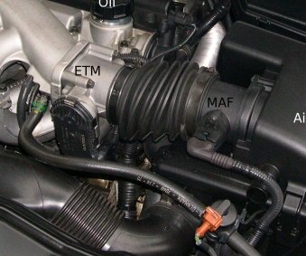

Here's a close-up of a 2003. I believe the 2002 2.9L NA is identical, so the retrofit should work for that model year too. Just remove two parts and replace with four (highlighted above). Should take all of 15 minutes.
- 2003closeup.jpg (26.08 KiB) Viewed 12373 times
