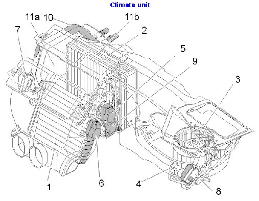

I have a Volvo S80 T6 1999 and the cabin fan rotor just stop work.
Fuses are fine... I tri find de cabin fan motor but i dont now were is located??
Can some one help me please to find this ??

Not sure if your car in Brazil is left hand drive or right hand drive. Either way, it's on the opposite side of the driver's side (left in the U.S.) and under the passenger side dash. There is a panel you can take loose that reveals it (#3 below):
S80 Climate Control.jpg (52.69 KiB) Viewed 558 times
