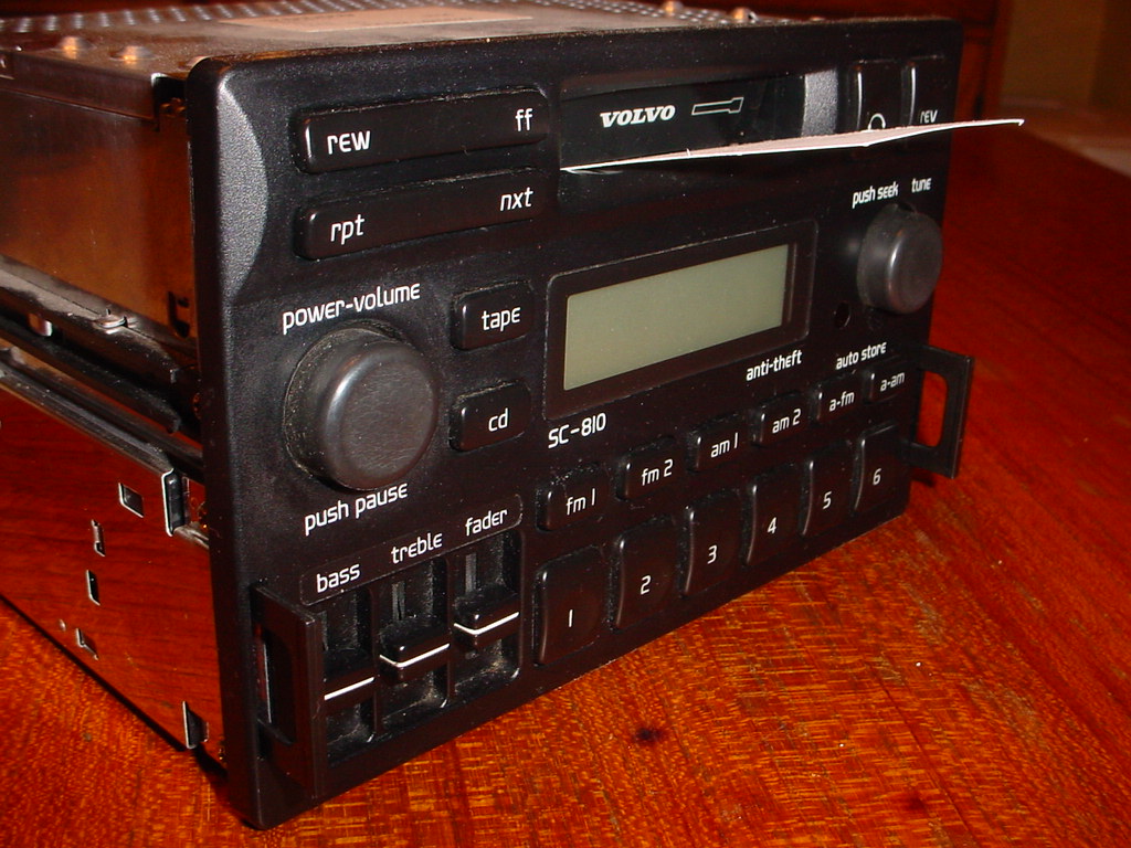

I have a nice SC 811 (812)? AM/FM Cassette out of a 96 850 for sale.
Excellent working order and in excellent cosmetic condition with all lights working with code
for $30 plus shipping
I can box and send it out tomorrow with a Pay Pal payment

dimasp wrote:I have a '95 - 850 with the original radio, do take it out do I need any special tool/intructions ?
Thanks
Dimas!
I use my key to pop it out. There are a couple of tabs next to the bass control and the preset number 6. Just push them in and the the handles will pop out. You will need to know your code if you disconnect it.
