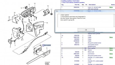

Unfortunately, I think they are correct. Here is what VADIS shows:
You might try http://www.vandsautodismantlers.com or http://www.erievovo.com to see if they have a good used handle they can sell you.

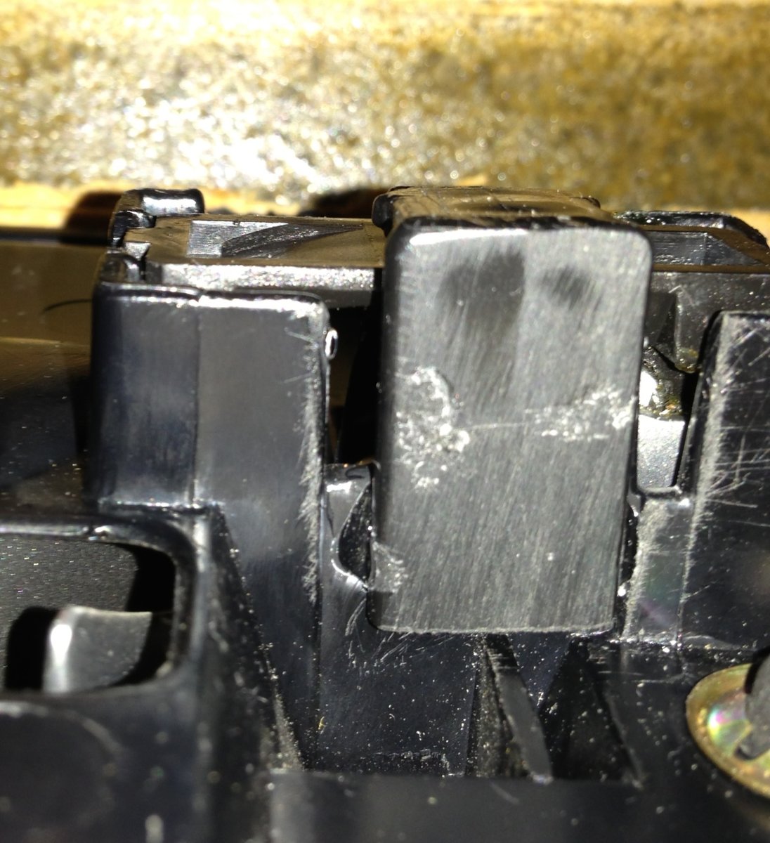

This happened to me yesterday and I wanted to add to the possible solutions to this problem. I 1st tried the steel wire solution but didn't like the result. My fix requires Loctite two part plastic glue and a small angled piece of plastic. Finding the right piece of plastic might be the hardest part. I cut the angled pastic down to .875" and glued it to the outside of the broken clip as pictured. The bond is secure and permanent but if I ever have to take my door panel completely off, I am able to remove the door latch with minimal damage.

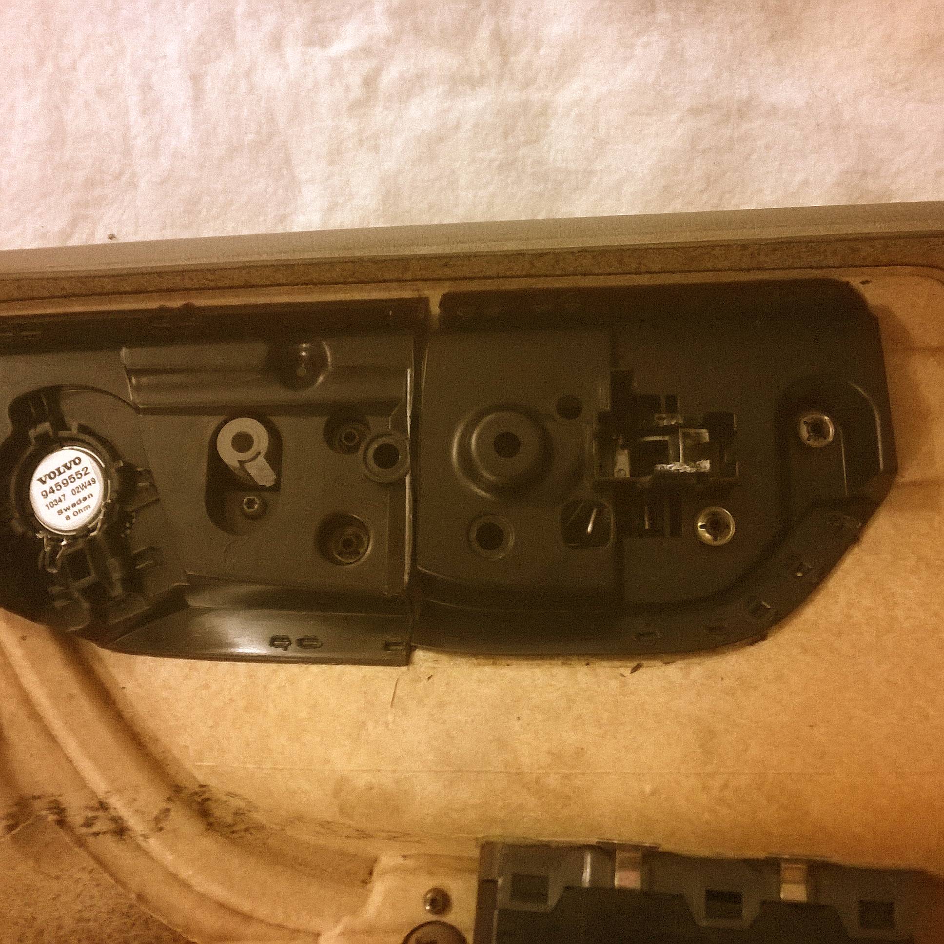

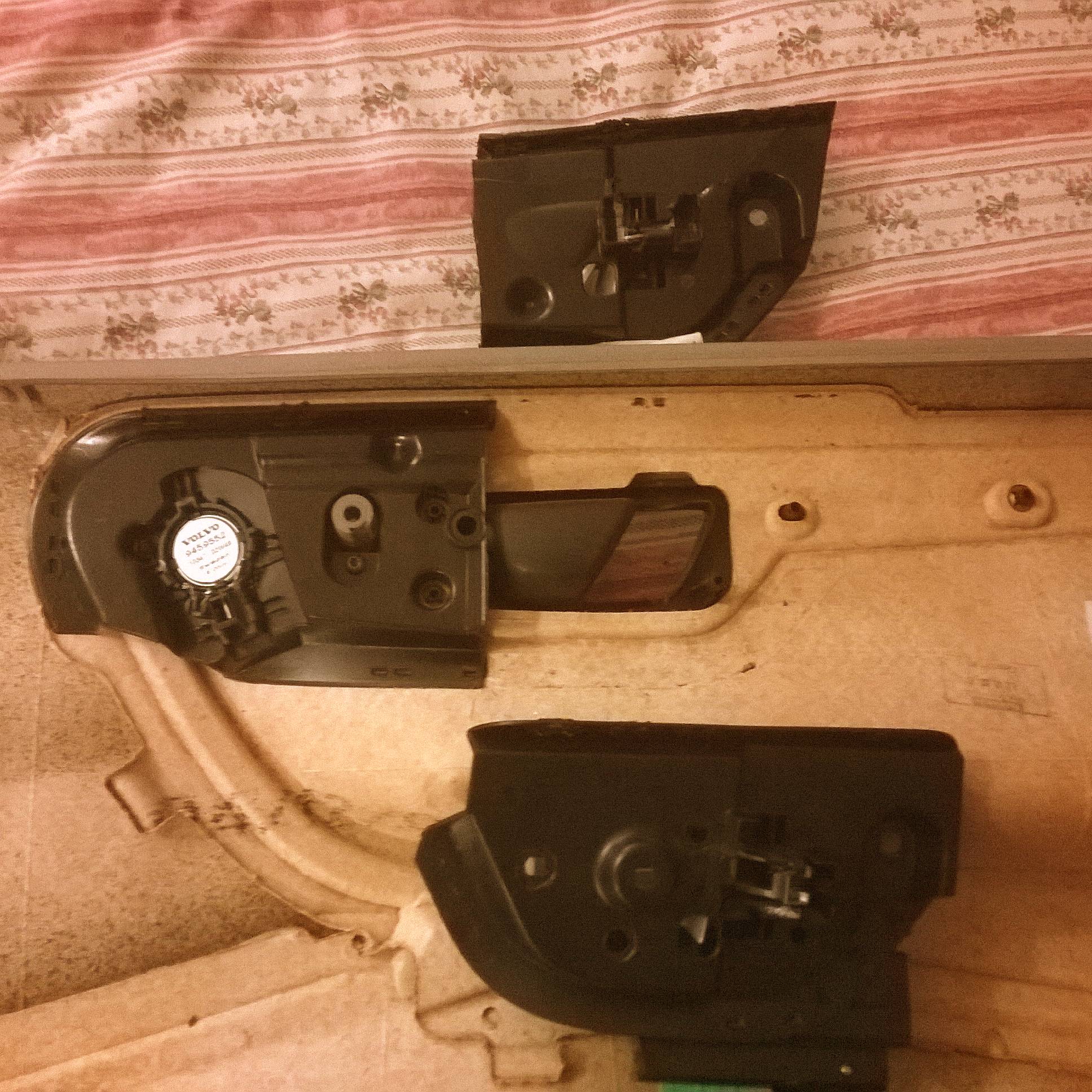

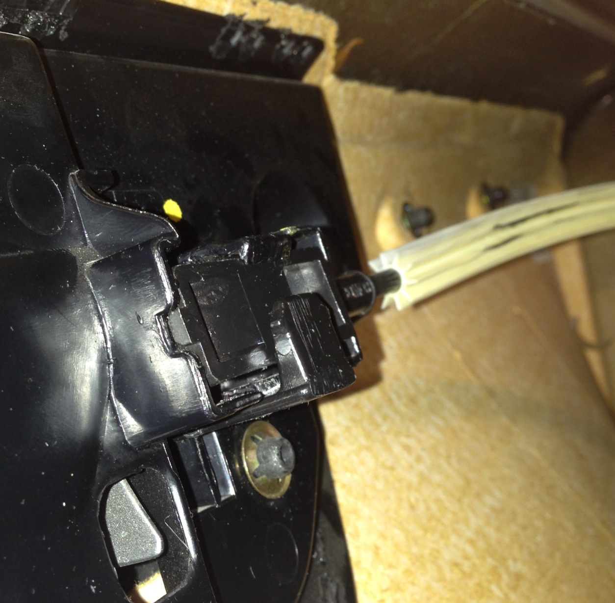

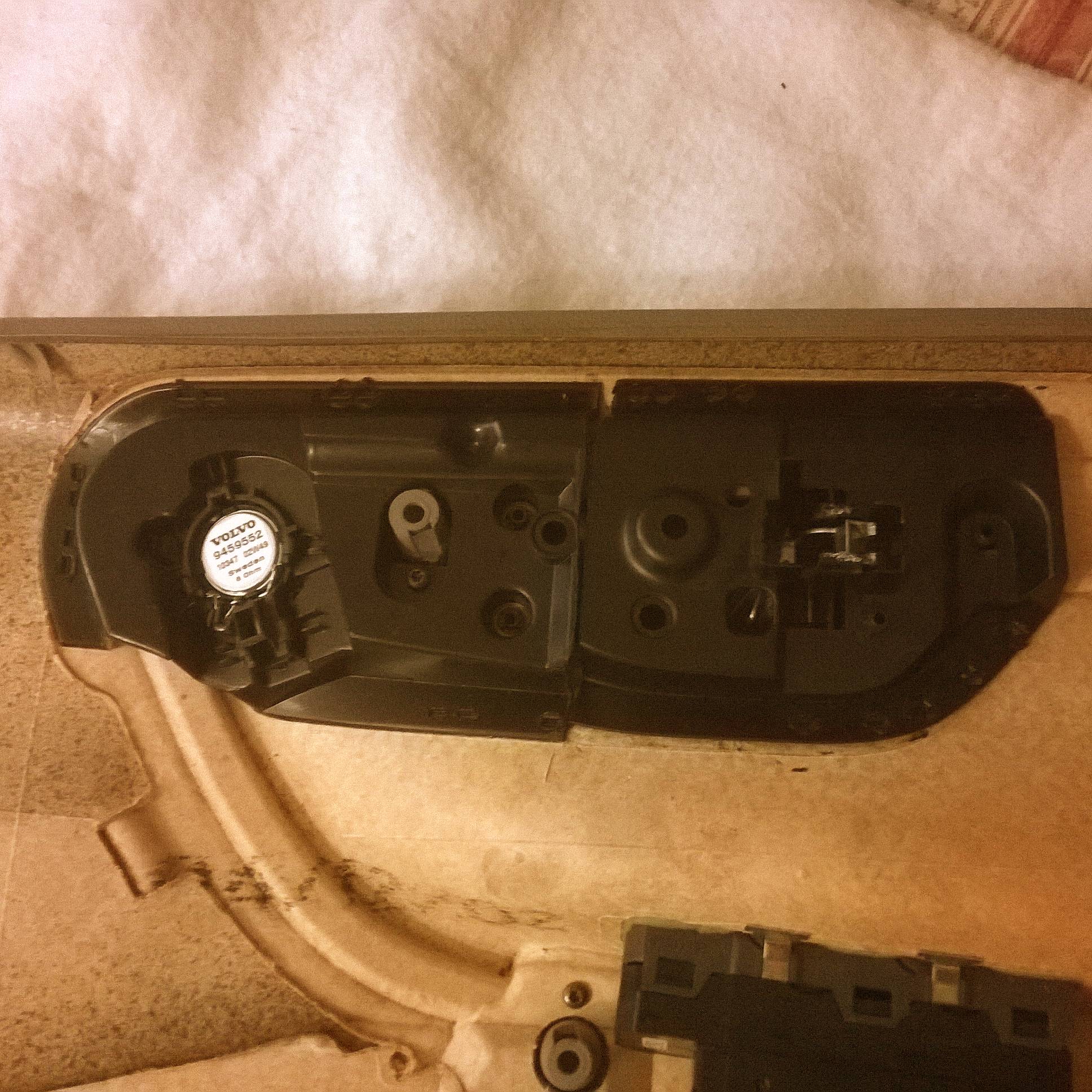

Been there - twice! The first time I went to the P-n-P and bought a complete door panel, brought it home, removed those ornery clips, then carefully pried the handle assembly loose from the inside of the panel. Then I did the same with the good door panel, removing the broken part. Then I epoxy'd the new handle assembly to my door panel. It worked for maybe 6-8 months then broke again. So this time I did the stainless wire fix. The photos show two tiny holes drilled on each side of the part with the wire fed through and twist braided. I probably flattened each of the wire loops down against the inside of the part with a tiny screwdriver so that there wouldn't be any interference when pulling on the handle. Unfortunately I don't have photos of after the cable was latched in, probably because I didn't have a free hand. Anyway, I'm guessing that once the cable was in place I must have just brought both wires up over the top and twisted them down snug. I took these pix about a year ago when I did the fix and the photos have lasted much longer than my memory.
