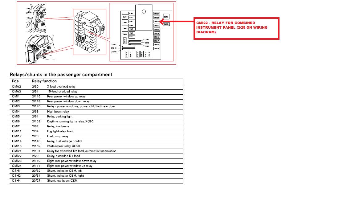

Post by vegasjetskier »
There is also a relay that feeds the instrument panel on the Central Electronic Module, which is up under the dash. Here's a diagram showing the relay location:
