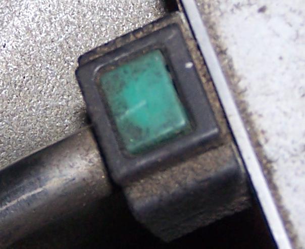

In the process of changing my oil trap and have encounter a fuel line under the rail which is black rectangular with two small green rectangular buttons on each side.
How the hell do i get this off. Any help please

Found out that the piece in the picture measures fuel pressure, Still have trouble on how to disconnect the fuel line.
I am at a loss, could use some help.

You need to push the green tab on top and bottom and the same time while pushing the fuel line toward the connector. If you dont push the line slightly forward while trying to remove, sometimes it will not release. Dont pull back, push forward while removing, that should do it.
