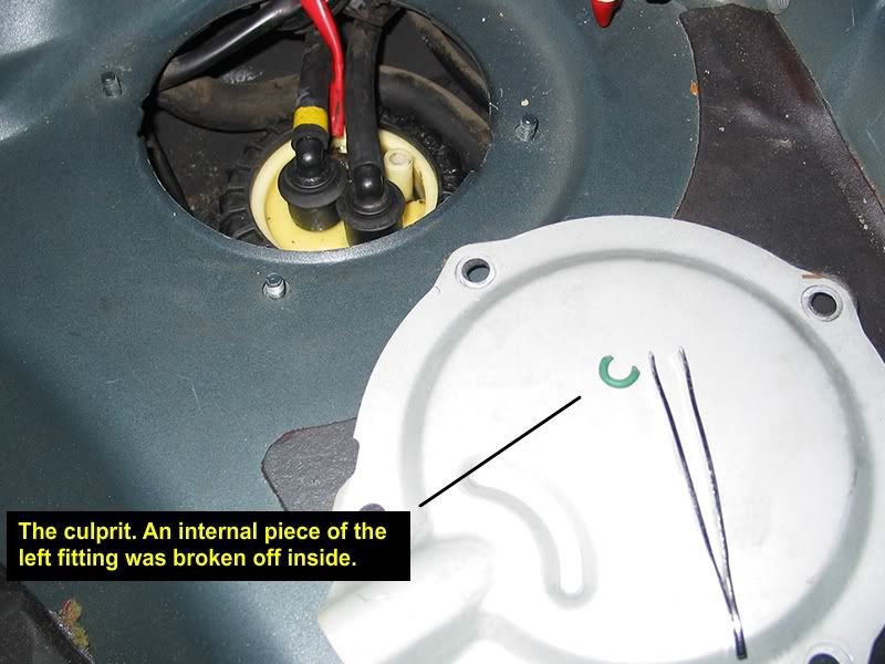

Hi guys. First post on this forum. My 1994 850 Turbo was running great and one day just wouldn't start. Someone told me to smack the bottom of the fuel tank with a hammer and see if the car started. That acutally worked once so we decided it was a bad fuel pump. Well, just finished replacing the fuel pump and the car runs great! Only problem is, gas is leaking from the fuel line connector at the top of the fuel pump. This was not a problem before installing the new pump. I am worried I wrenched on the connectors a bit too much or something? Seems like they pop off a bit easier now than the first time I tried to pop them off. Or... do you think the leak is happening because I do not have the metal cover bolted down over the top of the fuel pump (see photo)? Is one of the jobs of that cover to press the connectors down? That doesn't seem like its job but what do I know.

Thanks for the clarification about the metal cover. Concerning debris in the fitting, I have checked and checked and checked and I can't seem to detect anything wrong with it. I wonder (if need be) if I can buy new fittings from Volvo or somewhere. They just don't seem nearly as snug as the first time I tried to take them off. The first time I removed the left gas line fitting (with the yellow band) I noticed a tiny piece of red plastic or metal fall out. Apparently a piece from within the fitting. But upon inspecting the fitting and comparing it to the other fitting I cannot see anything missing or out of place. Sigh. What a drag.

Thanks. It might just be my imagination but the left gas line fitting (yellow band) does not seem to sit as low as the right fitting. I am very reluctant to force it down as I have applied a lot of pressure already and don't want to crack the plastic. There are no cracks or breaks in the plastic that I can see. Unfortunately, I did not install a new rubber seal. I will do this ASAP but I am nearly certain the leak is coming from that left gas line fitting. I can't see any obstructions inside the fitting or any reason why it would not seat all the way down or seal tightly. I've tried tapping it, pushing on it, twisting it gently from side to side to get it further down but it seems like it is as far down as it wants to go. Hmm.

This might be some kind of record for first time poster problem already resolved. lol. Hey thanks guys. Really. The left (yellow) fitting had a kind of green rubber 'spring' looking thing inside, just like the right fitting. But... for some reason the left fitting had a piece of green rubber down inside in a place that the right fitting did not. It looked legit, like it was supposed to be there but when I nudged it with a tiny flat head screw driver the little green piece moved. It was not attached to anything and had obviously broken off somehow and was now creating a blockage. A pair of tweezers dislodged the sucker. The fitting then slid all the way down and when I started the car no fuel leaked out. Awesome!!! I now have a great running car again after walking to work for... TWO MONTHS!!

Although the fitting now seats properly, I believe it is broken somehow and not sealing completely. I can see an occasional bubble appear at the base of the fitting and if I press the fitting down gently a trickle of gas leaks out which quickly becomes a puddle of gas. Apparently I was too hard on the fitting when I first popped it off and possibly damaged it. I guess I will start looking for a new fitting somewhere but I don't see any part like that on the Volvo parts sites I visit. Guess I may have to call the dealer. Sigh.
