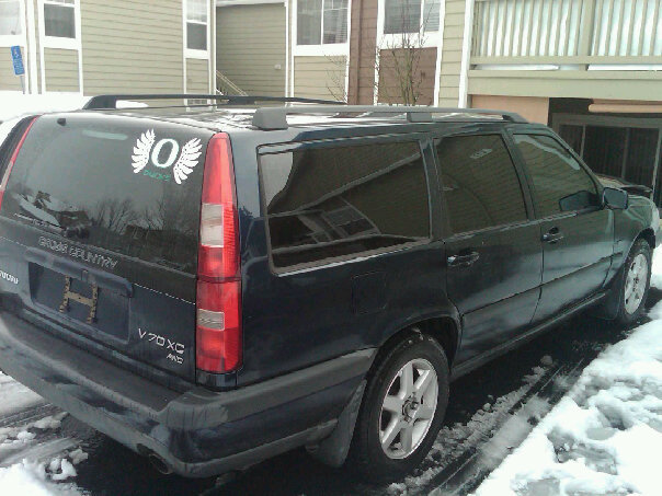

okay guys i am a Newbie... I have a 98 V70XC just turned over 118k the stock turbo from what i have found is only a little 13T what I would like to find out from all you experienced and very informed guys is. can i unbolt this little bundle of sadness and bolt in one out of a V70R?
i found a couple used ones for only $150 U.S i figured this should give me more power with out having to go get a ecu swap. and other more expensive items for the time being that is.. any and all tips and info will be welcomed with open ears! thanks
