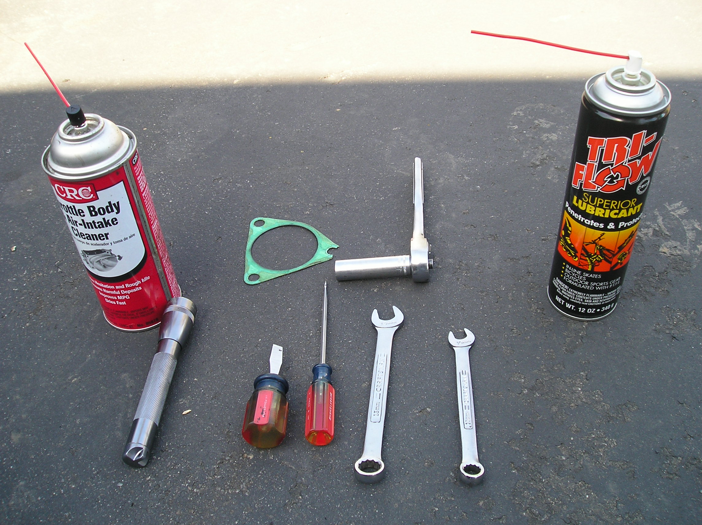

First you'll need to go to the Volvo dealer and pick up a paper throttle body gasket. They charged me $7.56 for this. Can you believe it?
Be sure to use throttle body cleaner, not carburetor cleaner. The brand I used was CRC. Here's what you do:

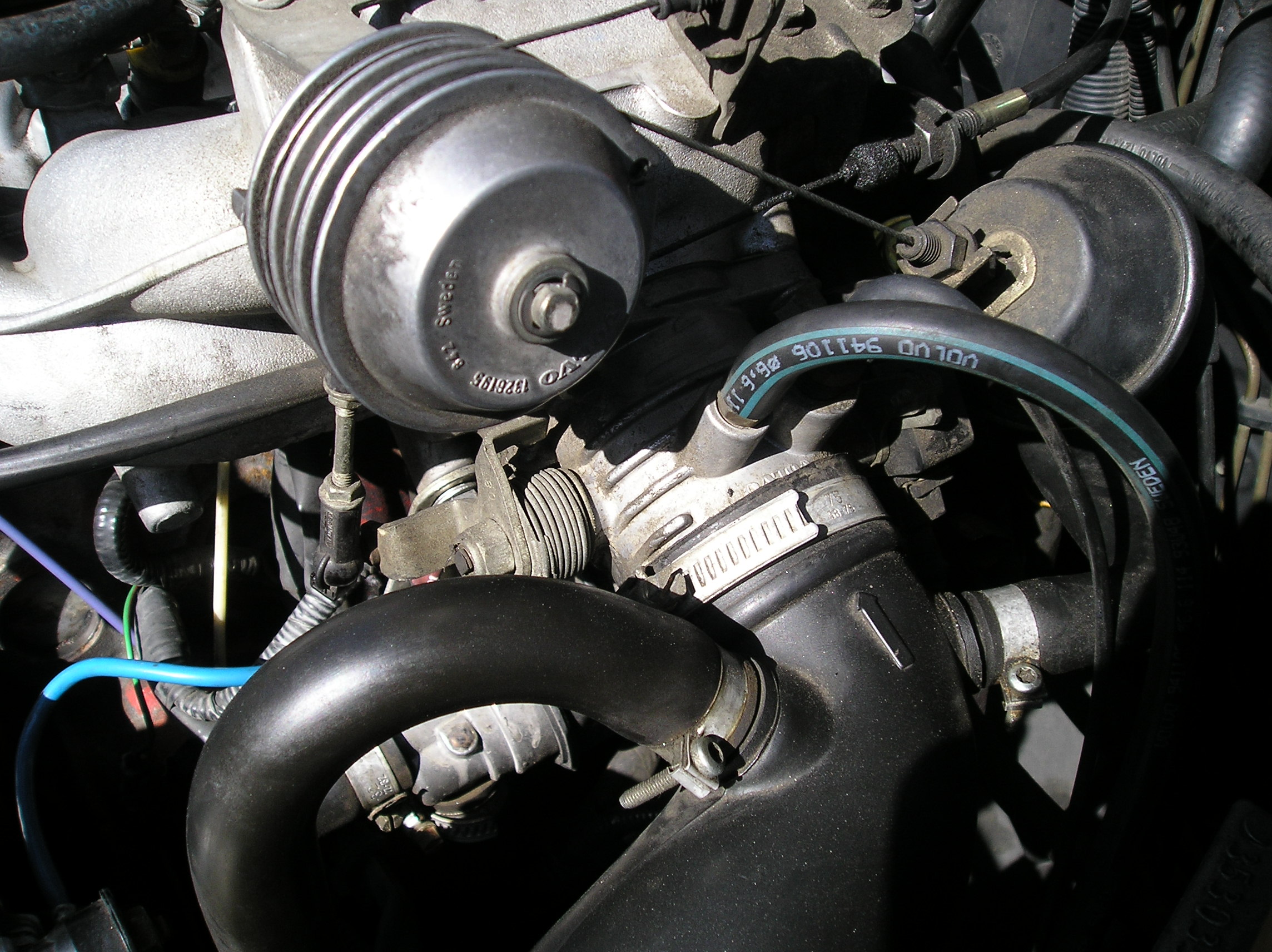

2. Squeeze the bailing clip on the throttle position sensor lead and disconnect it.
3. Pull off the two vacuum lines from their brass fittings.
4. Use a small flat screwdriver to unclip the lower throttle linkage from the throttle body. Basically, you snap open the clip, and then gently pull the fitting off the ball joint.
5. Now remove the accordion air intake hose, using a large flat screwdriver to loosen the retaining clip.
6. Finally, remove the three attaching nuts. Careful not to drop them!

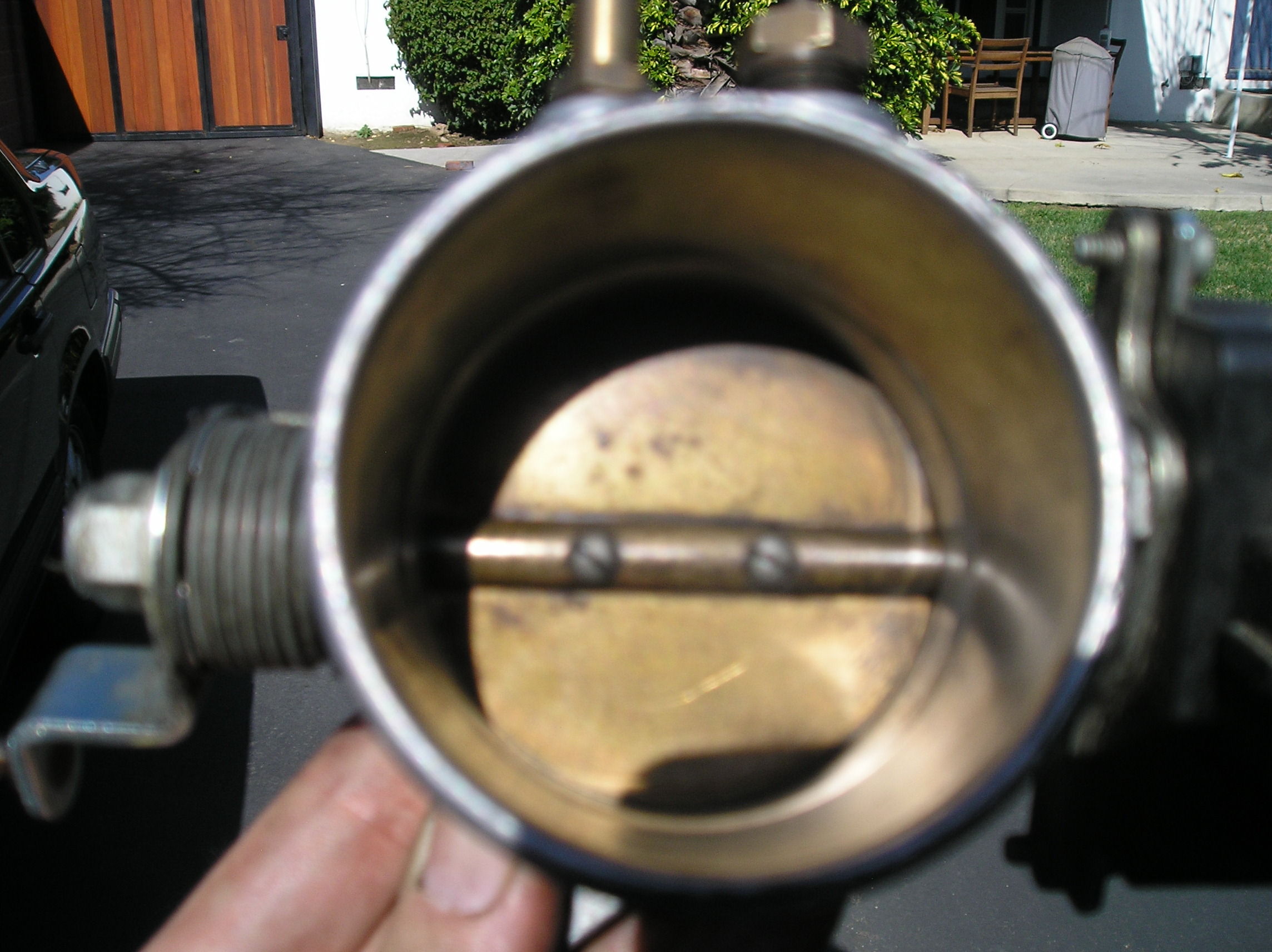

8. Use the throttle body cleaner and a toothbrush to clean the entire throat of the throttle body. Clean especially the vacuum fittings (one of mine was clogged, so I had to wrench off one of the brass fittings to clean properly). Cleaning the throttle body was easy, if tedious and quite messy. I used safety glasses as the cleaner shoots out rather violently in all directions. Try to keep the cleaner off of the black plastic throttle body position sensor.
